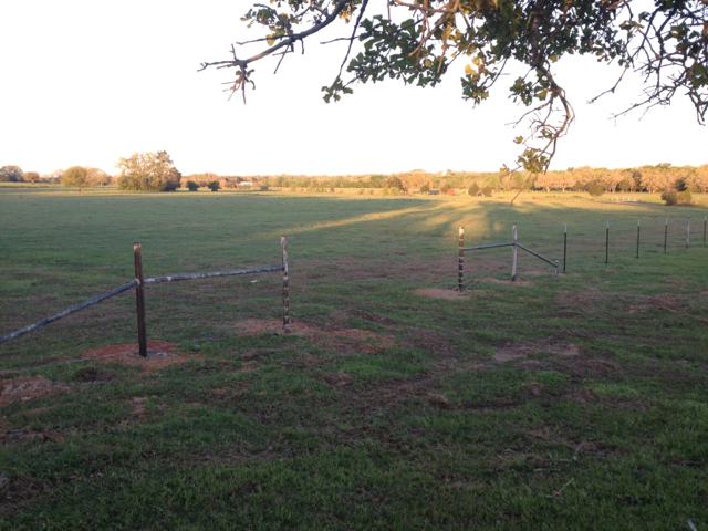

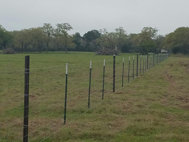

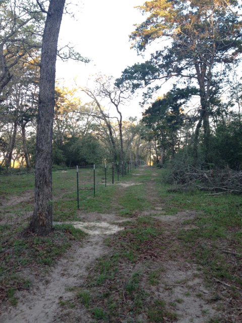

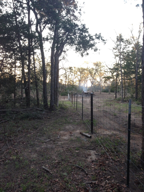

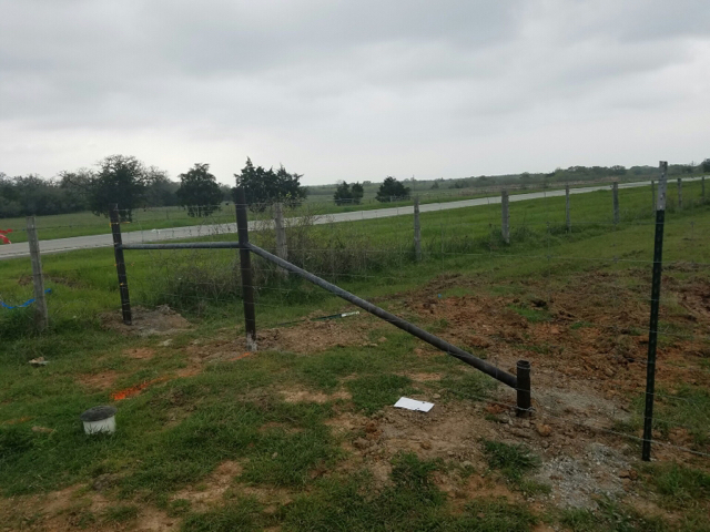

Been quite busy lately. Times are tough in the oil patch but we are limping along with layoffs and such. The weather has been beautiful lately in central Texas - mid sixties and seventies with occasional showers.
We have one side of the fence done, which was 1800'. My neighbor and I split the cost, ended up using 2-7/8" drill pipe for posts and tight lock wire with barbed on top and bottom. I wanted 4" square spacing but we agreed on 6". Hopefully the future goats keep their heads out.
Also been busy clearing the fence lines, doing some light dirt work and mowing. The youpon trees are killer... I'm trying a round up and diesel mix to see what works.
The well is going will be started in a week or so! I'll be doing soil tests soon as well. Slow progress is progress! To the pics...

Good corners, nice looking fence.

What about keeping coyotes out? For me, that's what I'm thinking about the most when planning my fence

I'm sure they could dig under if they really wanted to ... I haven't heard them around yet, but they might be out there. There is a strand on the bottom. I'm more worried about the feral hogs than the coyotes. A mule will do wonders to keep the coyotes out.
