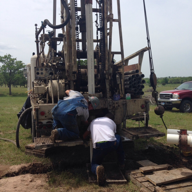

After months of waiting, our well is finally being drilled this week. They drilled to 400' using a rig older than me! According to well report, there was 4-5' of sandy loam, 40' of clay, then another 350' of lovely, sandy water bearing formations. Upon first test the well made 25 GPM, they were going to inject some chemicals to try and bump upwards of 30. Since I will be using mostly for irrigation, we are installing a 3 HP pump system. I might eventually use the pond as well. Next up will be pump house then electrical.

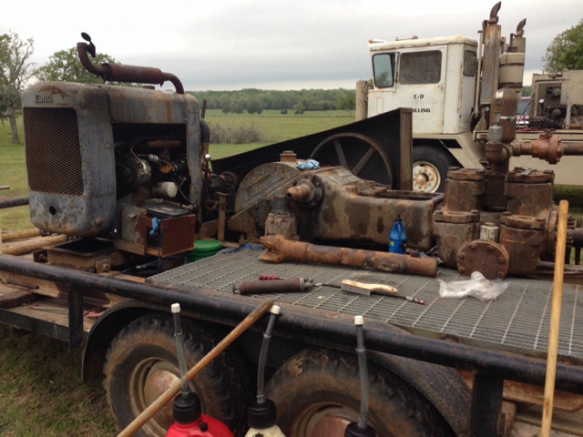

Speaking of cool... They were using a 1948 Ford Jubilee tractor motor to run the mud pump. Pretty neat.

Very nice to see old equipment like that in professional service !

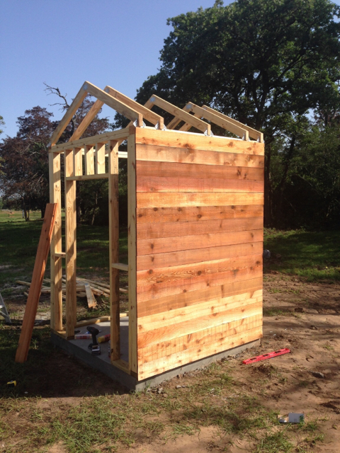

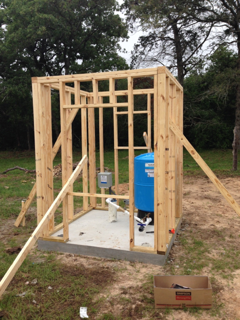

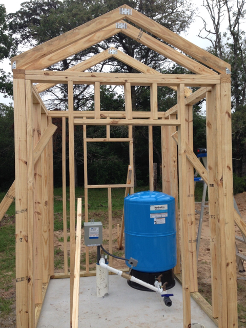

Slow progress again, but we keep creeping forward. The rain has kept us away for a few weeks, and promise I will get to some of the advice above in due time. The pump and equipment are on the slab, and I spent a few days building the pump and tool shed. This property is a couple hours from us, so I needed somewhere to store equipment.
The walls of shed ended up being 7' and shed is 6x6' so plenty of room for irrigation controller and manifold. I still need to finish the roof ridge, trim and some insulation. A family friend owns HVAC company so he's going to wire up a breaker box, and a temp controlled infrared light to keep my equip warm in the winter. Not as if we get THAT cold in TX. Getting warm now...
