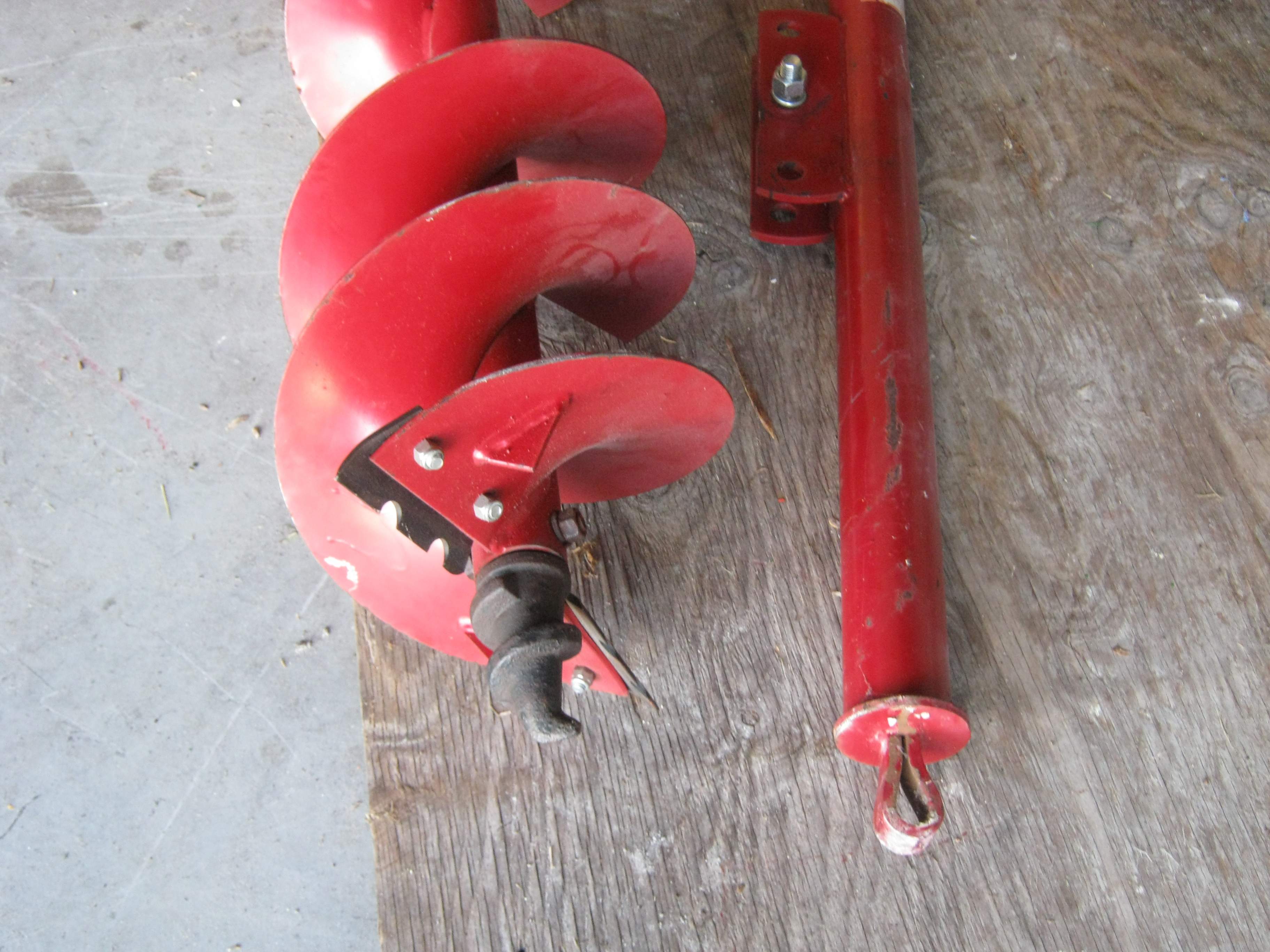

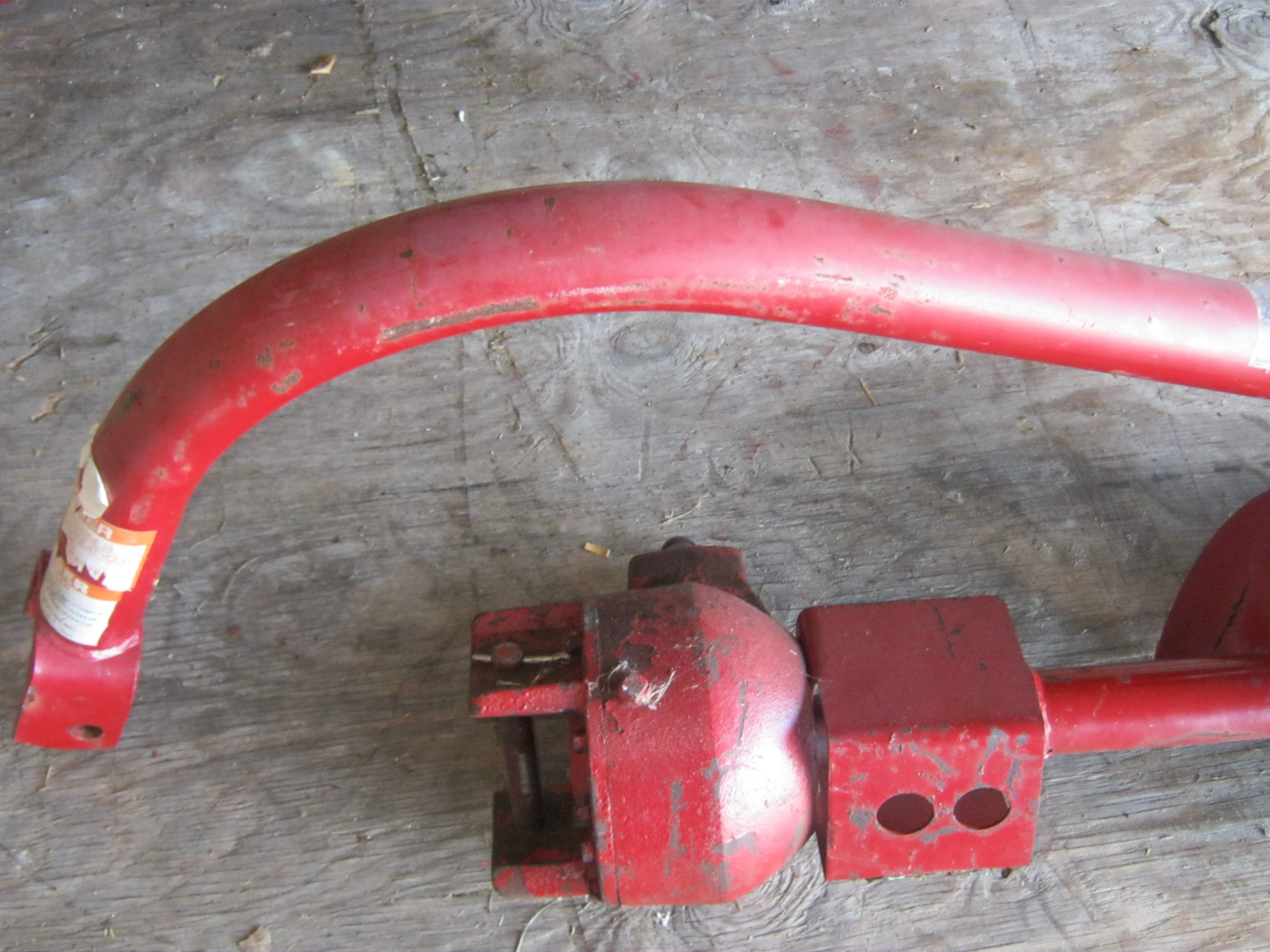

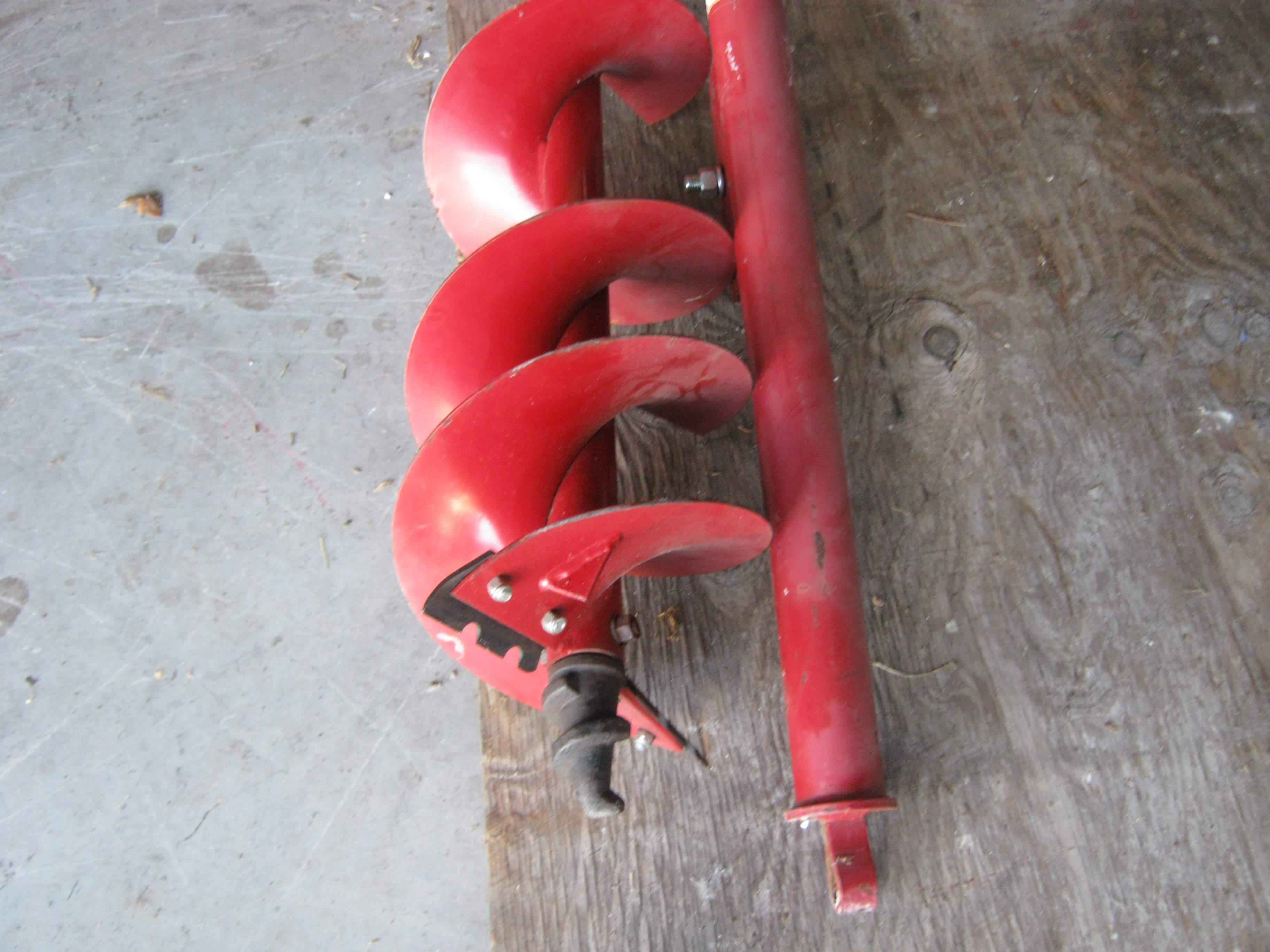

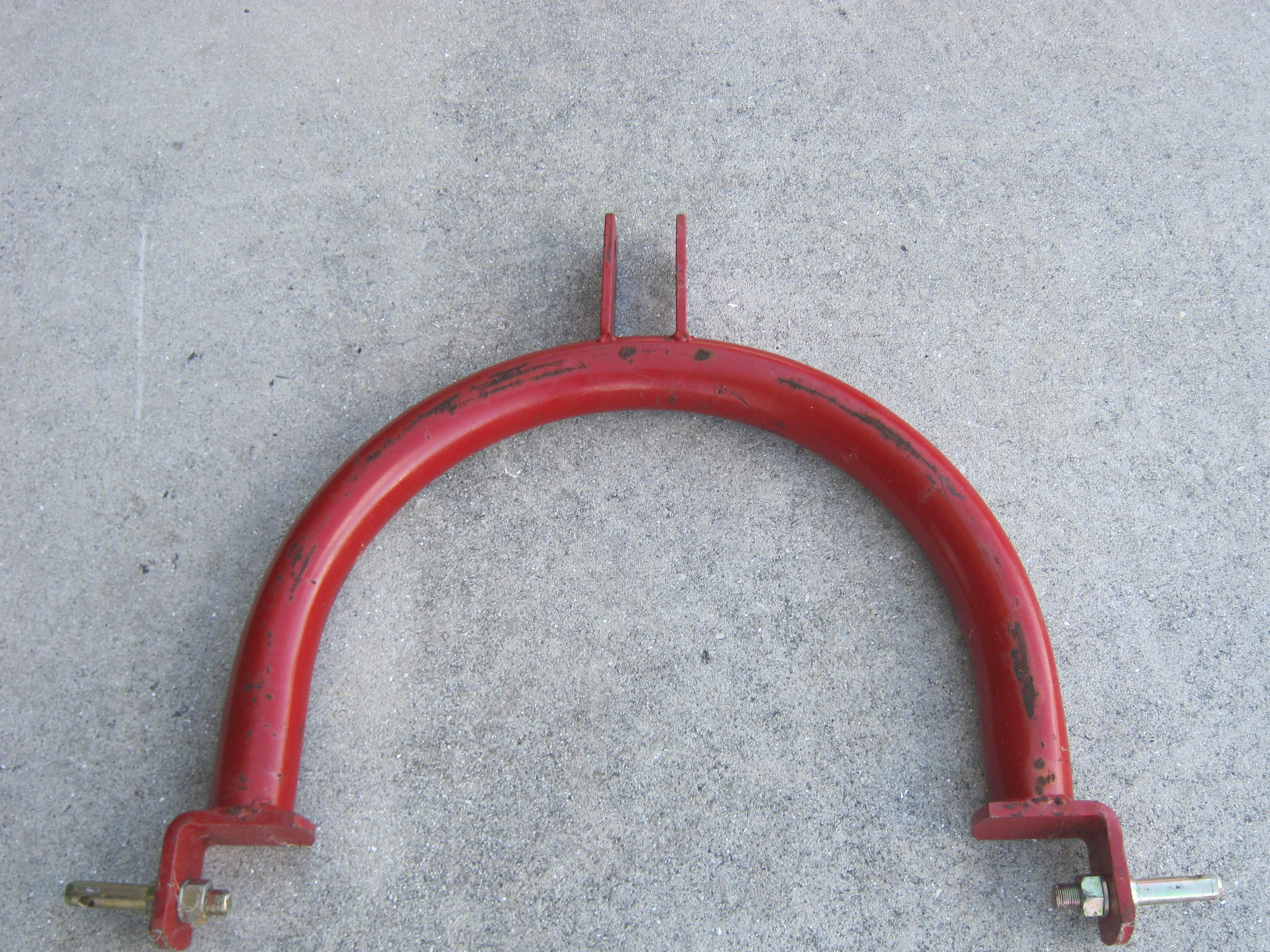

Builder, greetings again
I know your going to post your pic's,but in meantime here are pic's of mine.INT'NL(not same as tractor builders)World Agritech Corp.
Note hole(loop) type hook up for top center link.Don't know gear ratio,as Mtn View Ranch stated 4 to 1 or possible 3.18 to 1.:confused2:,but mine did come with#5 shear bolt.My auger is 12",check out bottom of it if pic's let you see it has welded triangle pieces on it.
Boone

/ Central Tractor post hole auger?
My mounting frame looks almost identical, but my gear box doesn't have the sheetmetal guard with the two holes in it mounted underneath the gearbox.
I'll try to get pics. Just too busy to believe right now. :confused2:
