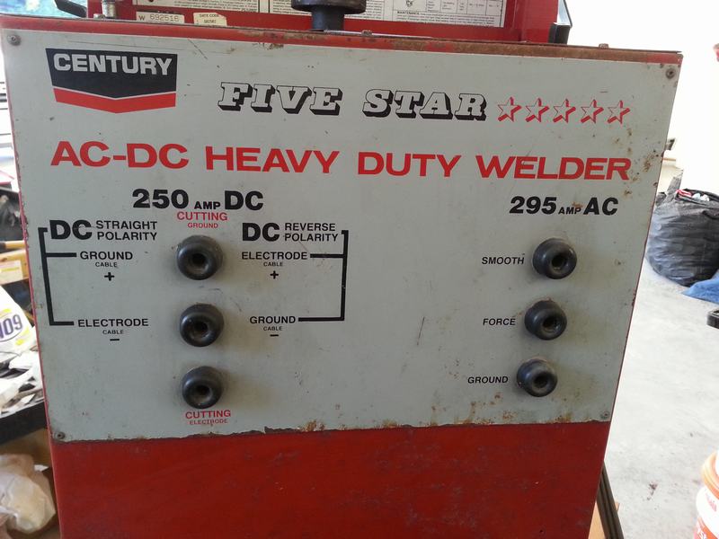

Thanks for the info it is nice to learn a little about how welders actually work. I was specifically asking about the different spots to plug in the leads on the front of the machine. On the front of the machine you have dc straight and reverse, then you have ac force, smooth, and ground. What would ac force be? I am fairly experienced at welding however I am self tought and know nothing about the terminology. I have a tig rig ready to be hooked up and was hoping to at least be able to weld aluminum tig with this machine. If I can not then I will look into mig machines which I could weld aluminum with. I have cleaned the machine up and struck an arc with 3/32 7018 and it welds pretty good on dc.
Force has a higher open circuit voltage than smooth. This allows you to hold a tighter arc and get deeper penetration with less chance of sticking the rod.
This is a stick welder high frequency is not built in. You need a separate high frequency box to get high frequency.

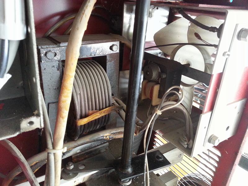

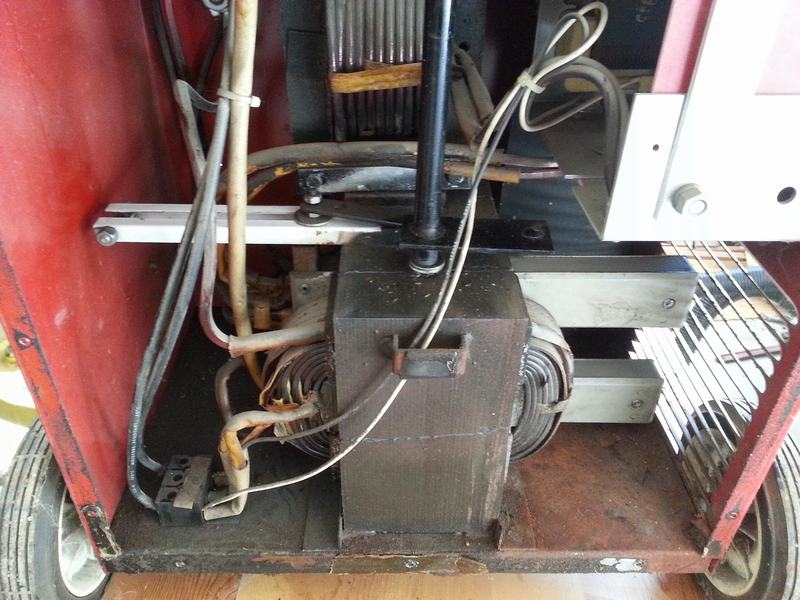

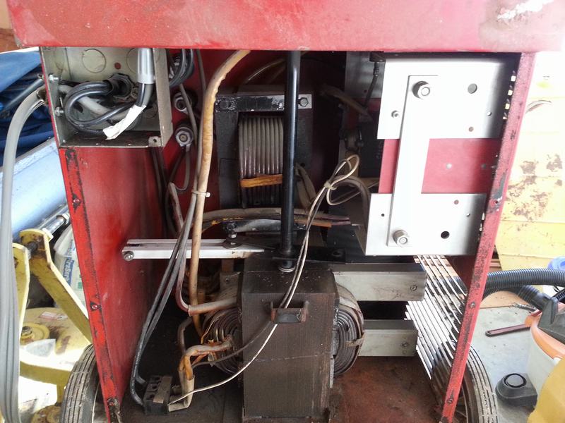

I found a good Craigslist buy and picked up my first welder, a Century 5 Star AC/DC 295/250 Amp. When I tried to research this model, information was a bit sparse so I thought I'd post some photos in case anyone else runs into one of these.
It's a bit rusty here and there but the previous owner assured me that it worked. So far I know that the fan runs and there was no magic blue smoke or unusual noises when it was fired up. :thumbsup: That, and some cleaning, is as far as I've gotten. I took the back off to clean and took some photos of the 'guts'.
View attachment 339503 View attachment 339504 View attachment 339506 View attachment 339507 View attachment 339508 View attachment 339514

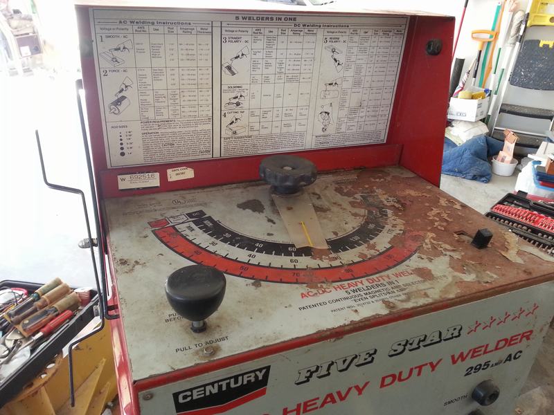

The amperage adjustment is made by lifting the knob on the top and turning the knob. Pushing the knob back down locks the setting.
It came with a pair of 15 foot leads so once I've made an extension cord and found some scrap steel to practice on, I can give it a try. It came with a few 7018 rods and some rods that I can burn up to play with.
If anyone has any information on this model, I'd appreciate it. It's model 110-178 and has a date code of 082581 which I would read as August 25, 1981? If so, it's about the same age as my Yanmar 1510D :) I've had a look around for a user's manual but Lincoln doesn't seem to have one for this welder.
