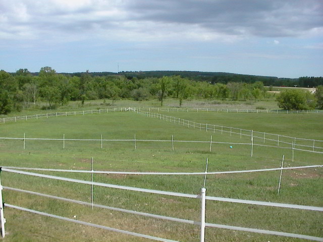

Recently I received kinda, maybe, almost approval to upgrade my old tractor to a new CUT. I have been spending a lot of time reading posts on TBN. Excellent insight into the various CUT tractors! My wife has horses so I spend most of my tractor time working six acres of fenced pastures and maintaining the riding arena. Also have some woods and wetlands. Currently planting grass around the house. My terrain is quite hilly. Now for the question. How does the LandTrac 360 DTC stack up against the Century 3035. I sat on the 360 today (dealer @ 20 miles), will be looking at a 3035 in 2 weeks (dealer @ 90 miles). I have reviewed the spec's and realize the 360 gives up about 700 lbs. but the 360 has four cylinders. I will buy with FEL (5140 vs. c50) and have a feeling that the c50 is beefier and easiler to take off. 360 dealer said he could mount the joystick on the fender similar to the Century. Looking for info on parts, durability (I live in rock country), layout, comfort in the saddle, etc. Thanks
