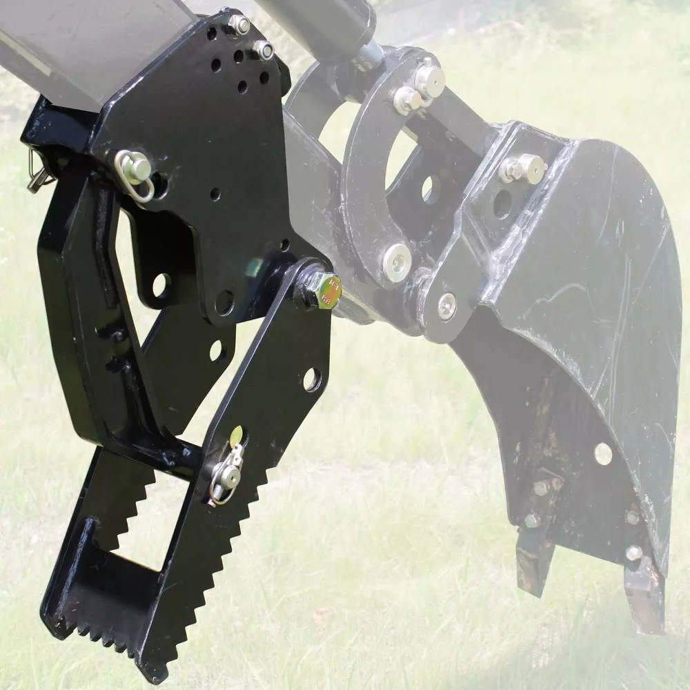

Please excuse this dumb question - what is a thumb? I would love to get a backhoe - would you recommend getting that when I make the initial purchase if I decide to purchase new?
Loader controls are often referred to as "lift" and "curl", the first being the hydraulic cylinders that lift the loader arms, and the latter being the hydraulic cylinders that dump or roll the bucket fore/aft. When directing an operator at the controls, we typically use the wrist to show curl, and movement from the elbow or shoulder to show lift.
But those picking up logs or brush piles often want some way to "grip", and because gripping with the hand is the easy way to demonstrate this when directing an operator, the implements used to grip items are usually called a "thumb".
In most cases, you'll find these on excavators and backhoes, but also found on pallet forks (often called "grapple" in that case):
They're super-useful on larger CUT's, but I'd honestly not put one on a subcompact or even a Series-2 JD. They add weight, which will reduce your loader lift capacity, and are targeted for picking up mostly heavier items. Grapples and thumbs are very useful, but I'd argue more so on larger machines than what you're probably shopping.
