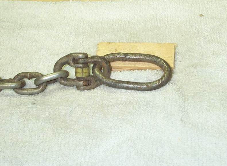

<font color="blue"> Nearest level ground for tractor is 30-40 feet away in this example </font>
Well that's not too much chain to have around. Several smaller lengths for what-ever can quickly make a long chain with quick links.
I'm not sure what the device in the attachment was originally intended for but it sure makes a nice choker for exactly what your're doing. I wrap the chain around base of Huckleberry stands and feed it through the ring. I get it as tight as I can by hand then hook it to the tractor. It gets a good bite on the brush and only occasionally slides up over the plant. Sometimes I add a 2' 6x6 near the plant to provide a little upward leverage as I tug.
