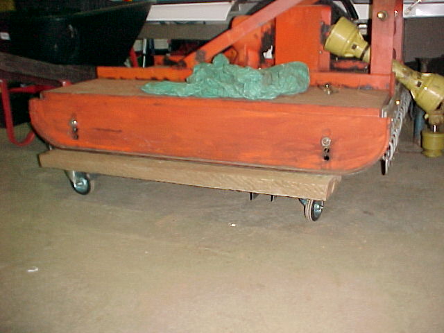

Tony
Some close ups attached. You can see where the silly *()^&&*%$(^% left wide gaps which they then had to infill. I decided to leave the front alone.

Hi all. This is my first post here, but I've been reading for awhile now.
I picked up a 5' KK brush hog yesterday, and like most didn't want to fork over $300 for chain guards. So my wife and I built some today. The rear's finished, tomorrow we start on the front. Total cost is about $100, mainly 85' of chain, about 12 lbs of bolts/nuts/washers to hold it on, and 2 pieces of pre-punched angle iron (hopefully it will hold up). I'll attach a couple of pictures.. Just bolted the angle iron on to the bottom side of the deck, sticking upwards, and bolted on lengths of chain to that. Only took about an hour to make the rear one.
Hope it's helpful or inspirational.. They aren't pretty, but neither is the brush hog. :)

/ Chain Guards #39
Thats the best paint job I've seen on a KK implement yet. Maybe KK's paint department is finally getting their act together.
By the way great job on the chain guard. Enjoy your new toy, I mean tool.
/ Chain Guards #40
David...
A very nice job... /w3tcompact/icons/smile.gif
The only potential problem I can see is down the road with all the inherent vibration from the rotary cutter... all those fasteners/nuts and bolts will become a nightmare to keep constantly tightened... /w3tcompact/icons/shocked.gif
...otherwise... you'll be losing chain pieces here and there... maybe you can try using a metal rod and loop through all the top links... and secure into slots or every ~say 5 links bolt it to keep your spacing for your chain curtain...
