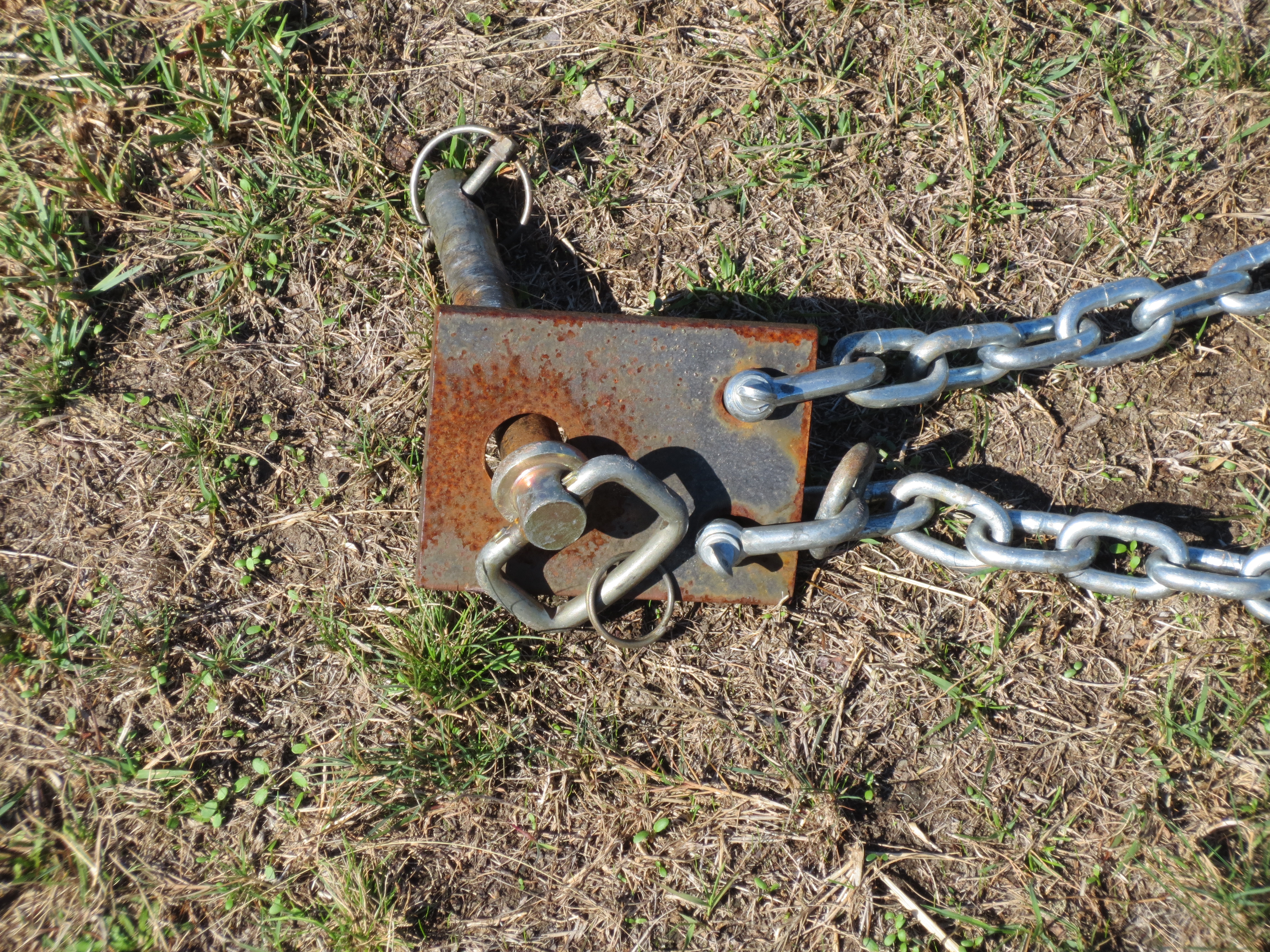

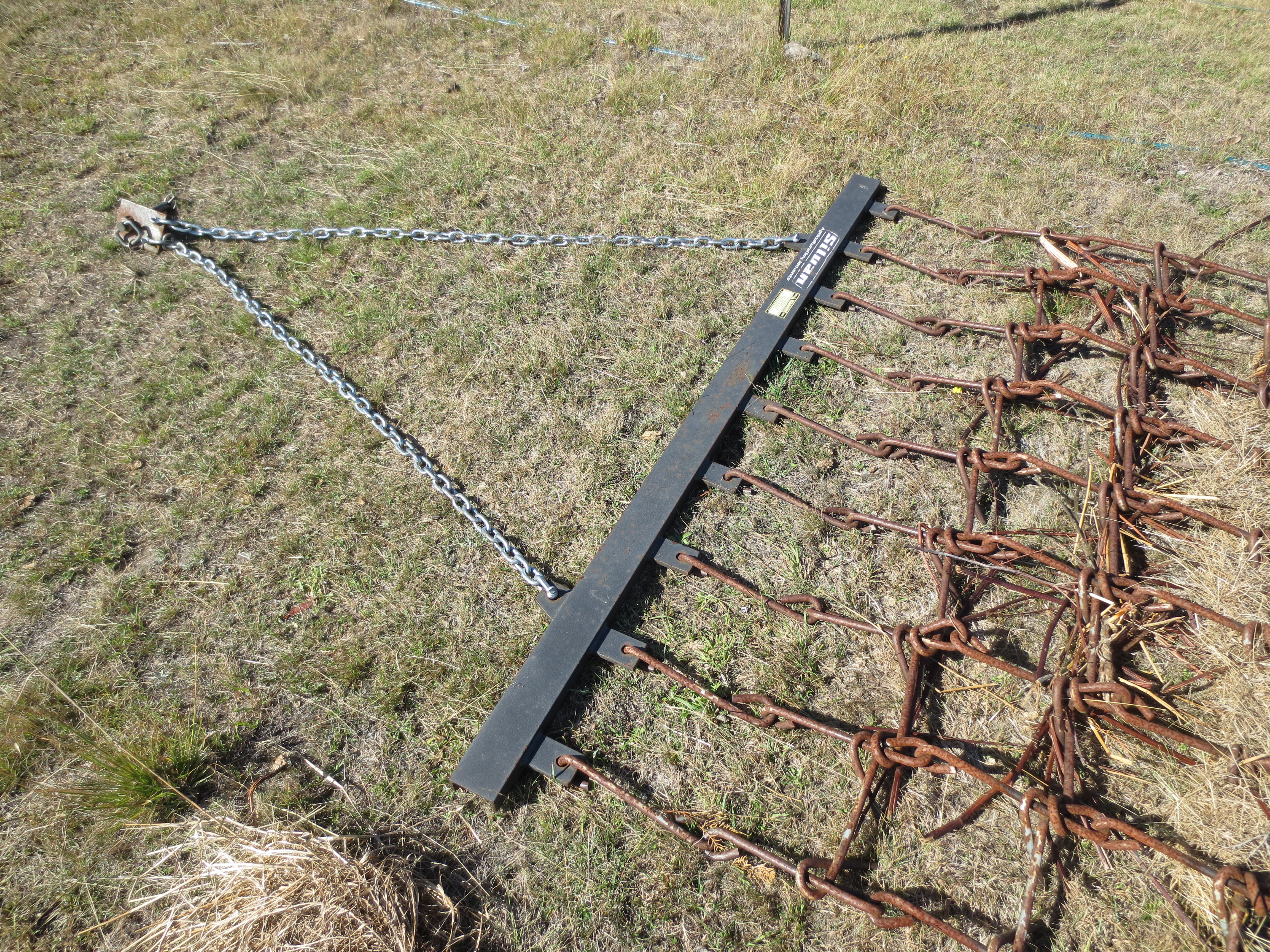

Without a picture of your chain harrow I'll have to guess using my own as an example. (I'm charging up the battery on my camera & will take some photos later)
Seeing as it's the first time for you using it, I suspect that the chains haven't had time to straighten themselves out. There are twists that, even though they look straight to you, aren't. It's these twists that are forcing the leading hooks to pop out of the bar. It's an embuggerance but you'll have to drag it a while, stop & un-twist, and repeat until the entire length of each chain orients to being straight. My chain harrow has two 'hook on' sections so sometimes this takes a number of times to get it right. If you ever have to transport the chain harrow to another place (roll it up/dismantle the sections) you're going to have to go through the same process again... it's the nature of the beast. :)
My pull chains go to a rectangular steel plate and are shackled to the corners. The plate is then attached to my draw-bar via a secured drop pin. Having your chain loosely over or around a ball will mean that the whole rig will pop off or drag at weird angles.
I'd suggest removing the ball from the draw-bar and transferring it to the 3PH... there are many examples, here on TBN, of 3PH towing ball configurations.

Right, piccy time:
I also measured the plate = 5.5"x4"x0.5" , it's a fairly hefty piece of steel and will hurt if you don't keep your fingers out of the way! :laughing:

The pulling chains need to secure to a single fixed point, like wag tails setup.

Yep, I agree with the recommendations already given you. Secure your towing chains so that it doesn't slide along the hitch ball which will solve your other problem. Do not bend the hooks on the chain harrows closed.
The harrows chain harrows can be set in three positions. Pulling one direction will be more aggressive, pulling in the opposite direction will be less aggressive but still scratch up the soil. You will hare to hook the bare on the opposite end of the harrows to change the towing direction. And like gsganzer stated, flip them over with the tines in the air will smooth the soil surface. I use it like that to cover seed which I sow with a broadcast seeder.
If you want to leave your ball mounted to your hitch, attach the tow chains for the harrows to a ring large enough to fit over the ball. Such a ring can be found in most Ag. stores. That's the set up I use.

Wagtail...Your harrow is made much better than models available here. The tabs welded to your pull bar are well designed and would solve some of the problems on things made here. Our models are flimsy in that area and when you turn even a little too sharp, slack develops and can pop the hook out. The drag weights you have would also help our models.
How do you deal with the bunched grass accumulated?
The bunched grass is a result of dead summer grass that the horses didn't graze... seeing as I use the harrow to spread their droppings, the grass actually assists in the 'break-up'. I'm simply letting the accumulation work its way out on its own.

Truth be told, all I did was ring up my JD Salesman and asked him to include a drag harrow when he delivered the rest of my implements for the 4105. :laughing: (the tractor came with a regular bucket [to be replaced by a 4in1] and the slasher) This all happened four years ago.
Now, the Salesman (Jamie) is a farmer himself and seemed to know what he was on about... plus the dealership sold 'Fieldquip' and 'Silvan/Selecta' implements. So he called up 'Silvan' and ordered me this type... and I've not seen another like it since!
I even Googled the 'Silvan/Selecta' catalogue and they don't carry drag-harrows anymore. :confused3: I must be a very lucky boy. :rolleyes:
