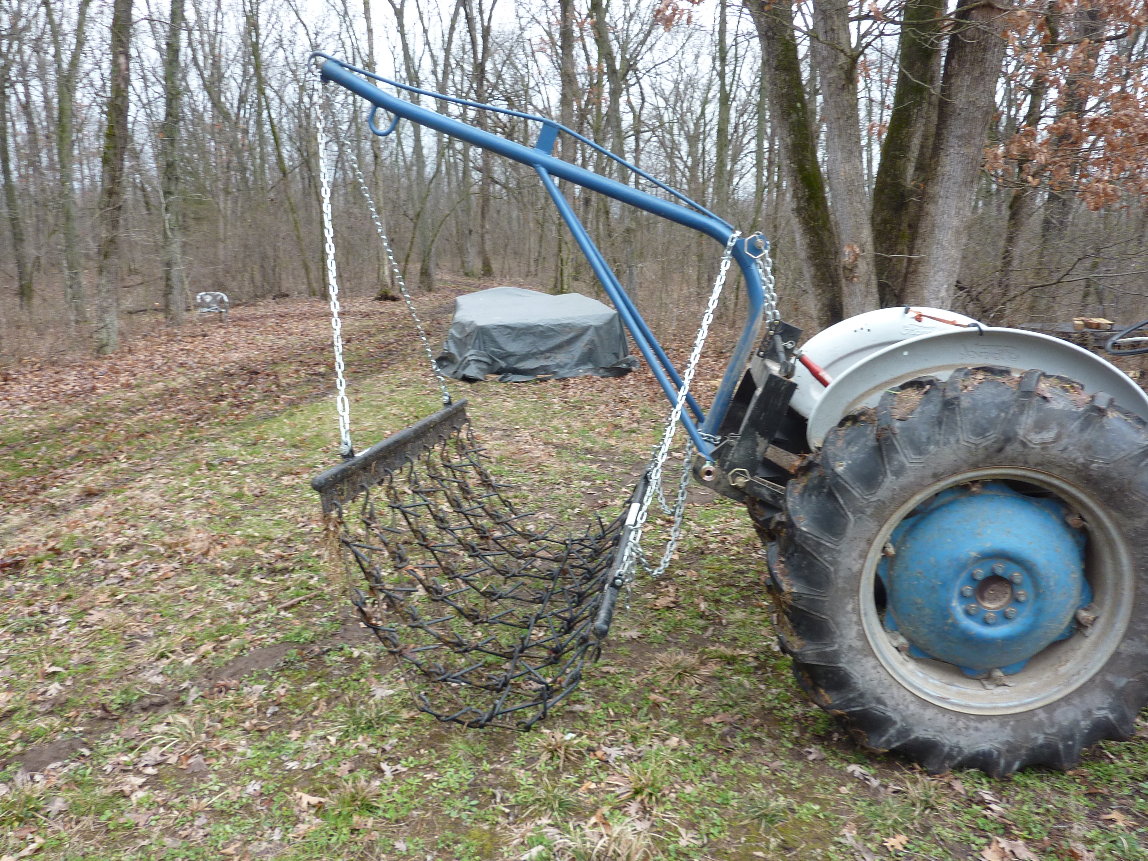

Original poster here, anchoring the pull chain so it was fixed and could not slide around the hitch ball solved the problem. The ground is too wet to till right now so I had some time for innovation, I have a boom pole that was not being used so I unhooked the chain harrow and hooked up the boom pole and added lift chains and reconnected the pull chain so I could lift for transport and when at end of a drag row. Adjusting the length of the front and rear lift chains is critical because the front must lift up first when lifting from the ground and the rear must go down before the rear when letting down- if not he harrow will try to fold up as opposed to going down flatView attachment 503810.

I am about to buy a chain harrow, and make a lift out of my boom pole as shown by OP "Oldstuff" above (and I thought mine was an original idea).
I would really like to get a 6' x 8' harrow, but note that the rig shown uses a 6' x 5' harrow.
I assume that if I were to choose an 8' harrow, I would need to fabricate some sort of extension for my boom pole.

fried1765 I got the bar and chain harrow at Chain Harrows However, I got them last November and today do not see the 6 by 5 listed but the bars are still listed. The tines are 4 inches long as I remember. Also, yes you would need to extend the boom pole as mine is just barely long enough for the 6 by 5.

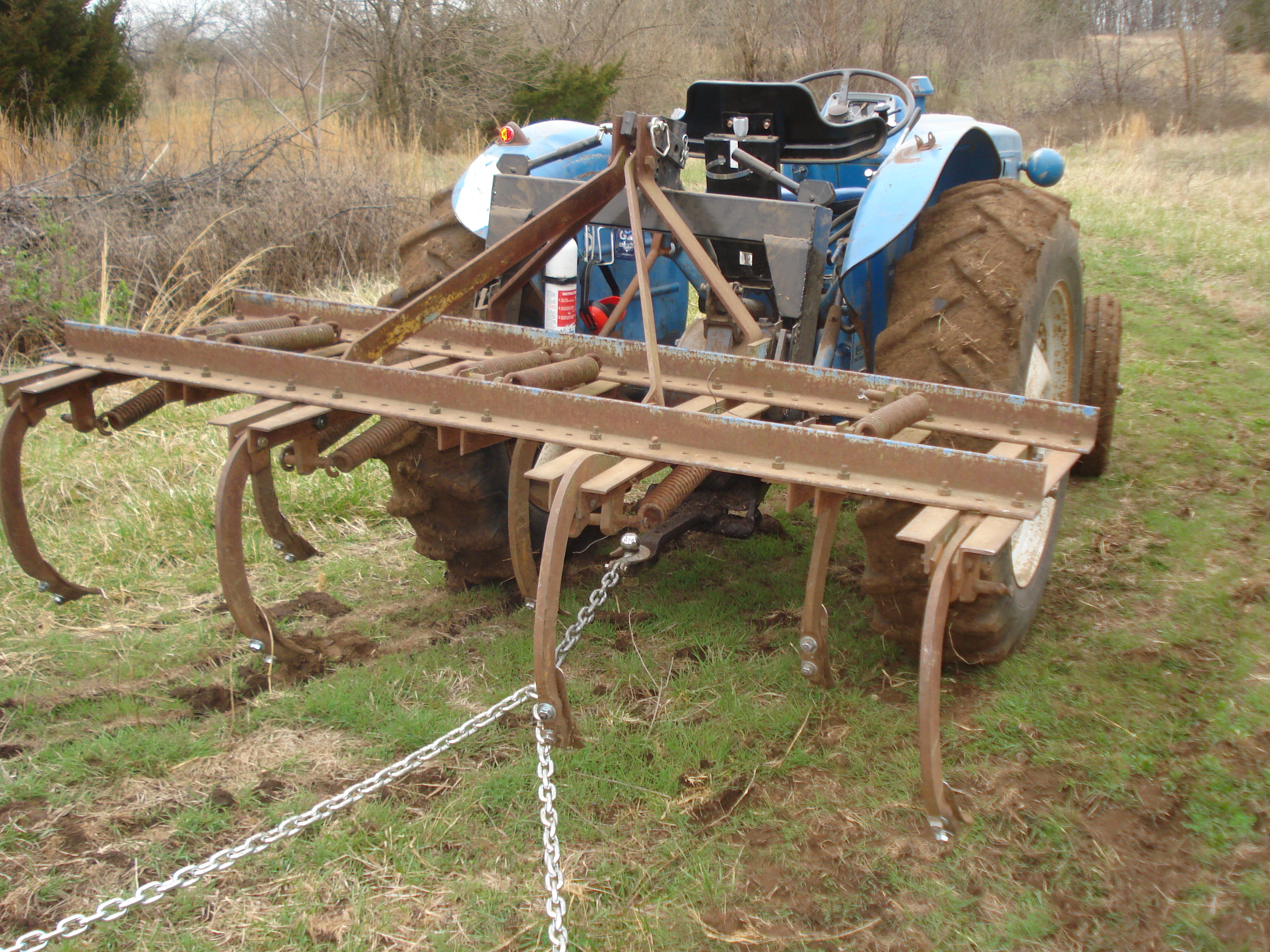

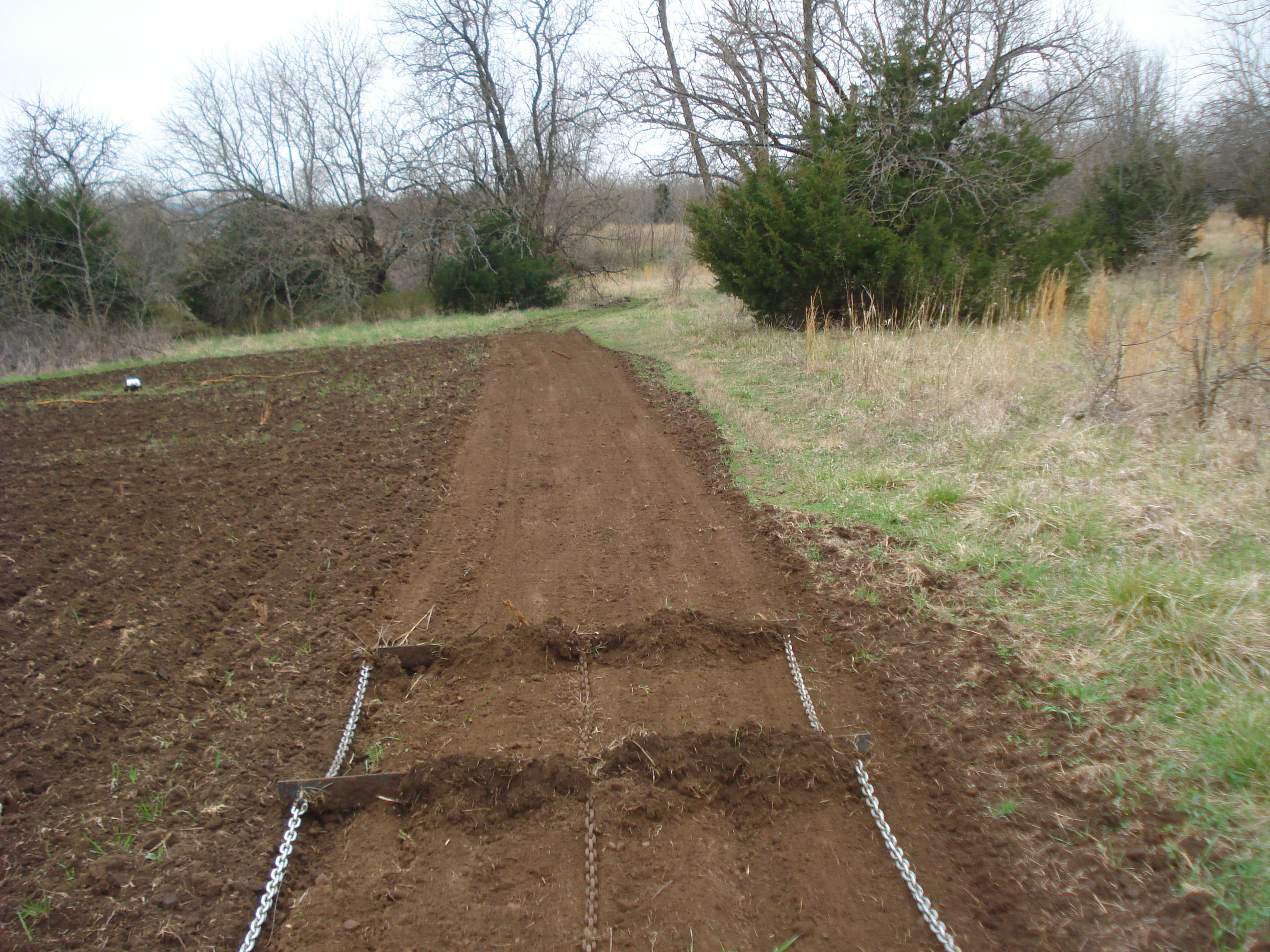

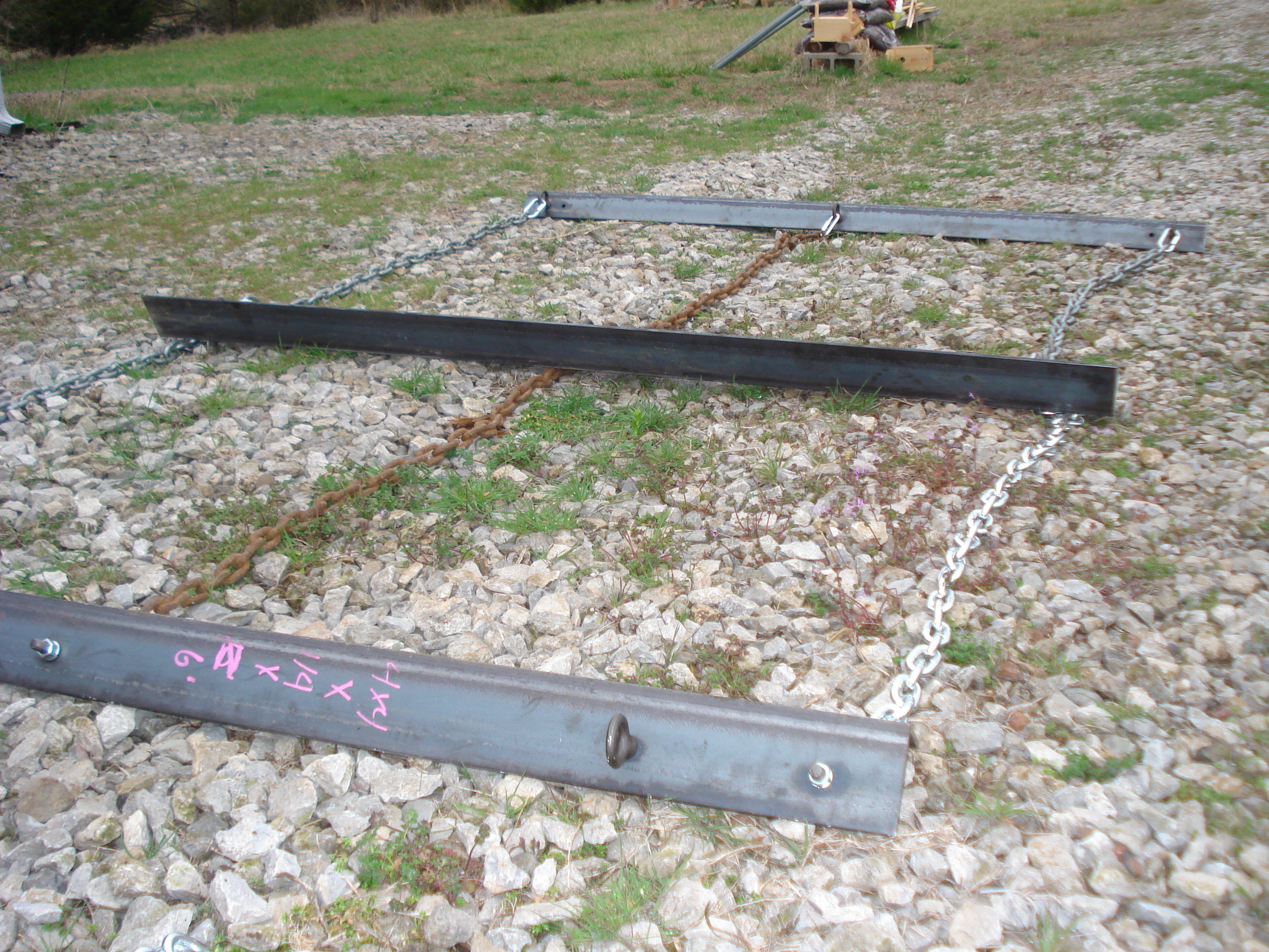

I made this the other day, copying another's idea, and it worked pretty well smoothing out soil that had been run over with a field cultivator. Cost about $150 to build buying everything at retail. Less Surface Trash.jpgSet up.jpgConnection.jpg

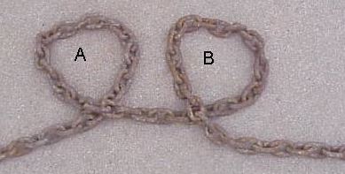

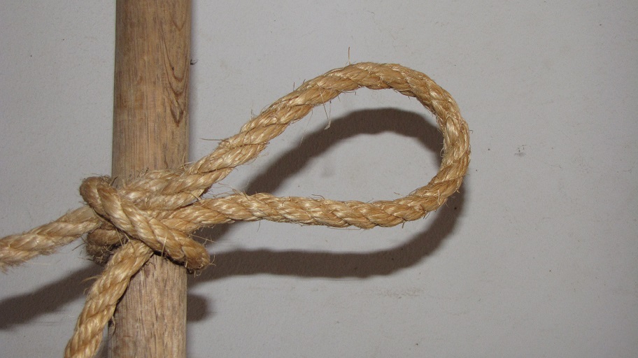

By throwing 2 counter clockwise loops in the chain and putting loop A on top of loop B you have succeeded in forming a clove hitch knot. Drop these assembled loops over the ball hitch and there will be no slip. Depending on where this knot is located in the chain, the harrow angle can be adjusted from being pulled square to any angle on the bias desired.
When chain binding front or rear of a tractor for transport, this same knot works on front or rear for a no slip connection. Need to pull a piece of pipe or log and don't have a slip hook handy, use the clove hitch. Want it a little easier to un-tie on certain applications with only one section of the chain needed for pulling, the improved clove hitch un-ties like your boot lace.
That will work right well. Easy and fast. :thumbsup::thumbsup::thumbsup:

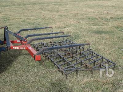

Picture of harrows on three point made by Farm King.

That is a great looking harrow and one you can pick up to clear the grass. Wish we had those down here. Any idea on the price?

Can't answere on price but a small one was affordable some years back. They should be exported south. The lift would also be easy to make. Diamond harrow sections should be readily available.

I thought so too....$1000 or a little more new.
