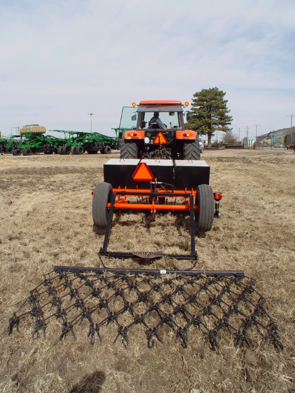

Here's what I've been using behind a diesel Ranger UTV.
It makes quick work of a very necessary job.
I've only got 7 ac. A larger one isn't necessary for me.
8' Wingfield Maxi Drawbar Harrow
Weight: 292.00 lbs
Comes standard with: front harrow section, rear harrow section with rear hooks, schedule 80 pipe drawbar.
Wow, the price has gone up almost $300 in two years.
Wingfield Flexible Chain Harrows
