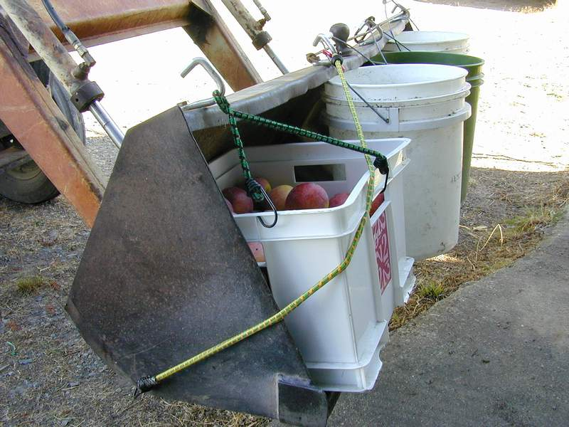

Yeah. See my post #70 above. While these hooks don't have the strength of welded-on hooks, I don't have the lifting capacity to bend them so they are strong enough for my use. And they are easier to use for rope, straps, or even to hook branches into them when I'm removing a downed orchard tree. My small chainsaw lives in a plastic 5 gallon bucket. It's easy to hook the bucket handle over the loops.
Photo: When my wife said she picked special apples way down in the back of the orchard but she wanted me to go carry them back ... no problem!
(Yes this US-version Yanmar is all beat up looking. It looked like this when I bought it in 2003. Still runs like new. I wish prior owners had treated it with the respect it deserves).
