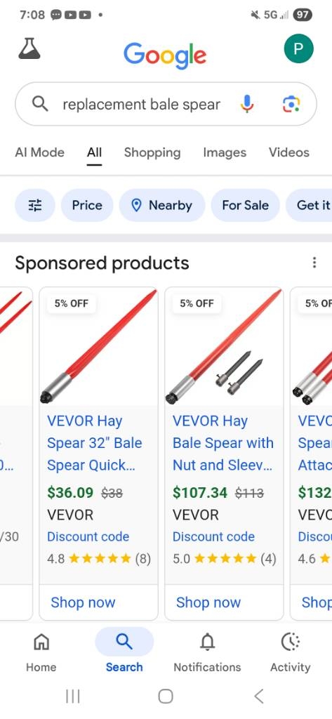

About the bale spears... Are they really stiff enough to resist bending with sever use.... Kind of wonder about them but the cost of spears (5) and the sockets sort has me wondering if the investment and quality of spears is worth it.... Dont know enough about bale spears to adopt them over replacing my square steel tube..
They're quite tough. Here's the build thread from 2020:

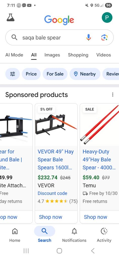

Another point on bale spears is that they are cheap, compared to a fork. My hesitation, would be they arent designed to make that whole round bale load, at the tip, they are meant to stab in, and take loaf over the whole spear. So, if you're the type that would use the tip to lift, you likely will bend/break something. However, if you look at this complete Vevor SSQA bale spears, and its price, that looks like a great starting place for a build of debris forks

I have been curious, but not enough to actually order them. Let us know what you think when they come in.
They arrived in a box labeled Garvee even though they were listed as "Unbranded" on eBay. Haven't used them yet but I did unpack and try the fit. My first impression is they are quite sturdy, well built with good welds. The fit and finish is good. They do fit my bucket with the Piranha tooth bar on. They would sit a bit closer to the bucket and make full contact with the cutting edge if I removed it. For my intended use it's probably not necessary to take it off. I could see a guy bending them but you'd have to get real aggressive or use them for something outside of their intended use like digging up stumps. Overall quite pleased especially at the price I paid.
