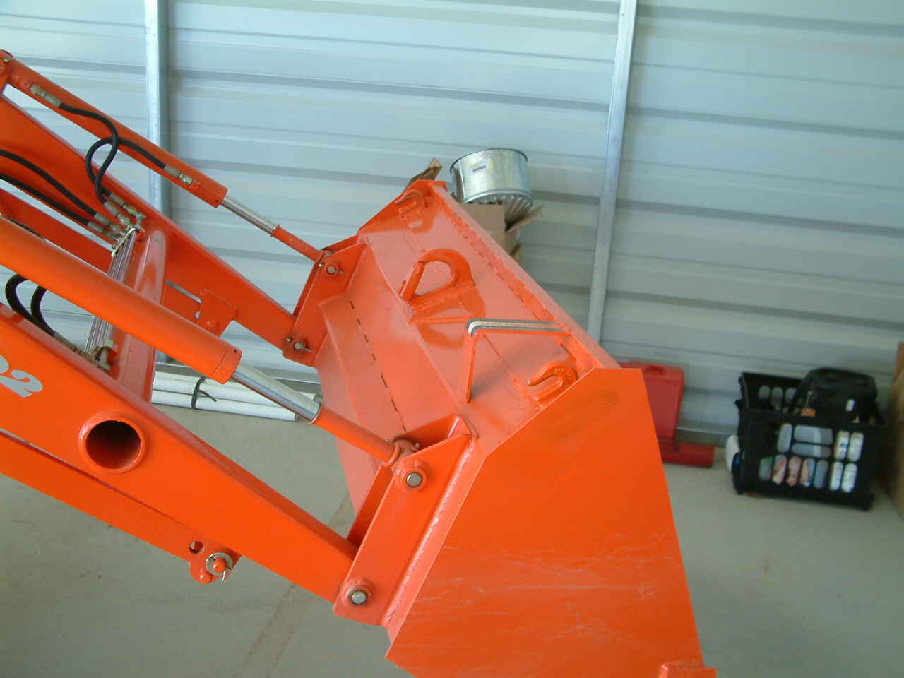

Here's how the dealer welded chain hooks onto my LA302 bucket. Note the skip welds on the stiffening bar. The bucket looks fine to me. No out-of-shape problems due to the welding.
