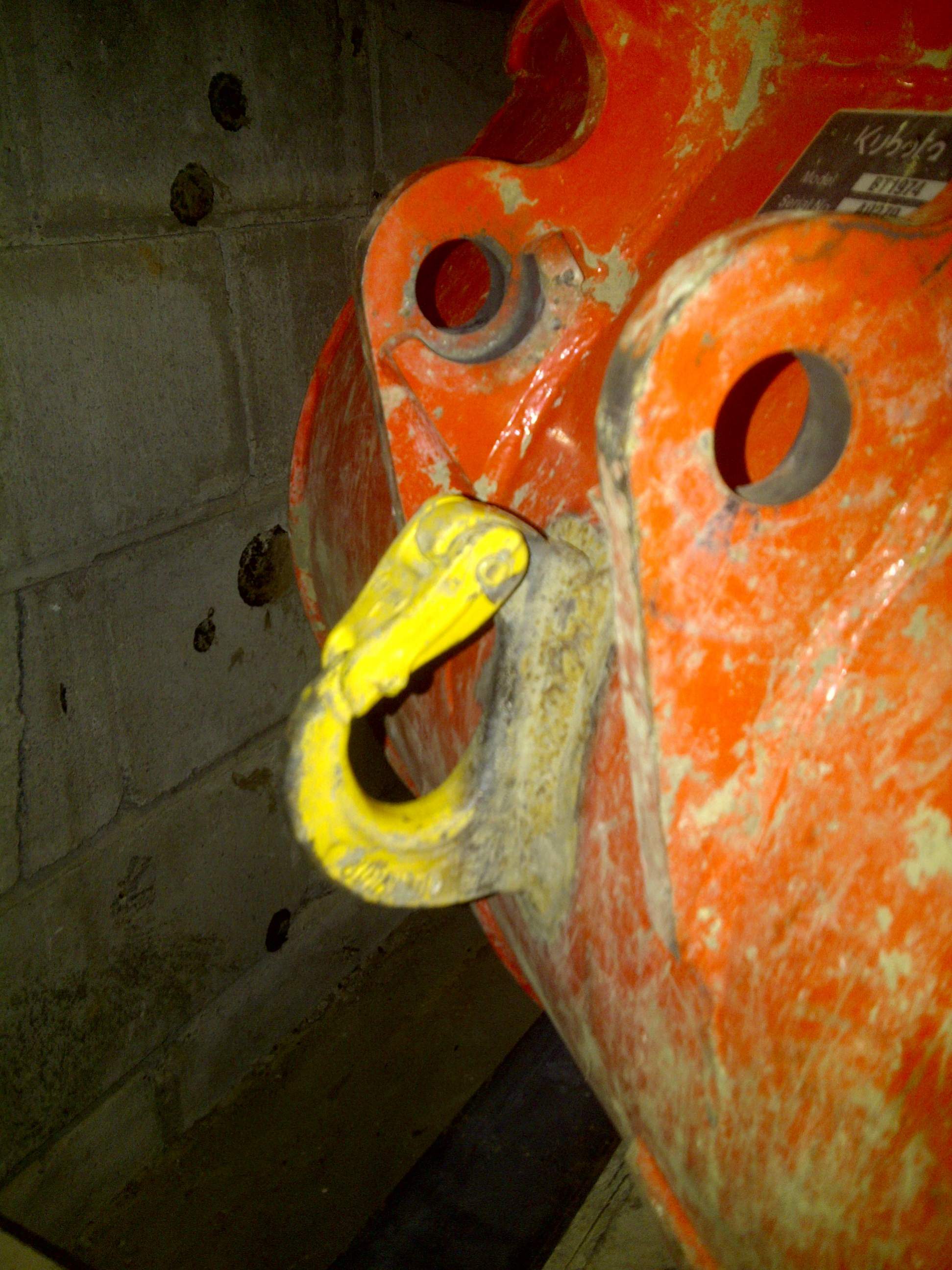

Here is a picture of the hook I welded on an 18" BradCo bucket. You want to tuck it in where it won't be sticking out, but need to give clearance so you can put the bucket pin in all three adjustment holes....
Thats about where I located my friends

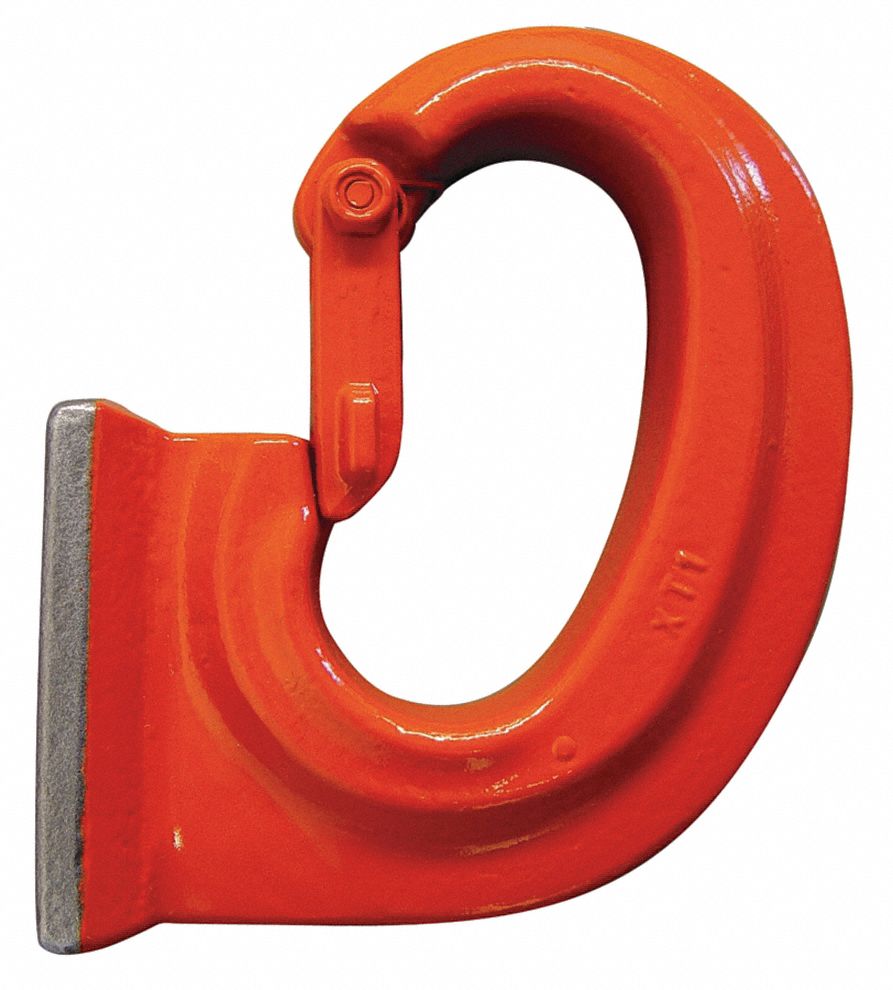

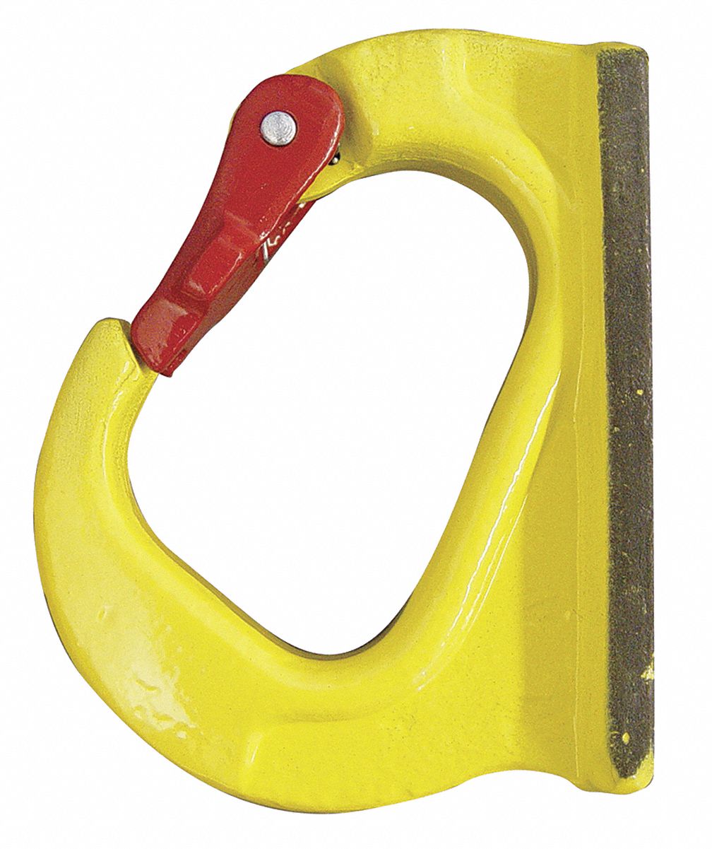

Hi Gary
Attached is a photo of the hook I welded on all of my B26 buckets. This hook is rated at 1 ton which is more than enough for the B26. I like this hook because the safety latch is rated the same as the hook so if you are moving an object around and adjusting the curl as well you do not have to worry about the chain slipping off.
Regards,
Lauren

Hi Gary
Regards,
Lauren
That is a nice and safe hook, where did you buy it at and how much? I want to put on like that on my B26
That's a good place for a hook on a BH bucket!!! :)
Thanks for sharing!
