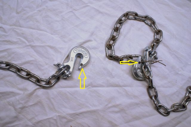

Hmmm.... Found these examples of mousing....
A shackel....
A hook....
Is this hook legitimate for mousing or is it missing latch bar?
Dale
That last (yellow) hook can certainly be 'moused'. It looks like it has been fitted for, but not with, a spring loaded latch... the wee hole could also be used for further mousing the latch.

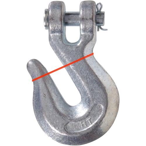

Dale, hard to tell just from a photo, but to me that looks like a 3/8" grab hook on a 5/16" chain. :scratchchin: Is that a possibility?
5/16 and 5/16.... Very conscious of chain sizes because getting things to stay "connected" has been top priority... Tired of fooling with chains, just want to get "work" done...
And the whole idea was to make what I have work, I can go out and buy a whole bunch of different hardware, but to what outcome, just having a lot of surplus "stuff" on shelf that takes up space and gathers rust?....
Dale

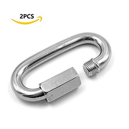

Here is another scenario, all the quick links I want to use, that seem to be correct size always seem to have to large diameter threaded area and will not pass through chain eye... Have resorted to sligh modification of threads on some of the links for ease of use by taking a file and doing light pass on threads to remove some material on link so it will pass through chain eye.... So am I wrong in thinking the load spec of link should be same as chain (or as close as practical), and that the diameter of link body material should be about same as chain link material diameter....
Note file pass is on sides where red lines are, not completely around body of threads, Maybe reduce overall diameter by 1/32 to 1/16 inch that allows link to pass through chain eye if proper oriented, yes it may reduce the holding strength of link, maybe 60-70% of tread are still intact...But it allows me not have to spend hours at hardware/farm supply trying to match chain sizes to hooks and shackles and quick links (replacing all existing hardware) ..
Glad to have all the feedback, never expected to learn so much just to have a chain stay around a log till I could get tension (hook lockup) on it...
Dale
/ $!#& Chain Hooks #32
Caution with those quick links.
The ones I've found always have a very low working load rating compared to the chain's rating.
Example, lots of the 5/16", Grade 70 chains are rated for around 4700lbs working load, where the quick link may be rated for around 1700 lbs.

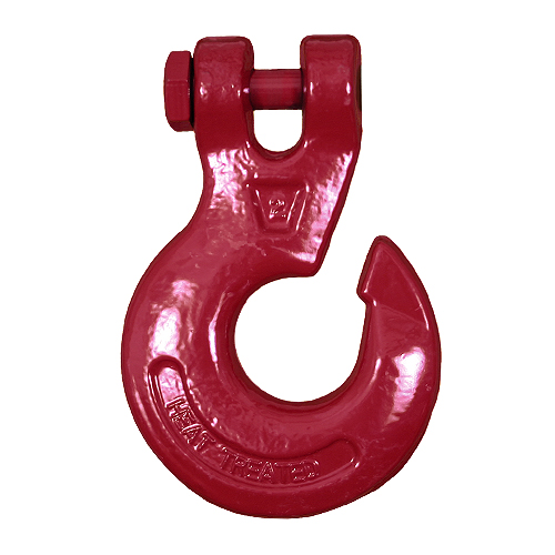

I received 2 of these logger choker hooks with my Wallenstein winch. The pin on the one end is used to stab under the log and then you can pull the chain thru. Slide the chain thru the hook as TractorNH describes. Really makes it a easy to hook up logs. The chain end and pin then goes into a key hole slider on the cable. You could just as easily connect to your grab hook. Later20180808_131004.jpg

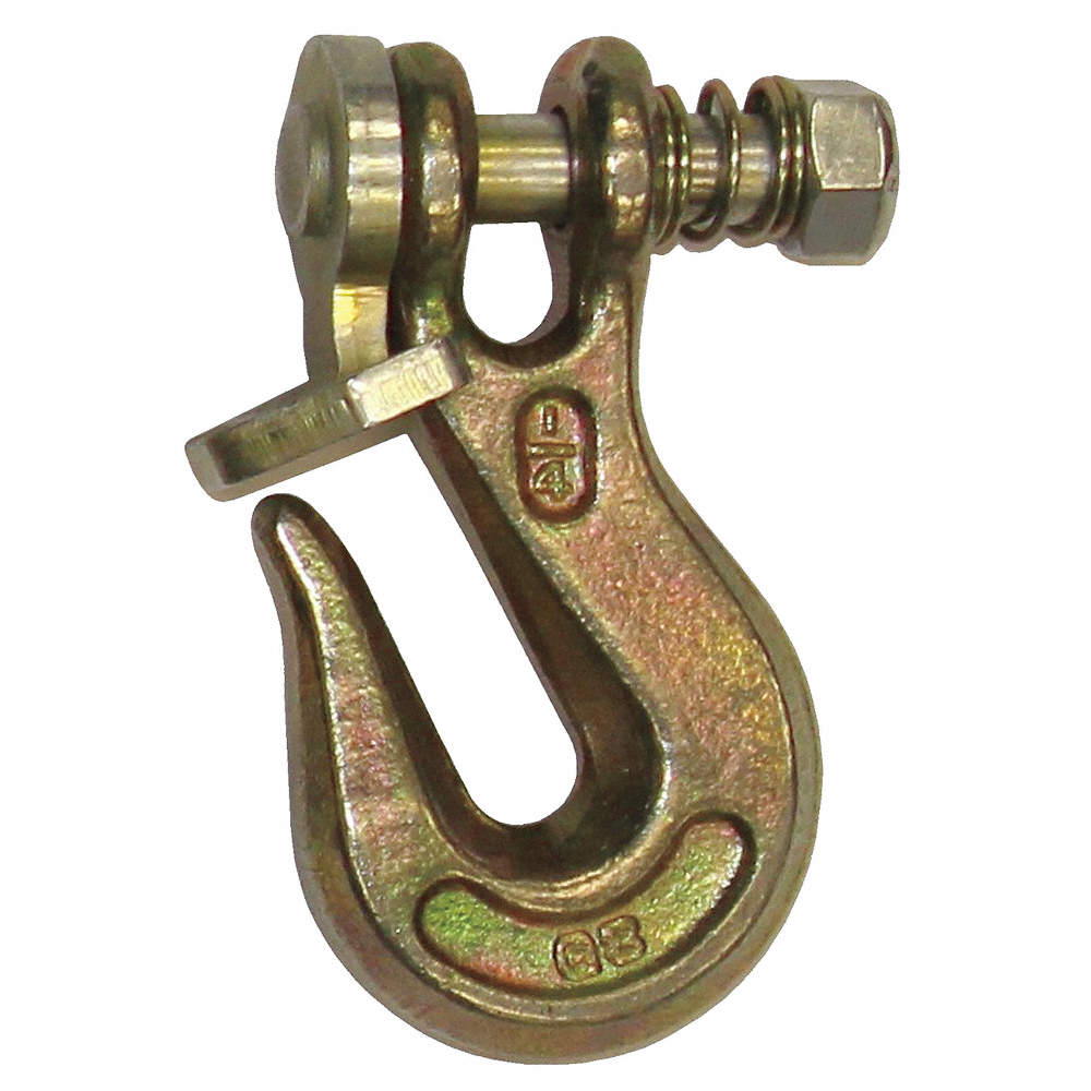

That's been my experience with bent sheet metal slip hook latches. Grab hook latches are much sturdier. Here's one style.
Grab hook latch
Bruce
+1. I replaced all of my slip hooks and grab hooks with this type a couple years ago and chain usage is now easy all of the time. I seem to recall I got them originally from Ken's and then later found them at Northern Tool by the trailer ball mount parts area.
/ $!#& Chain Hooks #38
Same, have them on most all my chains. Ken's Bolt on Grab Hooks <<Accessories>> is a site sponsor I believe. Those clips can be a pain at times to latch or inlatch, but better than than things falling off.

Something quicker, stronger than using mousing wire is to find the right size shackle for the hook. Leave it on the chain.
