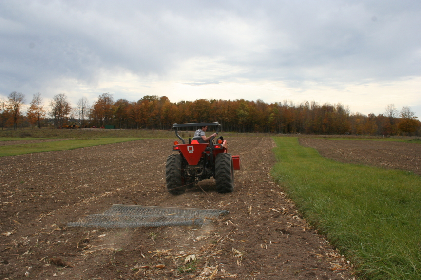

I use a piece of 8' x 10' chain link attached to a 4x4. A larger 6x6 or even a log would work better because of the extra weight. I use mine while spreading pasture seed and fall rye before I make a pass with my cultipacker. I attached the fence to the 4x4 using fence staples and my 4x4 is at the very front.

   / Chain Link Fence Drag Harrow?
At the front, as in closest to the tractor?
Doesn't that just make it load up in front of the 4x4?
Also, if it is at the front, do you use side supports?

I have been using a piece of 6'x8' chainlink with a 3"x3" tubing at the head for going on three years now for landscaping the terrain, hauling brush and 8"-12" stumps to the burn pile. It does have a tendency to curl on the sides and trailing edge so I recommend that you use something like foundation tie wire around the perimeter and loop it at every chain link intersection to stop the unraveling before you put it to use.

I used a simple 8' piece of 3" black pipe with a couple of links of chain welded to it to run a cable (which then attaches to the drawbar). The chain is run through the fence links to keep it spread out. Two 4" bolts (rebar would work) were welded on the pipe's end to keep the fence stretched.
The weight problem was solved by putting a couple of pallets on top of the chain link and securing them with baling wire. You could even put bags of concrete mix on the pallets for more weight but I have not personally done that.
The chain link will not last long, depending on your soil, but for spreading manure it should work fine. My is used for spreading clumps of cut grass from Bush Hogging. I got the idea from a coastal golf course that was always wet and the fairways were not so "fair" after mowing. They used that kind of setup.

Take a 6" Diameter log or pole, and wrap the chain-link fence around it several times. Chain link isn't heavy enough to act as a good drag harrow, so warp it around a log or pole several times. Use either eye hooks or wrap the log with a drag chain at each end. The weight and "harrow" action of the wrapped chain-link does a great job at final leveling and setting broadcast seed.
