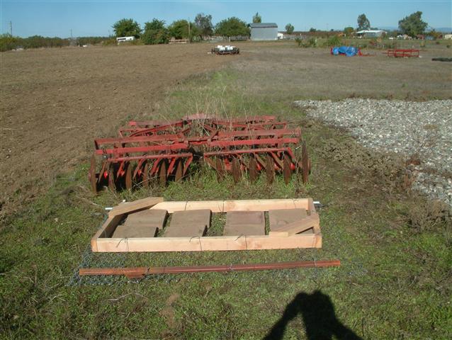

Here's mine
Not much to it--a couple lengths of chain, the fencing, 2x4s, an old T-post in the rear, and a few paver blocks for weight.

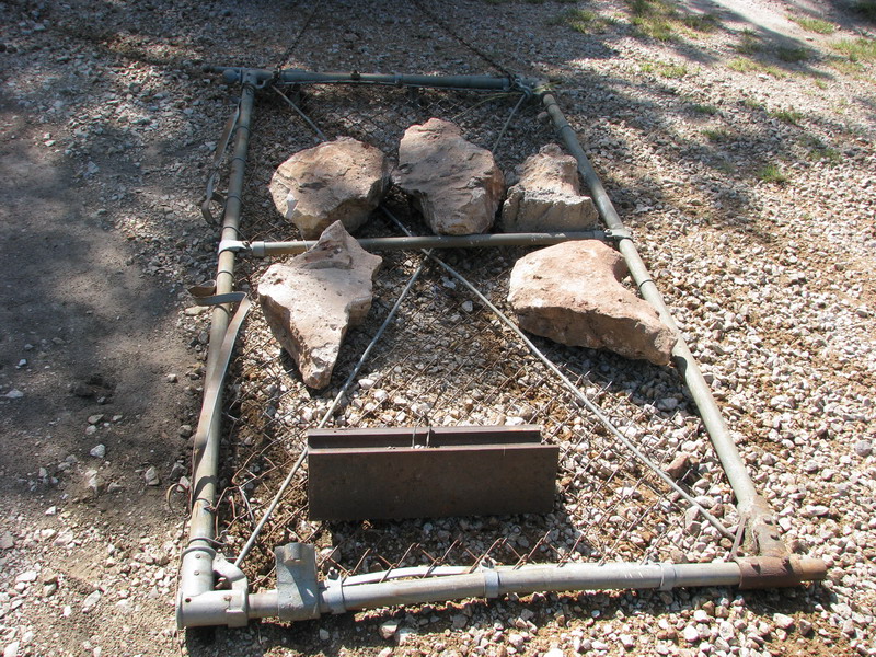

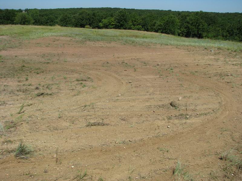

I used an old 10' chainlink gate with additional weight.
