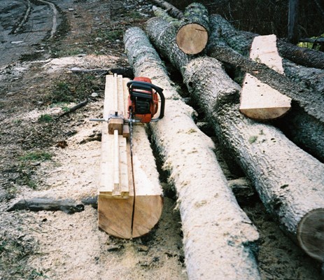

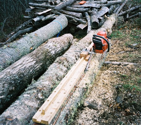

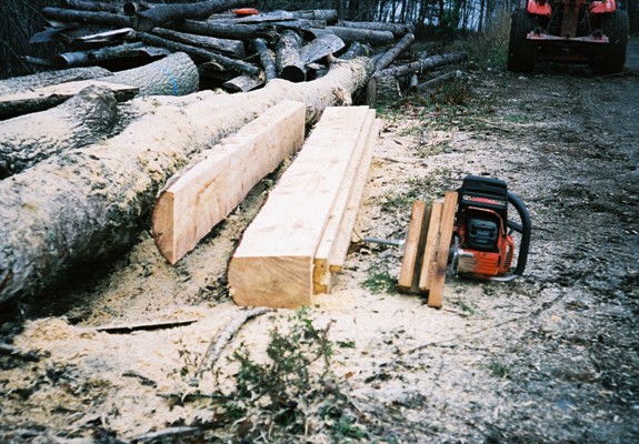

Finally got around to finding some pictures of the mill I use and some timber baulks that have been cut. It's all home fabricated and does make square cuts if the chain is kept sharp.:D
It does take a lot of time when you start at cutting the tree.

Thats a nice mill you made there. What did you use for the clamp to the bar? What size Husky is that? Looks like your mill does a nce job. I use mine to make slabs for benchs, posts and generally just cutting slabs for who needs them for a project.
   / Chain saw "mills"? #26
The clamp to the bar is a piece of 1/4 in. strapping with a rod welded to it. The strapping bolts onto the wooden guide.
That was a Husky 351. Currently I use a Husky 365 with a 24 in. bar.

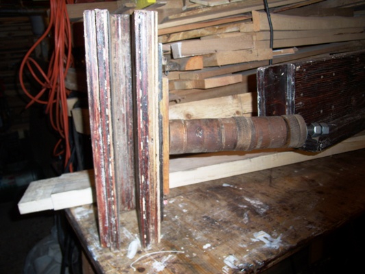

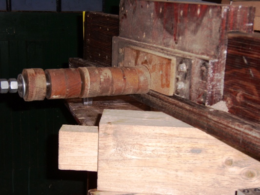

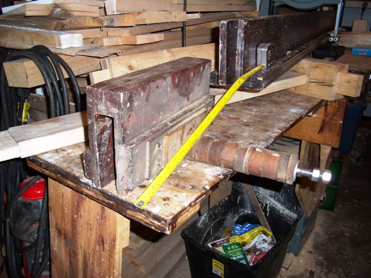

How about a close up picture of how that guide attaches to your saw? When I saw the pictures, I thought you had drilled a hole through the bar and run threaded rod all the way through?
Yes, the bar has a hole drilled through it.
Some close up pictures. This is a slightly different design from the previous pictures. It has better stability and makes for better 90 degree angle cuts.:D
