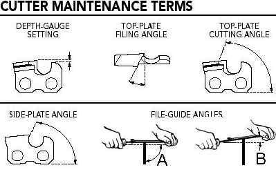

Yes, the "witness mark" is super handy. Of course you also need to pay attention to if you're pushing the file downwards or lifting it upwards, basically, where does the cutting edge contact the file. This is the hook angle. If more of the file is under the cutting edge, that's an aggressive angle, which will cut very nicely, but wrong be as durable because the edge doesn't have as much support. By contrast, if less of the file is covered, and the edge contacts the file in a closer-to-perpendicular or more obtuse angle, the chain will cut a little less aggressively, but be more durable.
   / Chain saw sharpening advice sought #10
I'm calling it the hook angle, but it's maybe better referred to as the side plate angle, like in this picture:
If you allow the file to ride up it will make the angle to blunt, but too narrow an edge isn't good either.
