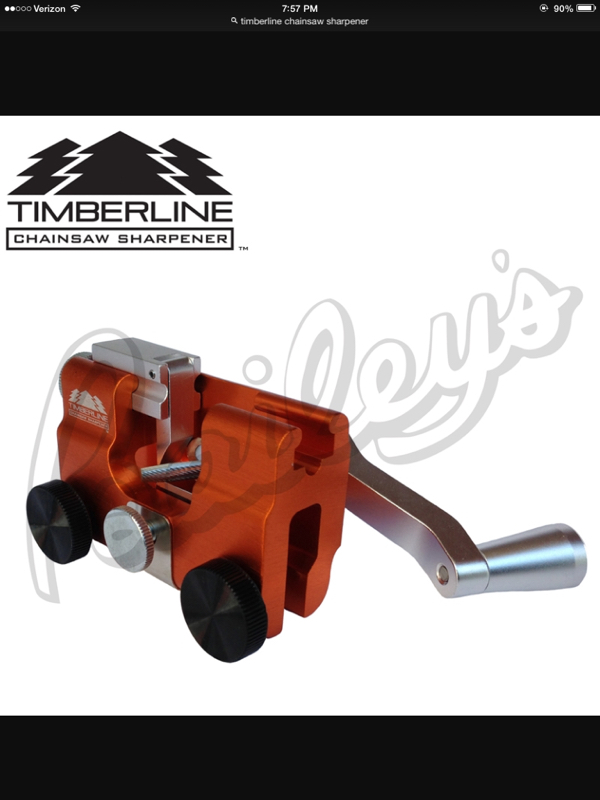

I've been unable to get satisfactory results filing by hand. I can improve a chain, but I can only get them to about 75 percent as good as new. That's with a 3/8 full chisel chain. I can't do a 1/4 semi chisel worth a flip. IMO the 1/4 chain is harder to sharpen and doesn't stay sharp as long. I bought a timberline sharpener and it's great. I've seen the results of some of the cheap electric sharpeners and the timberline works better. With a price tag of around $100 you're probably better off with alternative methods for 3 chains a year. The local co-op "sharpens" them for $3, but they do an awful job. My not so good hand filing produces way better results.

4570Man, I have a 3/8 size chain and will give it a try to see how I do. I did read reviews and watched a youtube video of the Timberline unit and it looks very easy to use and should sharpen well. But, yeah, at $100 plus the carbide bits, I will try to sharpen by hand first since I don't use the saw all that much now. A few years ago when I was taking out a few trees and cutting those all up - well, then I should have had something like the Timberline. I took out about 6 large oak trees, a pepper tree and a tall 67' fir, and a few others. Now I mostly take out dying trees or oak tree branches that have broken off and use for firewood, or cutting up trees that have fallen over fence lines, or back roads. Those large oak trees can look healthy but will break suddenly, and especially under any snow load - as we rarely get much snow, when we do, they are not used to the load so we will hear the cracking and crashing.
One problem tho, I don't really want to mount each of my used chains on the chainsaw one by one to sharpen them. So, an inexpensive electric sharpener might make sense to handle those (I have at least 20) - and I see I can get one of those at H-freight for about $20 with a coupon.

BTW which bar mount would you recommend. I am not sure I want to pop for a Timberline at $100 plus carbide files when my chainsaw use is much more limited now?

I, right or wrong consider myself a pretty good "filer". Been hand filing for ever but by the time I'm half way or more (from sharpening's) through the tooth, my chains are starting to cut circles. I seem to favor one side a little. I got the timberline and highly recommend it. I've quit filing all together. If you sharpen all your 20 chains, you'll only need to pitch in about $30 more bucks to buy the Timberline instead of paying the $5.:D
I see the point - sort of. But now that I have learned a bit here and from youtube videos I think I can sharpen the chains myself. And what I would not be looking forward to though is mounting and taking off all those chains one by one in order to use the Timberline on each one. I could sharpen the ones that are already off - the first time - with a cheap grinder ($20), and would have 20 chains available which I could thereafter sharpen on the bar as necessary. I am thinking I may never need to buy another chain as each one could then be sharpened many times. For as much as I contemplate using the chainsaw in the future I may only be sharpening a chain once or twice a year.
If I was going to be using the saw a lot I would definitely go for the Timberline. But I guess I could also not sharpen all 20 at once and only do so one by one on the bar as I needed a new chain - I could just mount a new (used) one and sharpen it on the bar.
