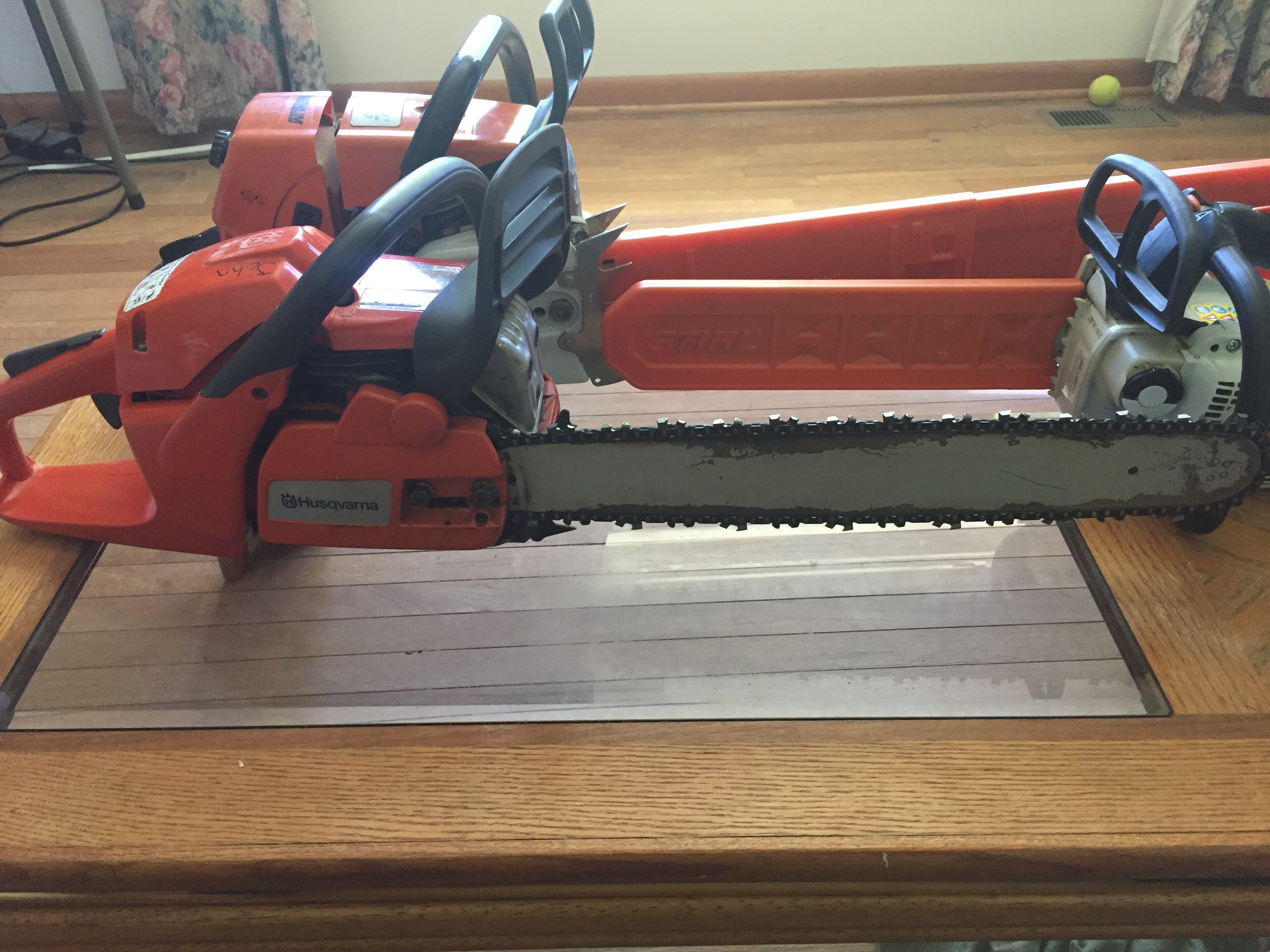

   / Chain saw sharpening advice sought #133
Cleaned, sharpened, greased and ready to go.
   / Chain saw sharpening advice sought #134
View attachment 511389View attachment 511390
Nice! And I'll trade you my 193T for that 192T. The 192 was a sweet heart to start, easy pull, easy start. I had several...as in 3. of the 192. 1st one I ran over with a load of wood, 2nd one I was using on the woodpile and stuffed it in the garage through the back window when I was done. Next time I needed it forgot that and couldn't find it, bought the 3rd one. Found the2nd one a couple days later. Sold #3 back to the dealer as a used say (1 tank through it). 2nd one then grew legs off the back of the truck. Bought the 4th, a 193T. Smallest saw in my collectiona nd the hardest to pull even after warmed up. I know 3 other people with the 193 and all of them cuss the hard pulling thing.
