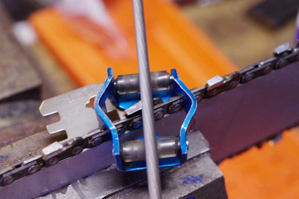

I sharpen one side then turn the saw around and go in the same direction on the other side. I have used one of these for the last 35 years, I find it works best for me. I send the file down the tooth in one direction 4-5 times and it cuts like it was new.

   / Chain saw sharpening advice sought #125
You lost me....
Do you go inside to outside on both sides of the bar?
   / Chain saw sharpening advice sought #126
With your bar on the saw and the bar closest to you, you file outside to inside, turn the saw around, your bar will be furthest from you, your file should go inside to outside. If you take your file and put it in the tooth, it's evident which direction your file should be going in. The file guide above has two slots, one for the file sharpening from one side and one slot for the other side.

Theoretically if you hold you file perfectly straight and with the angle of the tooth on each stroke it should not make a difference. Going outside in makes it easier to "catch" the edge which is the cutting edge therefore I prefer to go inside out.
   / Chain saw sharpening advice sought #128
Thanks Creamer. I don't have a bar like atsah has pictured, I file my chains free hand only. And I think I will continue filing from the inside to the outside.
