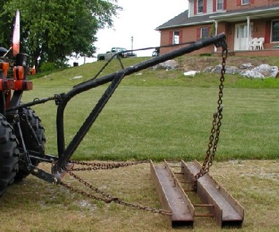

Is this what you remember? It is not as flexible as fence, but with four holes spaced top to bottom where the chain hooks onto the first beam, it can be set anywhere between "dig" and "gloss over"................chim

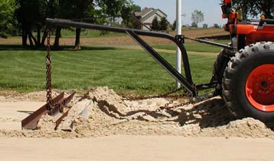

In-use shot..........chim

Chim- your invention looks like it is functioning almost like a box blade. Dirt fills up in between the irons, and then spills out under the back iron. Probably a lot cheaper than the one I'm looking at! Does it move the high spots off and into the low spots?
