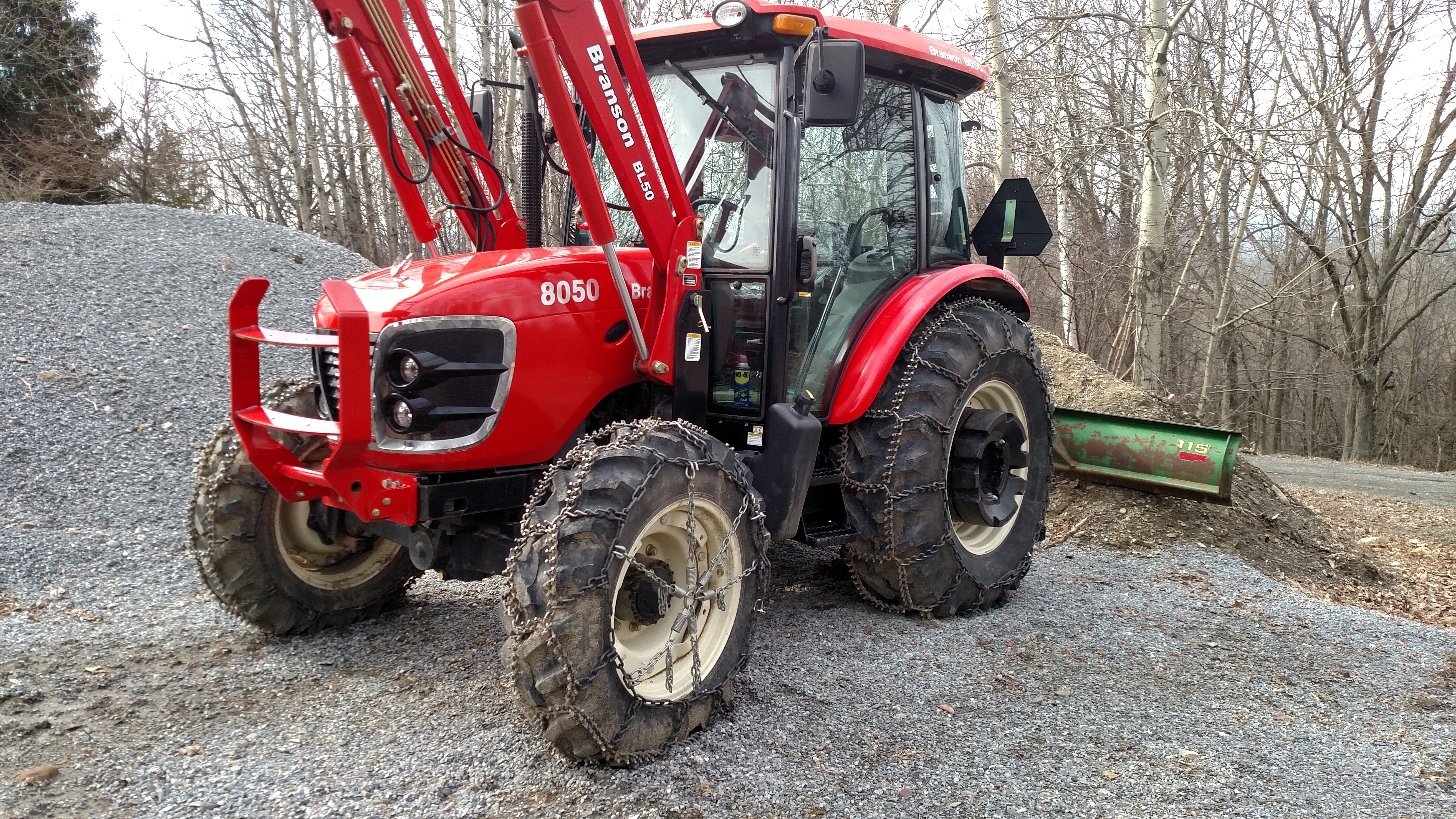

OK, you asked so here we go again myself and a few others have and use and believe in the ability of the "Euro"style chain.
There are posters that will say you don't need them, all I can say is that I have over the years used most every style of tire chain available.
From 4 link spaced street chains to 2 link space bar reinforced, including the so called duo-grip and even the big double ring chains.
On a frozen dirt/gravel driveway the OFA's, Aquiline Talons, TRYGG's studded chains can not be beat, you will have more traction then you do in the summer.
They are expensive but they will grip better then any thing else available, the traction for driving and stopping is excellent, also side hill traction including side grip is also excellent.
The 2wd plowing was pushing around 16" of snow with that style of chain.
