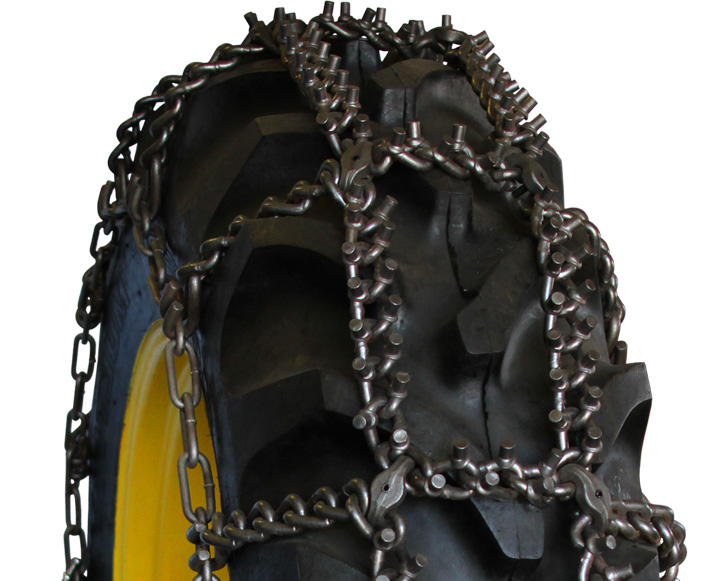

A picture of some real ugly chains. A set of these may eliminate many of the OP' s traction problems.
[video]http://www.silverlakefabrication.com/logging/tryggsuper-dutytightringchains.jpg[/video]

the more chain you buy the better a two link V bar chain may be all you need. You also need chain tensioners.
The problem with the R4's is the tread is that they are bidirectional so the cross chains cannot lay in the trough that is created with the R-1-2 tires. A turf tire is simple as the cross chain lays there and is able to flex and enable the cross chain to grip before that portion of the tire compresses against it as it advances on the turf or the asphault.
Log skidder and grader chains have to be tight against the tread due to the hight torque their drive trains generate as they use a planetary drive system in many cases and in mopst cases all the tires are loaded with liquid ballast.
It all depends on how much you can afford to spend, Log skidder and grader chains have a monster grip just like glue on snow.
