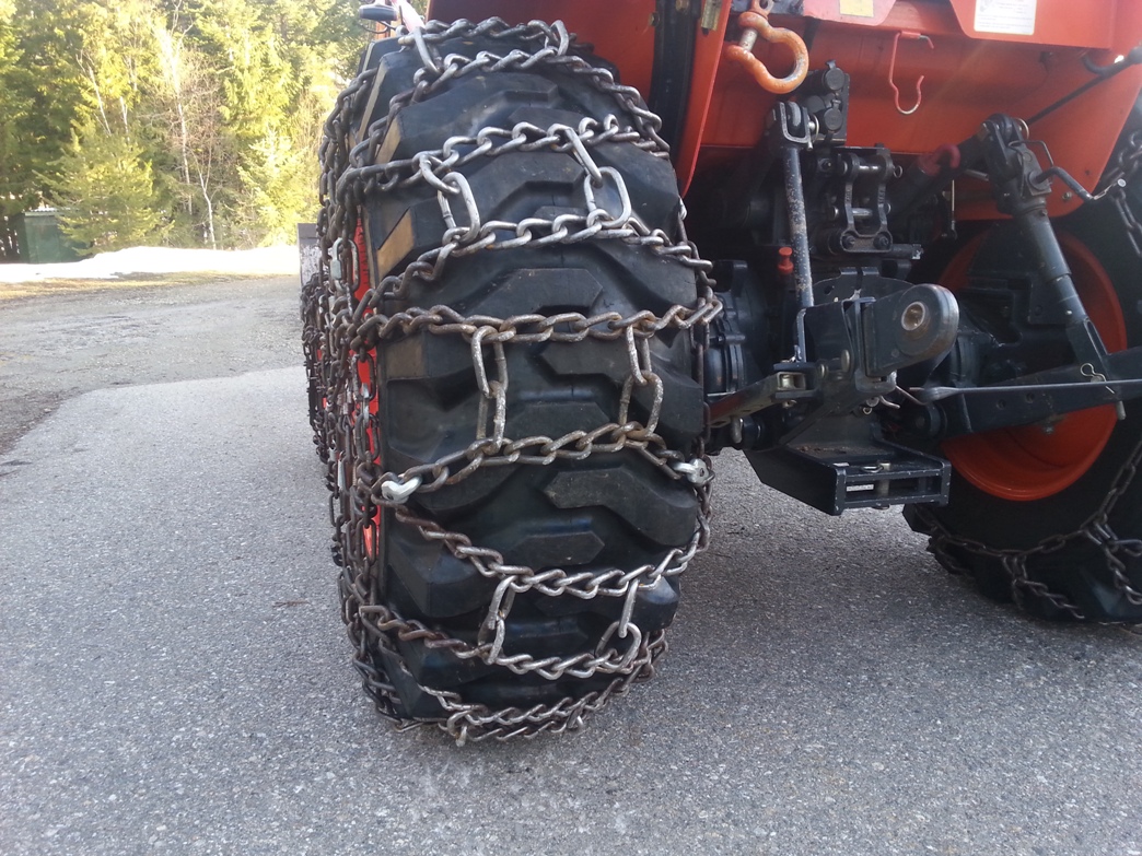

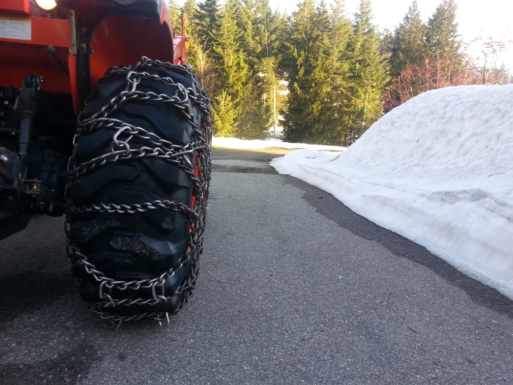

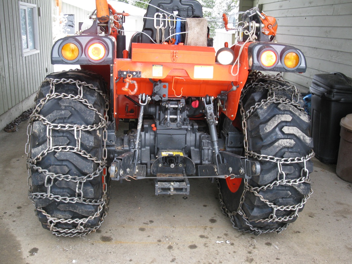

tkcomer, it looks like your 15x19.5 R4's are similar to the 43x16x20 R4's on my DK35 (which I think translates to 16.9x20). I bought standard DUO's and was not happy with them. They were rough due to the large gap between the patterns and the chain end closure. I tried to fix the large gap at the closure, but it still had a large gap as seen on the right tire of this photo:
The DUO/Ladder chains you are considering should be an improvement over standard DUO's. I fixed my DUO's by adding patterns and converting them to an H-Pattern as shown here:
That closed the patterns, reducing slippage and smoothing the ride but I still had to fill the end gap (seen on the right tire in the above photo) with a single cross chain.

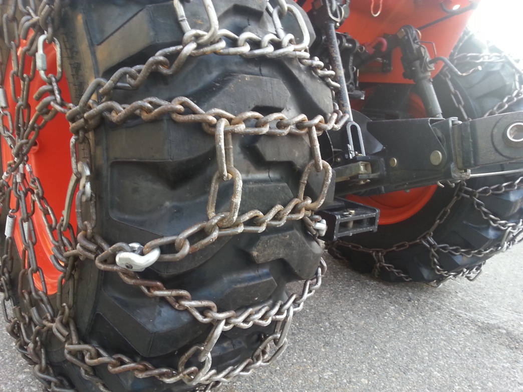

Last spring I finally fixed the end gap by adding an additional DUO pattern and using pin couplers to connect them over the closure at the chain ends as shown in these photos:
This made the chains smoother and more effective, and properly closing the end gaps stopped them from becoming misaligned. I was fortunate to be able to buy bulk DUO patterns locally at a good price to make the modifications. I also had to buy a chain tool.
I was not happy with the DUO's until I converted them to an H-pattern with properly closed end gaps.

kco, I have the same chains as you (that came with my machine), I haven't used them yet "because", they need to be modified, I have "5" links in between the "H" pattern making for a wide "H". And one link between each "H". I noticed on yours that you have "3" links between the "H" and one between the "H's", I'm thinking on reducing my "5" links to "3" like yours and possibly bumping up the "H" to that single link like you did in your mods. My question to you is, how do you find the ride now and do you leave your chains on all winter or just throw them on when needed.
