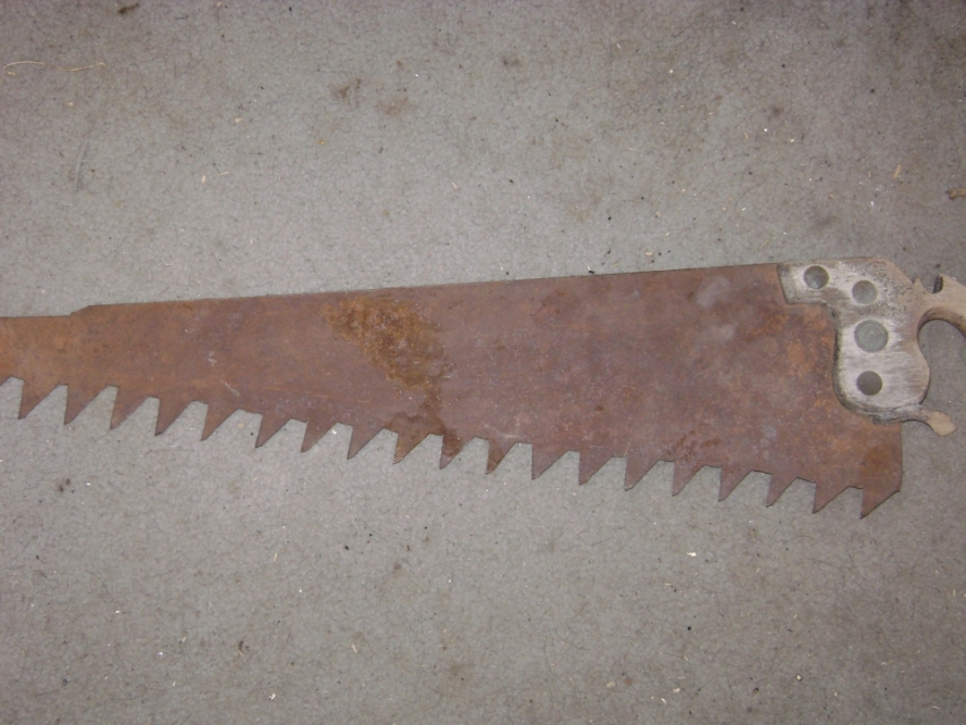

What's a snow saw? Oh and I have side with the little lady on that one!
This is a Snow saw, no joke. We used to use it to cut snow into blocks so that we could haul them into the barn for the cattle when the well would freeze up in January. It was also used to cut steps into very large snow banks so that we could get to the barn.
It's really nothing more than a hand saw with the teeth re cut, not much good for fine cabinetry but it does a great job on snow.
