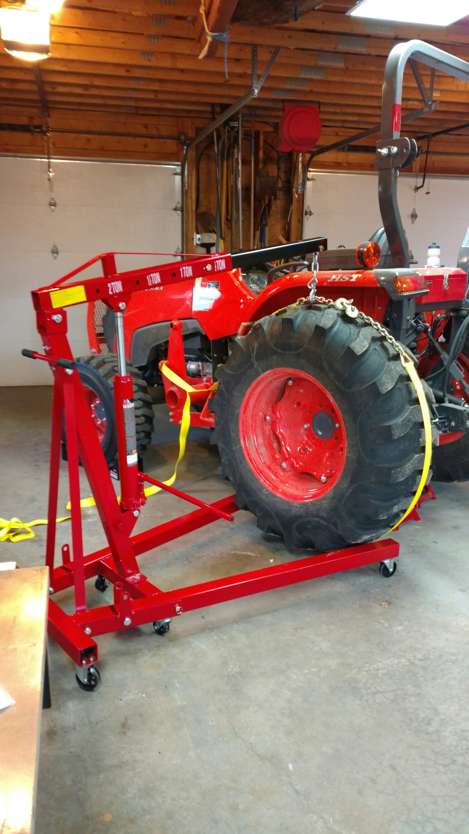

Chains hitting 3PH arms. Need advice on spacers
   / Chains hitting 3PH arms. Need advice on spacers #41
#42
Looks like you can move the lift arms in where the attach to the tractor. Bolt them on the other drop leg. At worst, you redrill..
You mean move the pins from the holes farthest from the rear of the tractor to holes that are closer?
   / Chains hitting 3PH arms. Need advice on spacers #44
Why not remove the pin you have wire tied in the sway bar, and pull the arm in toward the center of the tractor on both side and re install the pins? Also the pin hanging by the chain is suppose to be used in the sway control arms, no need for the one with the wire tie
   / Chains hitting 3PH arms. Need advice on spacers #45
Where the lower lift arms attach to the tractor, it looks like they can be moved over to the other drop bracket.
   / Chains hitting 3PH arms. Need advice on spacers #46
The R4s on the economy Kubota's are non adjustable. I couldn't fit rear chains on my old L3200 because of it. Haven't looked close enough on the new L4060 for chain clearance with the wheels set to 72", but it looks good. The R4 rims on the new grand are definitely adjustable though.
Not excited to widen it further & have it wider than my few 72" implements. I'm already needing to replace my 60" blower & some other stuff to match the wider machine.
#47
Think I solved the problem without having to do a tire swap. Extended out the telescoping stabilizer bars which pushes the lift arms towards the centerline of the tractor. Got the block heater going now. Need to back up to the blower and see if this setting is still wide enough to hook up. Definitely will have to loosen the pats easy change couplers and re-align once hooked up
   / Chains hitting 3PH arms. Need advice on spacers #48
When I had chain problems on the inner side of my rears I added a couple of binders that I made from inner tubes and S hooks.
My clearances are minimal, so much so that my hand will not fit in there but with binders I solved the problem.
#49
I have plenty of clearance between chains and the fenders. Was just the dang lift arms.
   / Chains hitting 3PH arms. Need advice on spacers #50
Dude! I brought this up in post #10! We are now at #50. Lol. :confused3: :drink:
