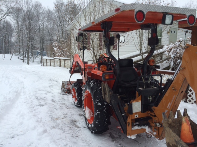

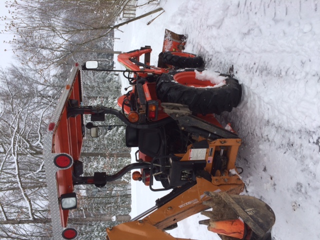

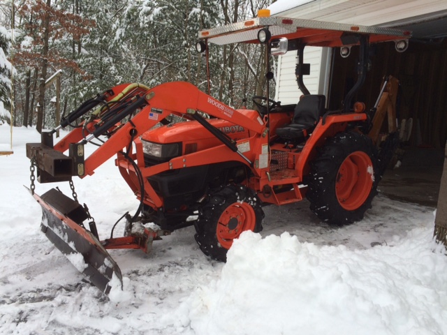

Suspect the chance of getting a second hand setO tires n wheels for my Kub are slim so guess chains it must be. However never considered the clearance, better take a good look C first......

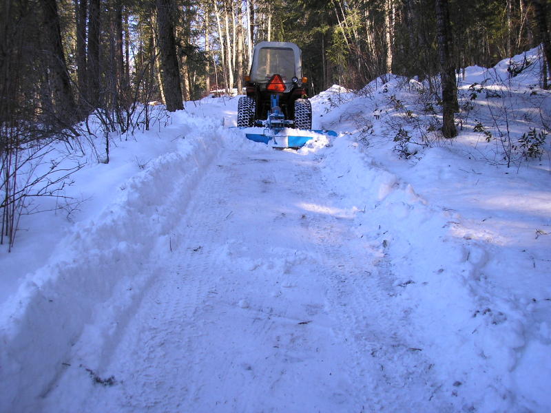

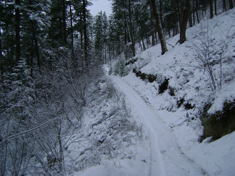

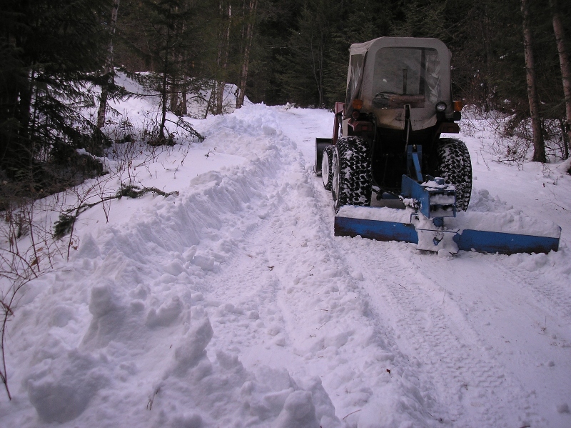

I disagree with the opinions expressed here from personal experience. This is the first winter I haven't kept 3 or 4 miles of mt. trails open with chains on the front wheels of my small tractor in 23 yrs. . The universals and differential are original and still solid. Smaller wheels take less power to turn is the reason for smaller axles and dif. The average home owner would never put the stress any where near what I have on their tractor with chains on the front. If there was room I may have put chains on the back wheels as well. plowing 004.jpg

I disagree with the opinions expressed here from personal experience. This is the first winter I haven't kept 3 or 4 miles of mt. trails open with chains on the front wheels of my small tractor in 23 yrs. . The universals and differential are original and still solid. Smaller wheels take less power to turn is the reason for smaller axles and dif. The average home owner would never put the stress any where near what I have on their tractor with chains on the front. If there was room I may have put chains on the back wheels as well. View attachment 410623
Here's where your logic is flawed: Catastrophic failures linked to front chain use are not cumulative, they typically result from instant shock loading from specific events. A chain on a spinning tire grabbing a frozen lump of dirt and instantly re-establishing traction, for instance. You have enjoyed good luck, and perhaps you are a very careful operator, but I've seen guys cry about repair cost after boasting that chains on front wheels was no problem for them.
