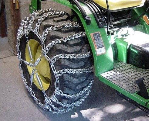

These are what I bought a couple of years ago for my 4115. I had the cross over typs at first. They felt like I had 2x4s nailed to my tires. Shook the **** out of me and the tractor. I called tirechains.com and had them make me a set with a cross chain every other link. These ride great and really give me the traction I need on my drivway.
Dave
