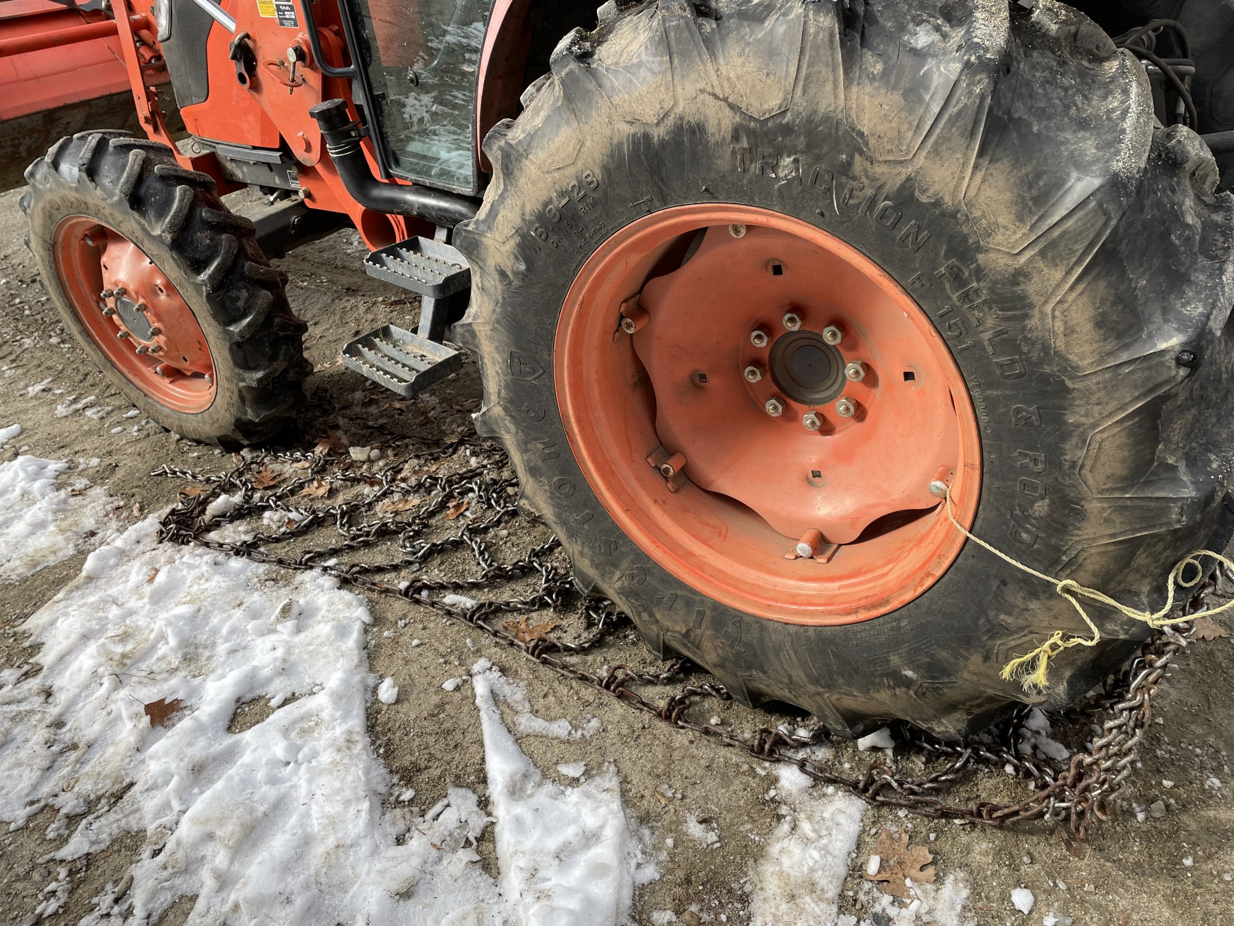

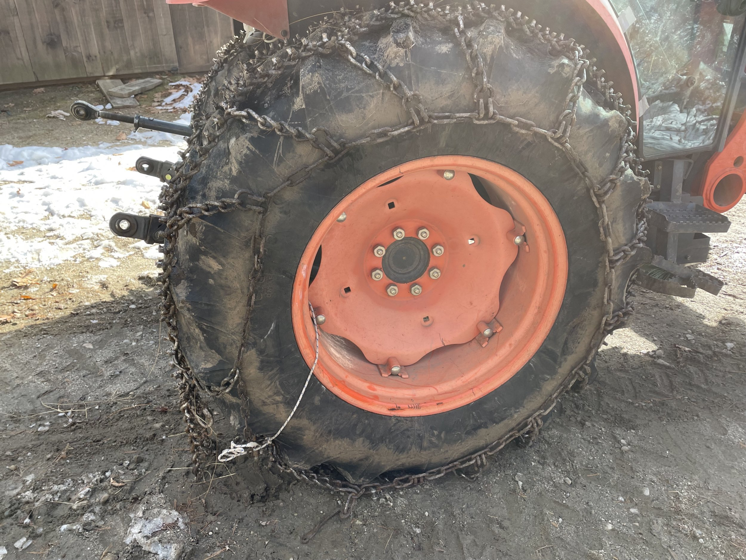

Chains mounted using the “roll them on” method. No more heavy lifting and dragging.
These chains were originally sized to fit my old L4630 with industrial tires so they were way too small for the M6040 with ags.
I had to jury rig them to fit. the bigger, taller tires.

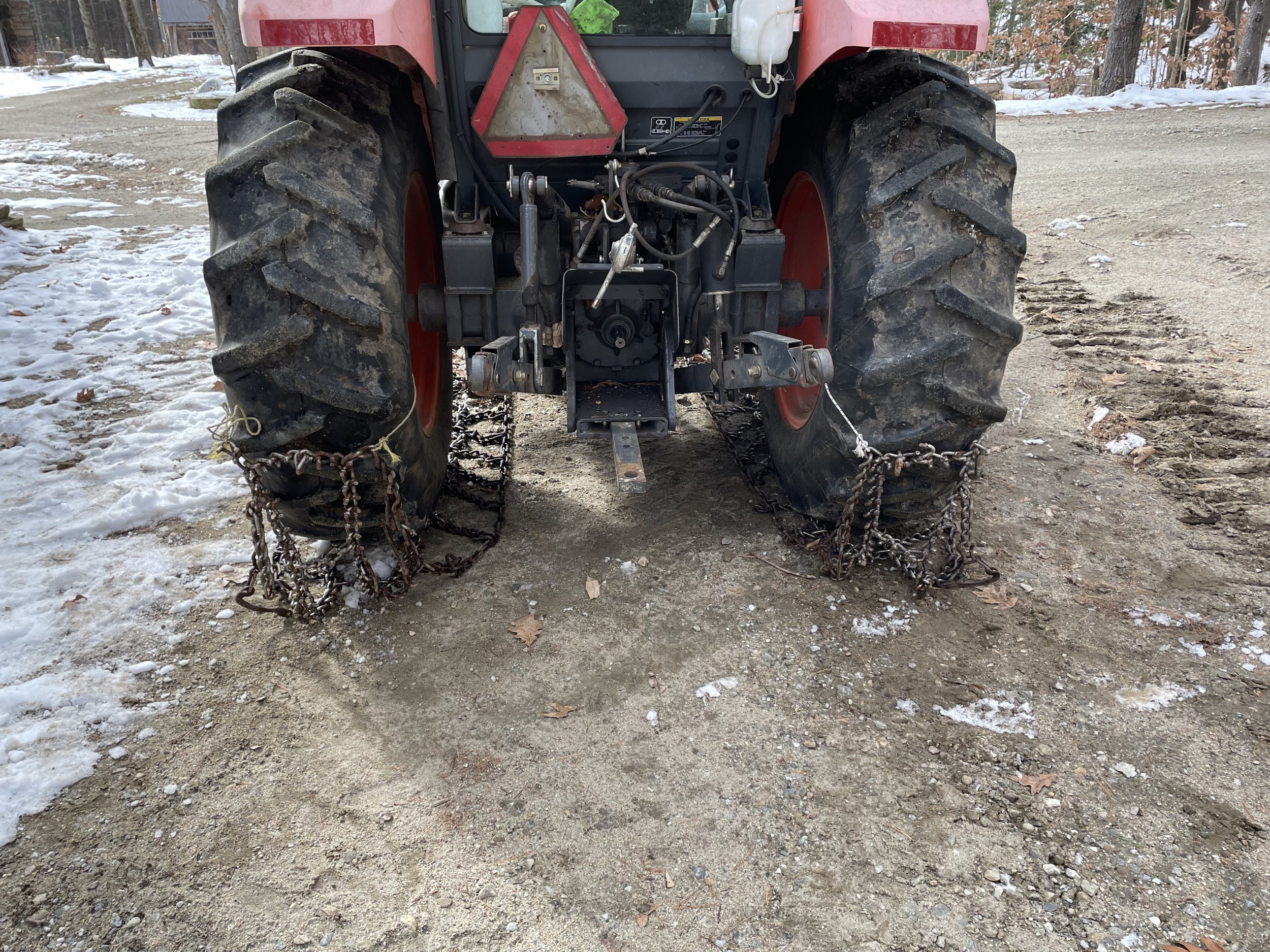

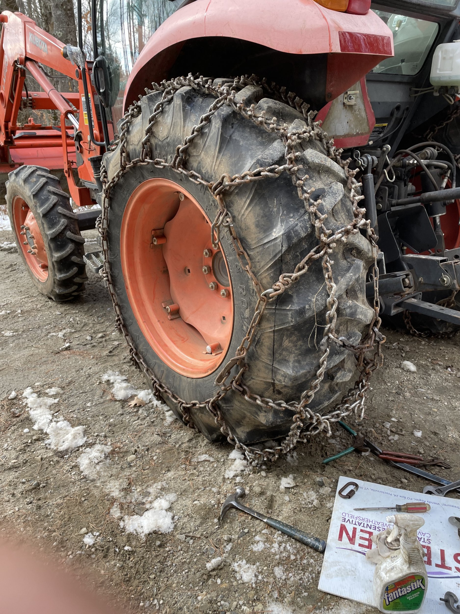

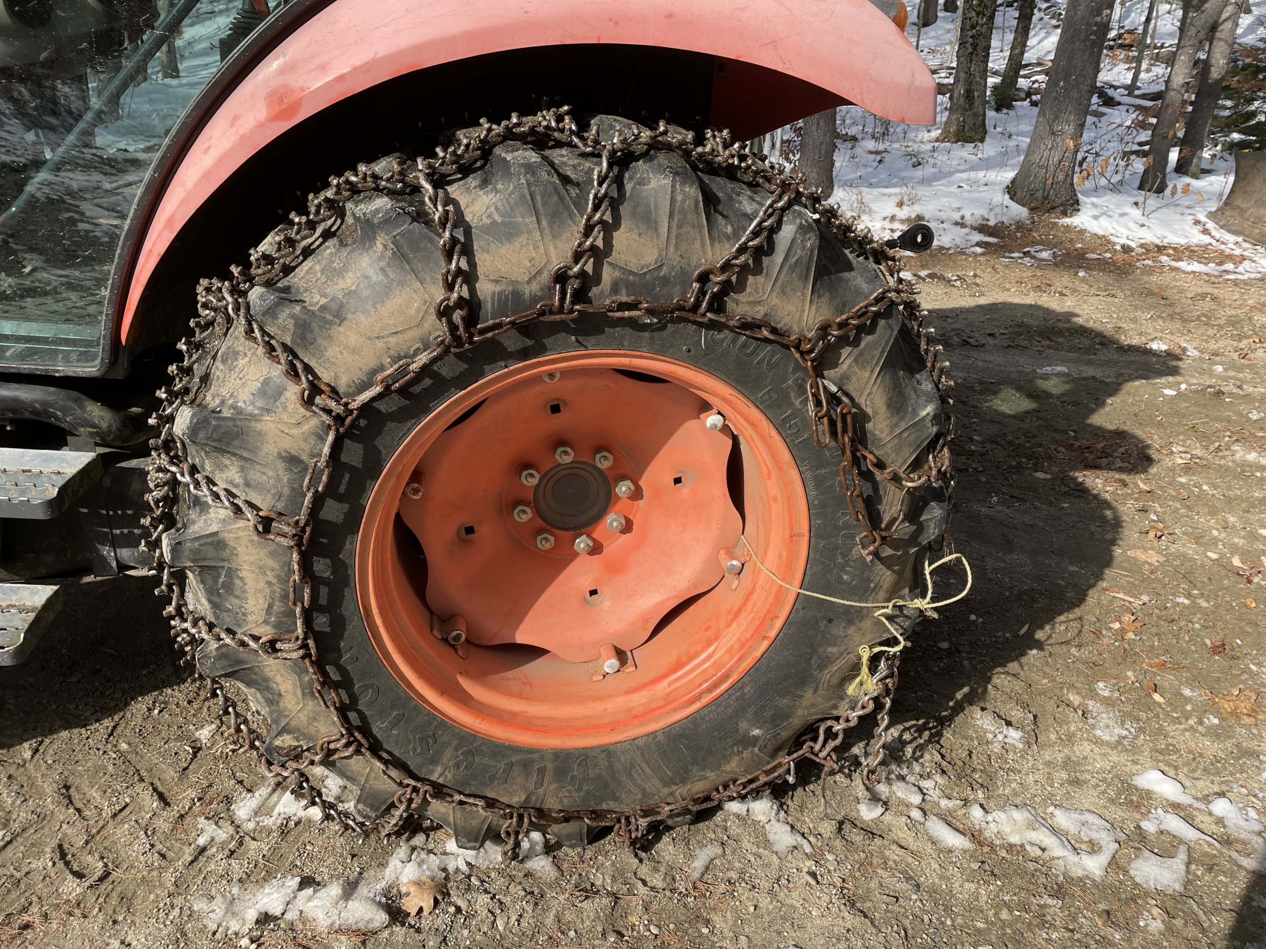

THere is an easier way:
I have been mounting it pretty much as @LouNY describes in the first post. Hanging the loop on the tread as Lou described worked OK most of the time when my tires were newer, but as I've worn the tread down over the years, I've had trouble with it popping off the tire. Now I tie one end of the cord on, pass it through a hole in the rim and out the other side, then tie the free end back on to the chain. No chance of it slipping off that way.
The other change I made is that rather than tying to the ends of the side chains, I tie one end of the rope about 1/3 of the way along a cross chain, pass through the rim and tie the other end about 2/3 of the way along the cross chain. This leaves the side chains hanging free. I can connect them up while the rope is still tied one, then remove the rope when I'm done hooking up the chains.

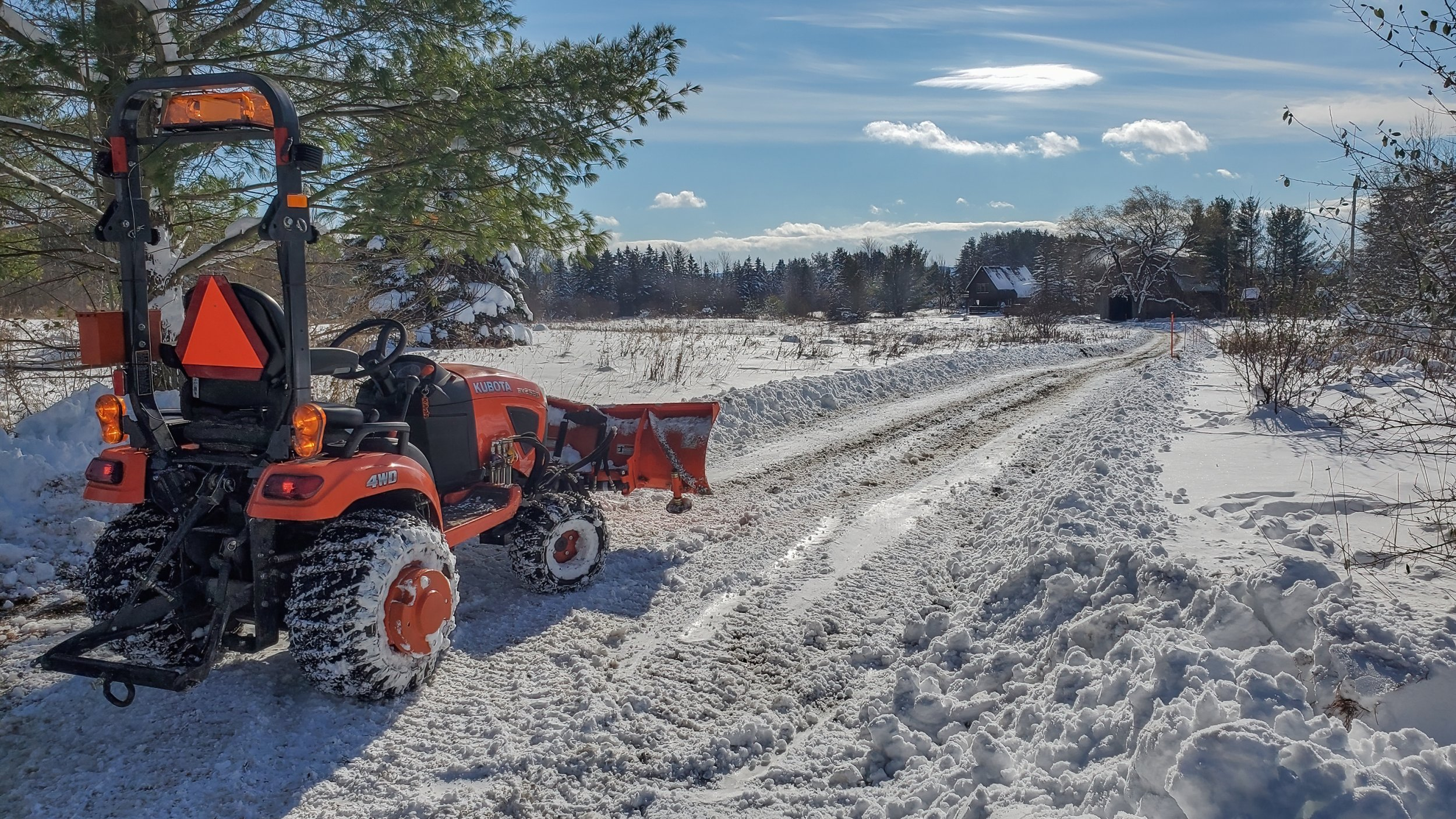

I use chains on my Kubota when I dress her all up for winter. I find taking the wheels off and using the work bench works for the small stuff. I don't bend the way I used to. My JD 4320 works fine without chains, but I don't have a steep driveway.
