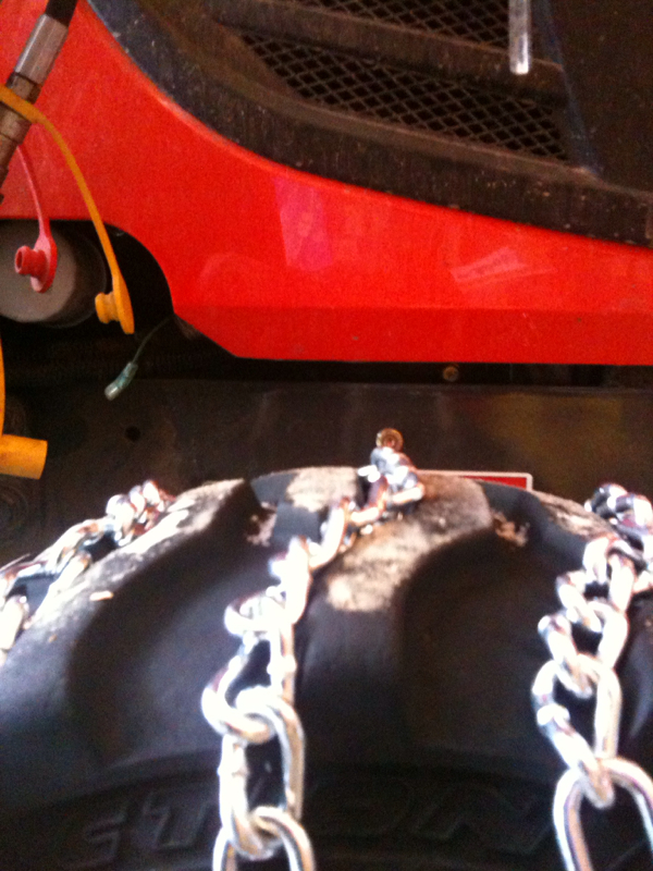

My discs are out. The only change is side to side. The welded bosses aren't in the center. It all makes sense, as does the tread. I replied quicker than I thought. I don't have much time in them, but my chains are super rough. The vbar is just very tall. I can't win a speed race, but I'll win a tow-off.....
Yes, VERY rough. Here are mine.

Well you could do that but of course you wouldn't. You just roll them back far enough to clear the tractor then ahead again on the other side keeping the tread pointed the right way. Say the tractor was pointed north and the left rear was dished in towards the rear end or east. Move it over onto the other side and the dish still points east but now away from the tractors rear end.
aeblanks picture posted back a page looks to me as if it is already dished out but I can't see if there is one more position out he can take by separating the rims from the dishes and mounting the tabs on the inner side of the rim mounts.
