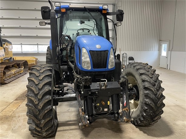

can you drill in some studs into your rear tire bars? Not as good as chains, but pretty damn good
Here they are on the front of a New Holland snow blowing tractor.
I would think they would be dirt cheap and see no reason why they wouldn’t be fine all year round.

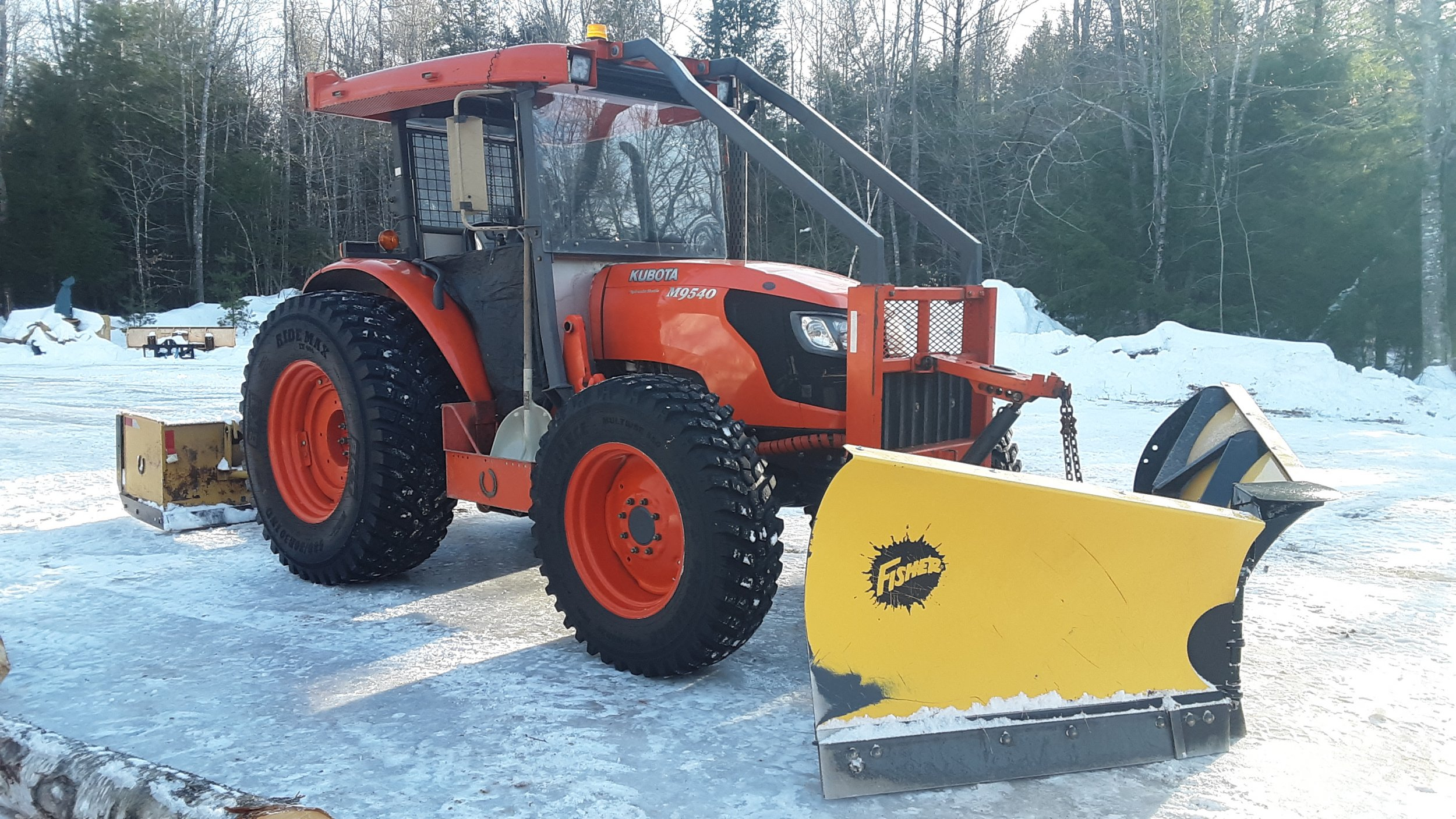

Hay I run studs, they're about a buck each and add up quickly. I do leave them in a even "moved" them to replacement tires so they're very durable.
From zooming in I'd guess that the owner of that NH removed the studs from the center location and reinstalled them to the outer portion of the bars. Removing them does leave a little pocket unsuitable for reinstallation. I learned this after doing the same.
Nothing is in the same league as chains but anything is better than just tires on ice.
They're un noticable on the road.👍

They're un noticable on the road.👍View attachment 784305
Good to know. I’m thinking about buying that New Holland T6050, but I’m not real impressed with it’s tests and its a “Delta”, so it’s stripped of creature comforts. Tires worn down, too.
Nice Kubby! Is that a Dual Speed? Impressive cab structure. I had one and liked it.

"Creature comforts" 😆
Don't look to closely at my picture. That's a Acme hillbilly model cab for woods use.
12 sp hyd shuttle.

Seems like a see a snow blower & a pusher off in the distance, too !
Yes, I grew up snow deprived in the mid Atlantic area. I like snow and the associated toys. 🥳
I don't have enough tractor for that blower without the creeper gears and the pusher is for the SS.
