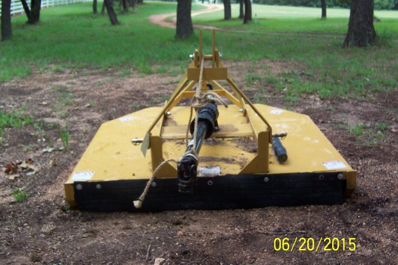

I have had a 6' Mohawk Brave for many years and finally decided to replace it. I bought a CountryLine 5' cutter from Tractor Supply. Compared to the Brave, it was 1/3rd the price and 1/3rd the weight. However, I've found that this is one tough little cutter.
I have been using it to mow my 100+ acre ranch in Texas where it goes through lots of briar and small scrub cedar with no problem. I really like the lighter weight which makes hooking it up so much easier and faster.
I added a great front guard made from a tire tread. Chain guards are too heavy, too expensive, and way to dusty. The typical rubber front guard is made of mud flap material and eventually tears up.
Get an old tire (free). Cut the sidewalls from the tread with a jigsaw (wood cutting blade). Measure and cut the tread with jigsaw with metal cutting blade to get through the steel belting. What you end up with is a front guard that totally safe, eliminates the dust up your back, will last forever, and doesn't cost anything. You'll love the "no dust" that this guard provides.
