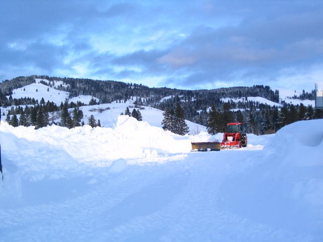

I use "H" style chains front and rear in MFWD and have for years. The fronts are crucial in some areas because one slip could put you down and upside down, and no one knowing until daylight.
This is front country; back country can be 60 feet deep.

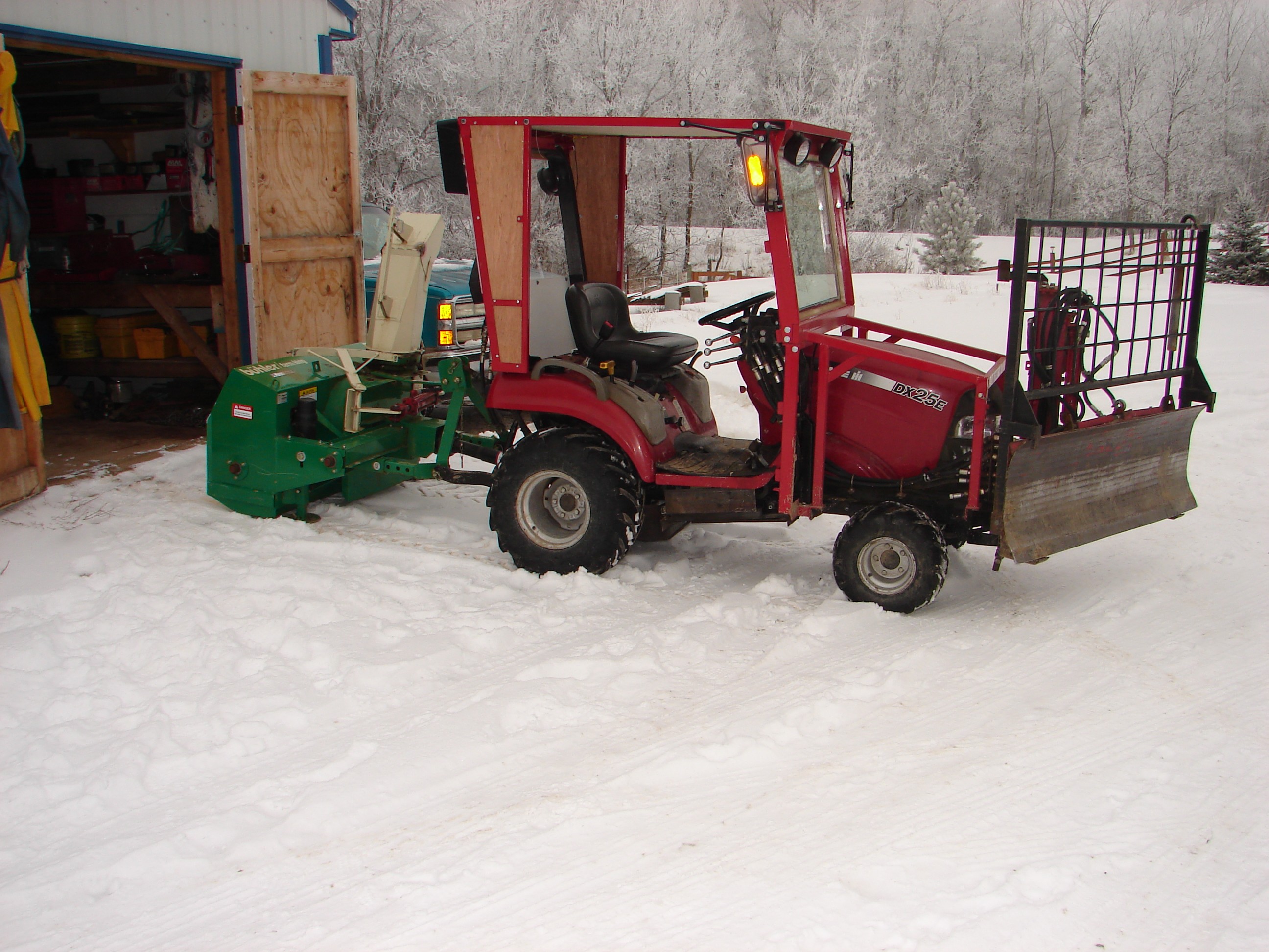

I don't like chains on the rear simply because on a compact tractor they give a rougher ride.
My snow removal technique is to back up and blow the snow, then go forward with the blade angled to cleanup the spillage the blower leaves and/or windrow up the snow for the next blower pass, and repeat this until a road or drive is cleaned. This way each forward and reverse motion has work being done. What I have found out with the front blade angled is in hard or deep snow the front of the tractor is pushed away from the snow instead of windrowing it into a ridge. Even though the picture shows no chains, I will put chains on the front to stabilize the steering when angle dozing the snow.
The front axle of this particular tractor is so well made chains will not affect it's durability. We have no asphalt or concrete surfaces to worry about - wish we did.
   / Chains -where to put them #20
Nice homemade cab. I like the homemade plow set up as well.
