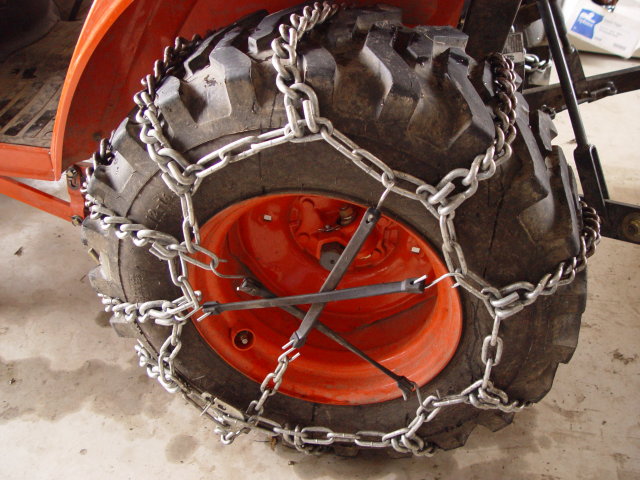

/ Chains? #30
tried to attach picture of my handiwork
