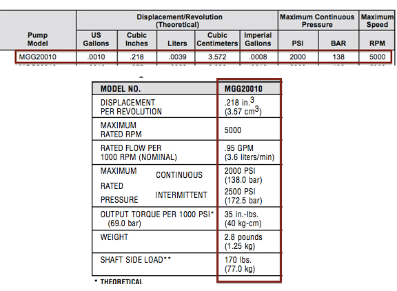

Hi everybody. I am involved in a project in which I need some words of wisdom. I have an old McCulloch mod 660 chainsaw (the type Paul Bunyan used to use). My intention is to remove all the unnecessary gas components and make an hydraulic conversion to be mounted on a tractor loader bucket. This machine is pretty beefy so I think it would make a good candidate for this project.
What I am not sure is how much of hydraulic power I need.
The tractor has a 7.i GPM PTO pump which drives the loader. I was looking at a motor on eBay, Parker MGG20010, which is a high speed/low torque motor. My question is if it has enough torque to do the job.
Keeping mind also that this chainsaw a 3:1 reduction gear for the chain, which it should increase the torque.
I am hoping this motor would work. The reasonable price of $94 is within my budget.
Need to add that the purpose of this saw will be to cut small hanging tree branches, not wood processing work.
Ideas?

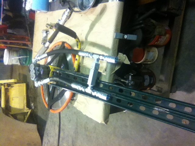

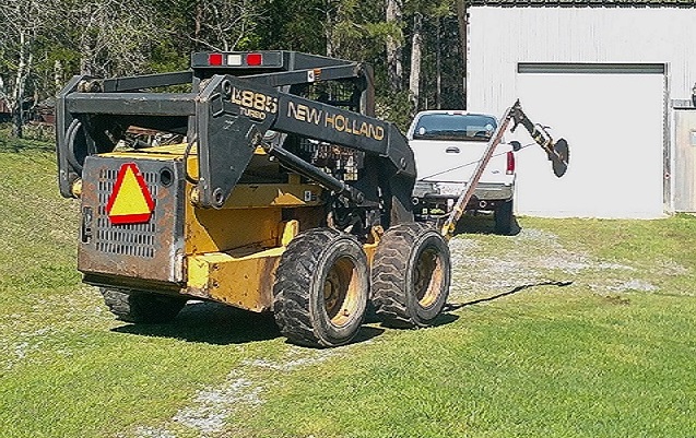

The Parker motor you have would run a circular saw. I have the MGG20020, just slightly larger than the MGG20010, on mine with a 16 5/16"-32 tooth blade. Had to put a flow control to throttle it down to 8 GPM which lets it spin about 4000 RPM which the blade is rated for. The momentum of the blade will let it zip thru a 3-5" limb as soon as it touches it. If the blade happens to be against the limb it won't have the torque to get started though.
The motor came off a hydraulic hand held concrete saw and I used it and the part of the bar that the motor mounted to and welded it to a homemade cobbled up frame to mount on my skid steer. It works pretty good but has a learning curve on how to not break something.
The problem I see with building one from scratch is the 9/16" arbor as already mentioned. I need a new arbor 9/16" to fit a 1" hole in the blade. I'm using the arbor that was on the concrete blade but over time it is getting a little worn, I guess the pressure of pushing sideways on the motor shaft when cutting. Haven't found one of those boogers anywhere yet and will need one by the end of summer. It's getting wobbly.
Haven't been very good at pictures but I'll try to find a few.

Found some pictures just hope they turn out. Also about the arbor, if you have a buddy that does machine work it could be made fairly reasonable. That's probably what I'll have to do since I don't have the machinery for that.

I looked up the Eaton motor. It seems to be a 2.2cuin motor. With your limited 7gpm of oil flow, you would end of with a speed of about 735rpms. It would have plenty of torque and hp, but would be slow for a chainsaw. The circle saw might not be a bad ideal. You can find out what tip speed works best and use that number and your motor speed to do the math and come up with the proper size saw blade you could use to maximize cutting ability. Since you already have the motor, your biggest investment would be for the saw blade and a few hyd hoses. No need for any fancy gearing.

This is good info since I am already programmed to go circular with a 3:1 gearing. I will start with a 12" blade because that is what I have on hand. If needed to, I can always step up. All I need to buy to start is minor hardware. I have the flow control and hoses that I am using for another front implement. Will post results with pics.

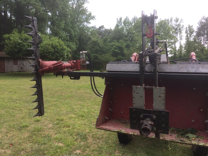

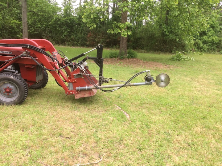

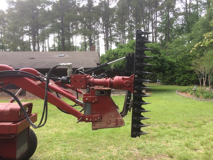

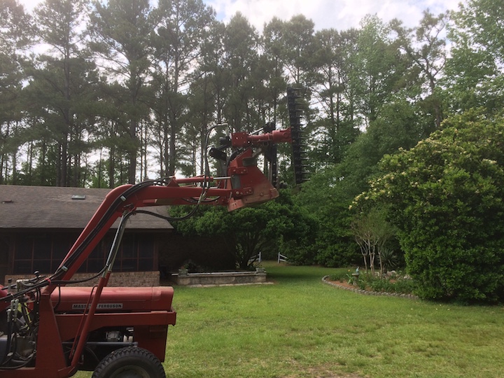

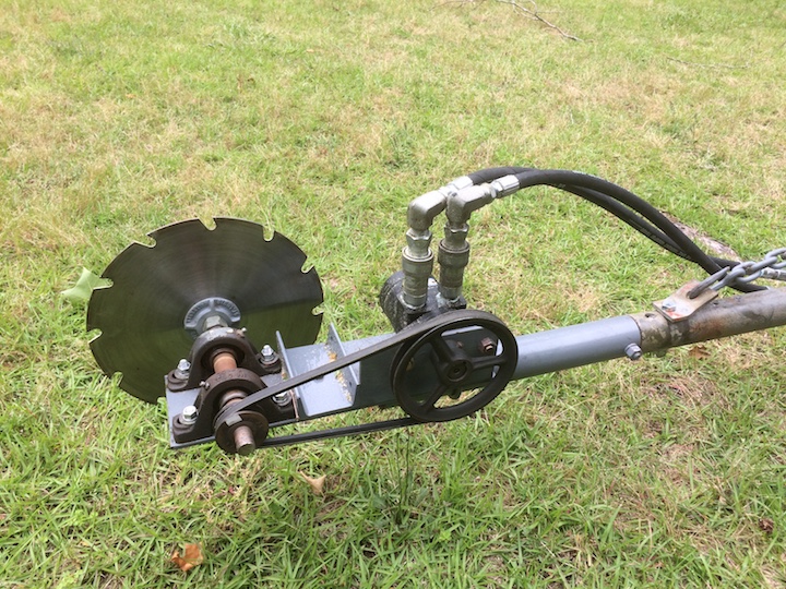

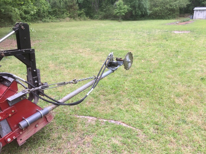

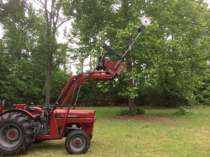

Well this what I have done so far. The arm projects over 6 ft from the bucket. The 12 blade turns 3000 rpm with a tractor 1000 rpm and 3600 rpm with a 1500 tractor rpm. So I think with my modest 7 gpm pump that is all I can expect. It does okay for what I have tried so far, but nothing spectacular. I guess a bigger blade would work better but that is what I have for now being still in a prototype stage.
The head slides out from the main arm and the whole arm is stabilized by a chain with a turnbuckle. The whole thing can be quickly mounted and unmounted with just couple bolts.
The other machine built couple years ago, is a cheap version of the Samurai. It is built from a walk-behind sickle machine head driven by a hydraulic motor. It works great for small twigs but it has hard time with anything bigger that 1/2 in.

NCMau Looks good. Is the shaft left handed threads at the blade side or is that an arbor attached to the shaft. The momentum from my blade would spin the left handed thread off when I let off the hydraulic lever to stop cutting. I had to add the check valve between the two lines so the motor and the blade could coast down to a stop. I also added a set screw to the left handed nut.
Your 7 GPM flow should be plenty to run a saw. My pump has a Max 8 GPM I think. At 8 GPM it's about 4000 RPM which that's the rating on the blade. I may be off a bit on those numbers but in the ball park. The larger blade would give you more momentum and that's actually what you want due to the low torque of these high speed motors.
I've got a couple of sickle mowers laying around so quit tempting me to start building again. :laughing:That's a nice set up you have. Oh yea if I were to use a belt drive I would use the smallest width blade I could find so it could rotate as easy as possible. Not sure if it'd make much difference but every little bit of power helps.

Thanks Steave. Yes the shaft is 1 in, turned down 3/4 in on each end and LH threaded. That is the only reason I gave to a machine shop, otherwise I could have done it myself and that was my biggest expense ($80) so far as I had the other components, I like to stay with the 12 in blade but I wonder if instead of a 24 TPI, a 40 TPI would be better for this project.
I do not have a spring action on the arm, yet. I am not sure it would be totally necessary at this point. I just have to keep my mind not to go wondering and remember to feather the movements instead of dropping the bucket like a hot potato. Also. I probably want to keep the length of the arm the same. So far it seems to be a practical stable length without having miles of hoses. Anyway the project is still in the evaluation phase and if I decide to start trimming trees in the moon, things can easily change.
Also, what I am wondering if a 18-20 in lawnmower blade (with the proper safety shielding) would work. The blade would definitely increase the momentum and chop the little guys instead of being deflected by the saw blade. What you think?
BTW, I am just getting back at you. You are the one that got me going on this circular saw project. That ought to teach you to not inspire projects on to other folks.:laughing:
