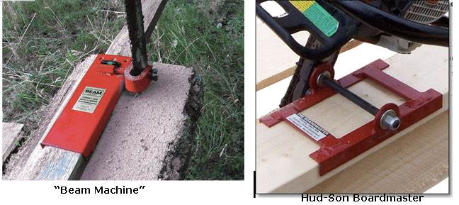

I saw ripping chains on Amazon. Any idea what makes it better than skip tooth?
On a basic rip chain, the only difference is that the cutter angle is better for rip cuts (you can sharpen any chain to the same angle though, usually 0-5 degrees).
Some advanced rip chains have cutters ground so that they clear the kerf in three steps. The first cutter clears the left side, the second clears the right side, and the third clears the middle out. The whole chain will be made up of repeating series of these three cutters. That makes it a lot easier on the saw and leaves a cleaner cut. I use that type of chain when milling oak or other really hard wood, since it ends up being easier for the saw and easier for me running the saw.

I own and use a Logosal M-7 mill. Does a great job milling with my Husky 385 and ripping chain. Not hard to use in fact very smooth and easy. Getting logs is as easy as calling any of the arbor companies around and asking if they have jobs coming up where they would part with the logs. Most of them are happy to not have to buck up the trees, saves them time, money and wear on equipment. I Ahow up with a flatbed trailer and they even help load logs 8-10' long. I think of it as urban logging and end up with some great wood. A wide variety of species from fir to cedar to maple and everything in between. Now I have to turn away logs because they are calling me to see if I want wood. After milling I sticker stack in my barn to dry.

I've got a chainsaw mill I use, I don't find the ripping chains any faster, just a smoother cut. I've tried a number of saw heads, use a Husky 395xp now, would like bigger but where do you stop. I love the idea of the carriage, I have plans ruminating in my head, maybe some day when I'm board.

I made a change with the mill. Used square tubing so the rollers have more of a bite and it has no loose slop as it did with the round tubing. Put an 066 stihl on and it powers so much better. As far as pushing it through, just an even push along works fine. Don't have to rock or use dogs like I have seen some do. Even so taking several boards off at a time works well. I use full complement chain ground straight across. Seems to pull some good wood. Before with the smaller saw I was getting fine dust. Like any new system, there are bugs to work out. Will be some changes as I use this of course. As it is it works better than expected. As it is I will change a couple of things next time if I have a need to make another one.
