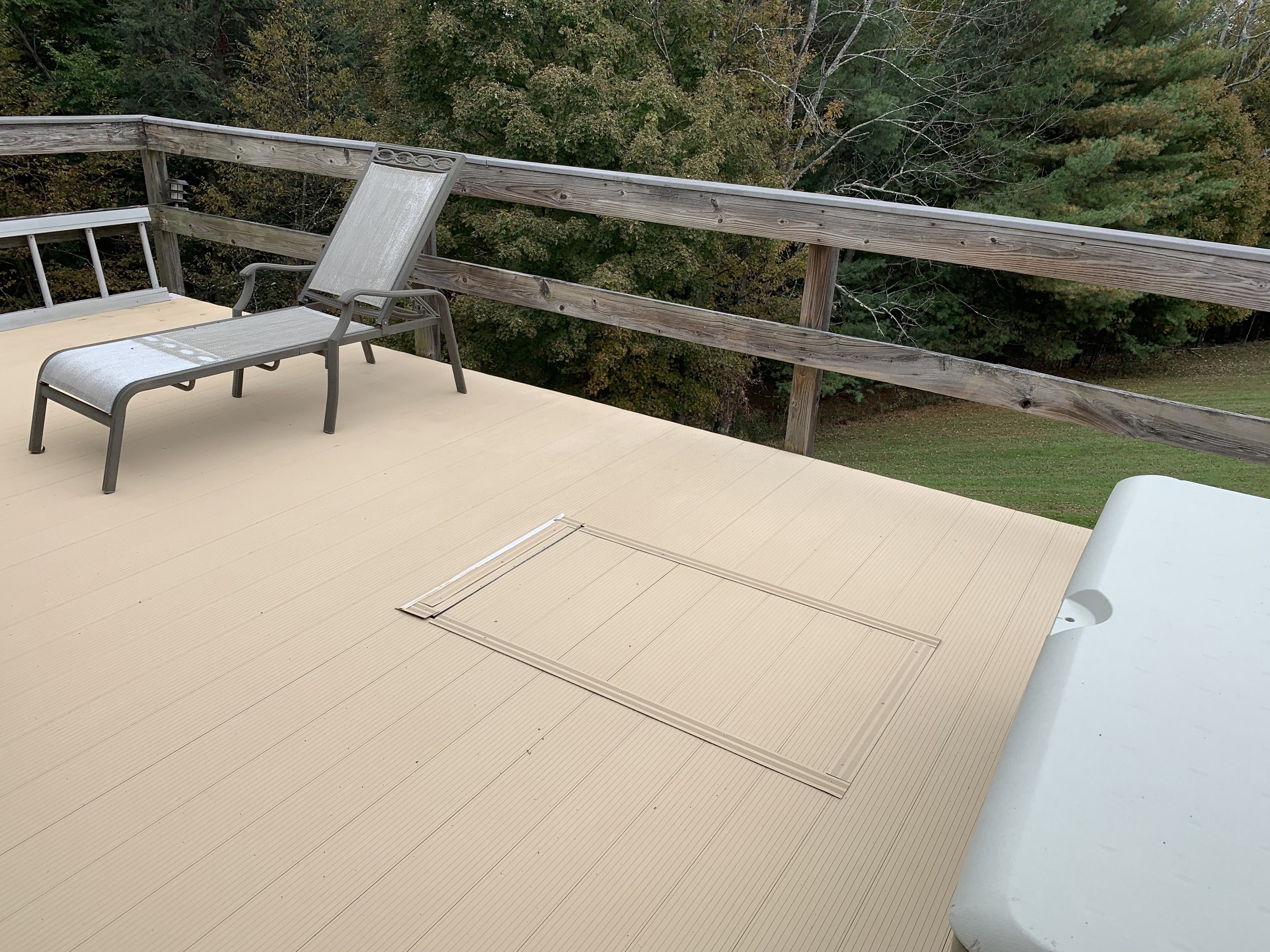

I've had to replace my treated wood decking twice in the 45 years I've owned my house. It needed replacing again 10 years ago and I decided to spend a bit more this time and use interlocking aluminum planks from Lock Dry:
It still looks like it did when I installed it a decade ago, and IMO, well worth the extra $$.
Mine is raised 12" off the ground and another advantage of the aluminum is, it's waterproof. The area under the deck stays completely dry, which protects the framing underneath.
Not a very good pic but you get the idea.
I had planned to replace the treated wood railing as well, but other projects took precedence. Maybe this year.
