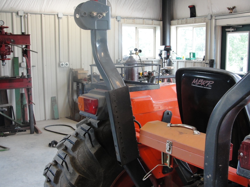

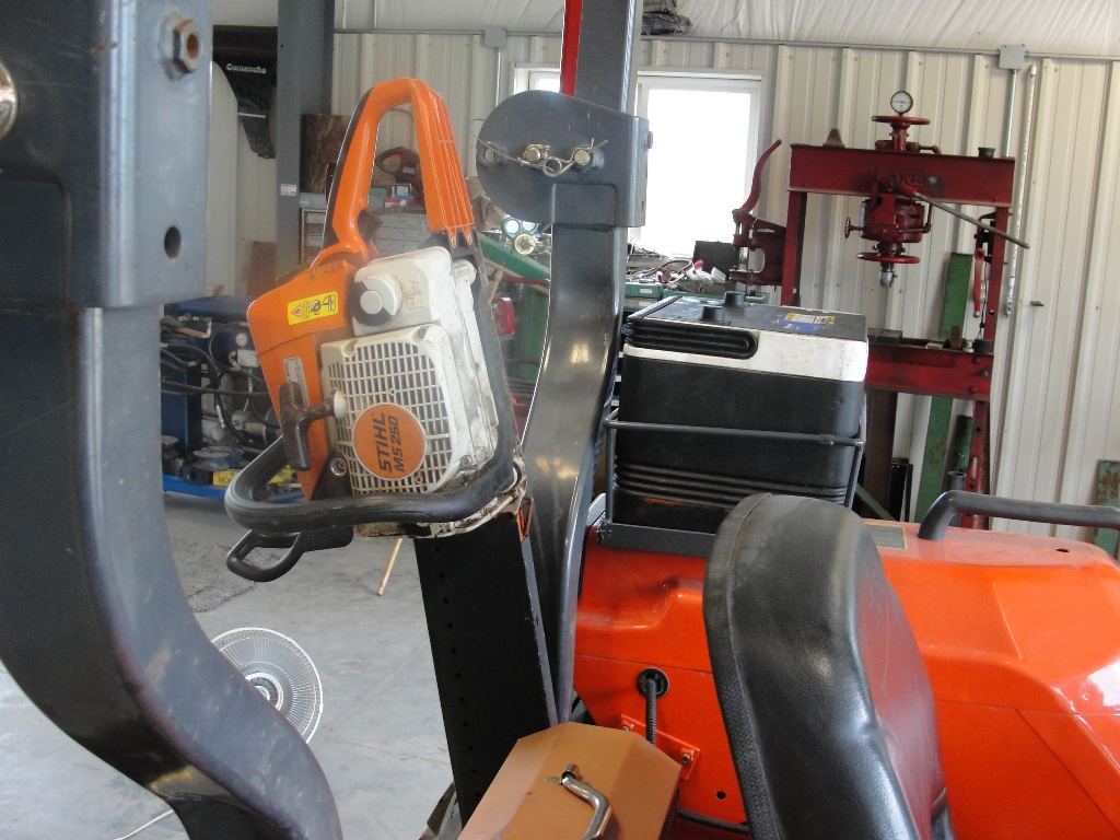

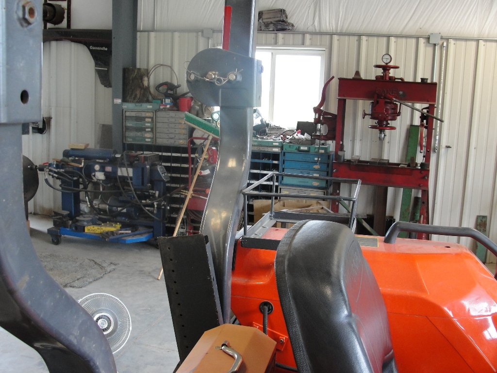

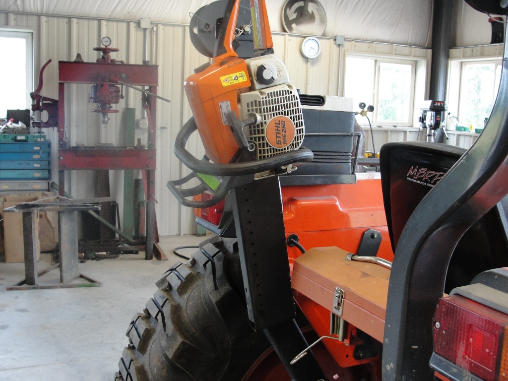

Someone commented on my saw scabbard, so I took some closeups. This one is a big improvement over the rustic wooden one I had on my old tractor. I used stainless bolts and locknuts, aluminum plate, the bar cover that came with the saw, and couple pieces of wood to box it in. I put in some 3/4 screws through the wood to keep the bar cover from sliding between the sides, because that's what it did at first. I welded a piece of plate to some 3/4" angle to support the motor end.
Also in the pictures are my winch battery (held down with an old Chevy seat belt), my toolbox, and my chain box.
