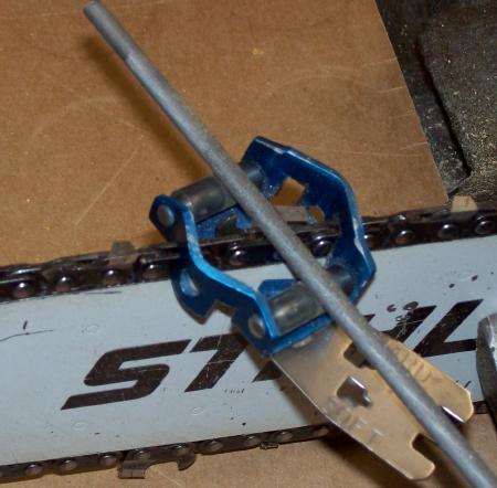

Save yourself the grief (and expense) and file by hand. By the time you spend setting up a chain grinder to do a good job (much harder to do with the HF or the NT chinese knock-offs), you will have chewed up a lot of good chainsaw teeth in the process.
A stroke or two with a good file and some of the simple jigs to either hold or guide the file are easy to master and will maintain a sharp chain better than any grinder. IMO :)
Here is the jig I use that is simple, cheap, and works the best of the many that I've used over the past 40+ years. Made by Pferd, and sold through Husqavarna
