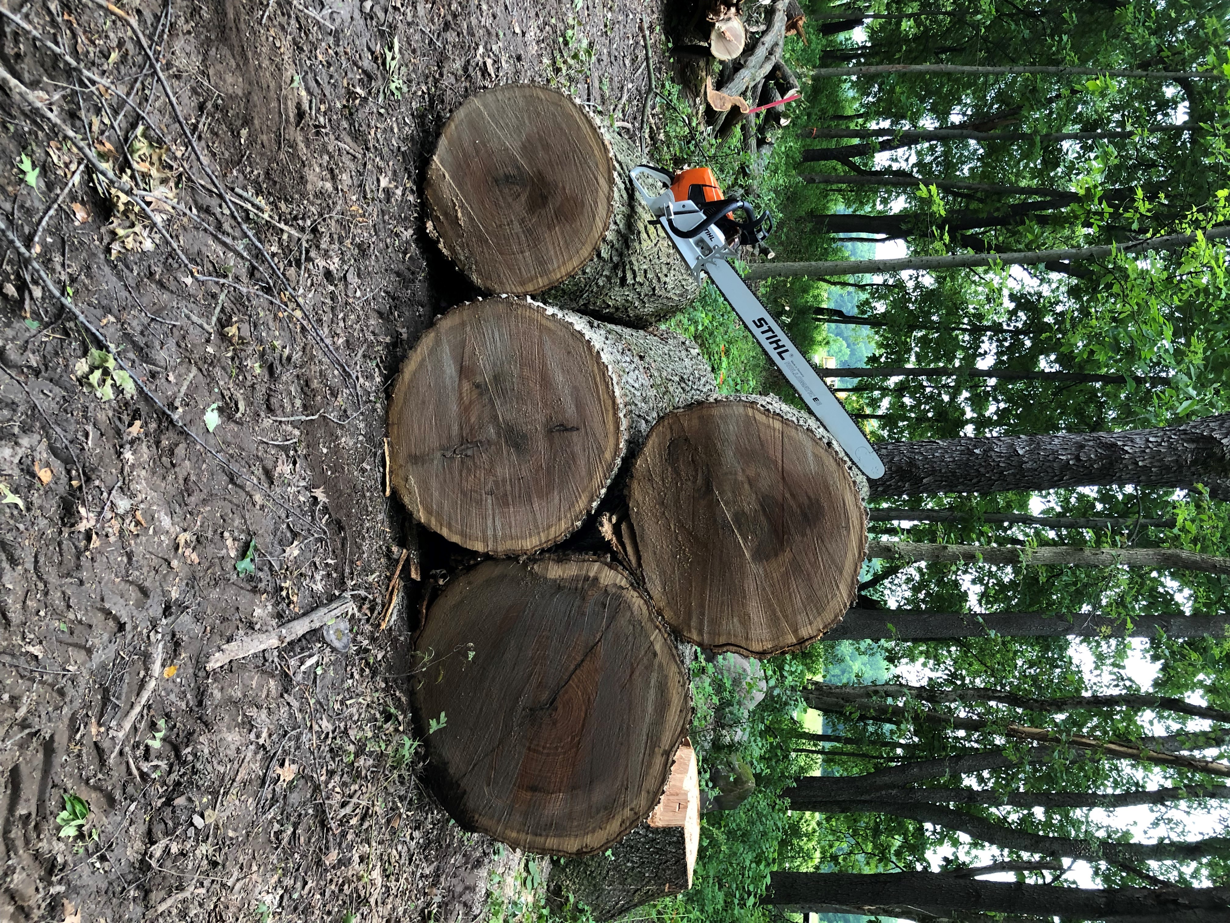

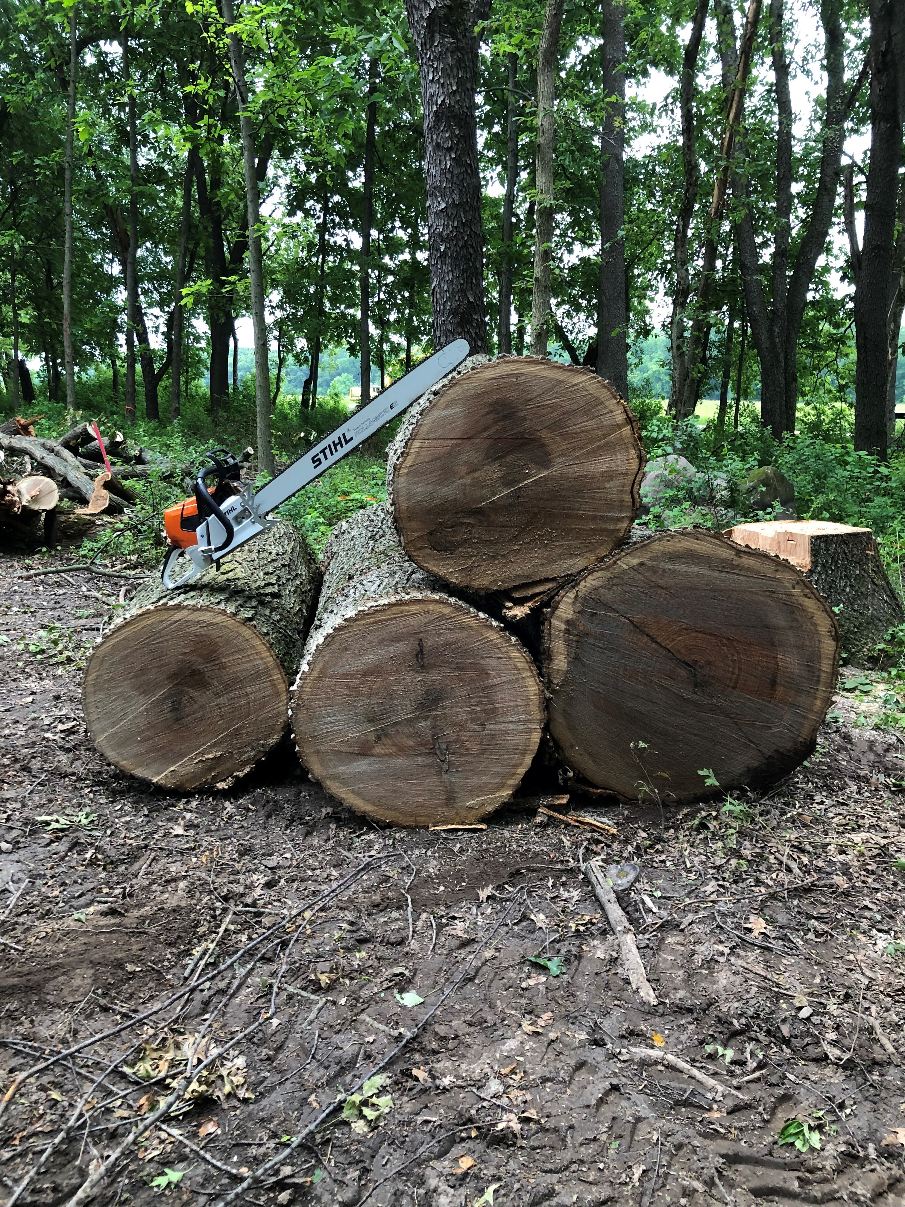

My saws and installed bar length
MS201T - 12
MS261 - 16
MS462 - 20
MS660 - 25
The only saw I swap longer bars on is the 660. The other saws started off longer when I bought them but I have settled on what I listed. If I need a longer bar I go with the bigger saw. The 462 can pull the 25 it came with but the 660 does it faster and with less effort
660 with 36" bar

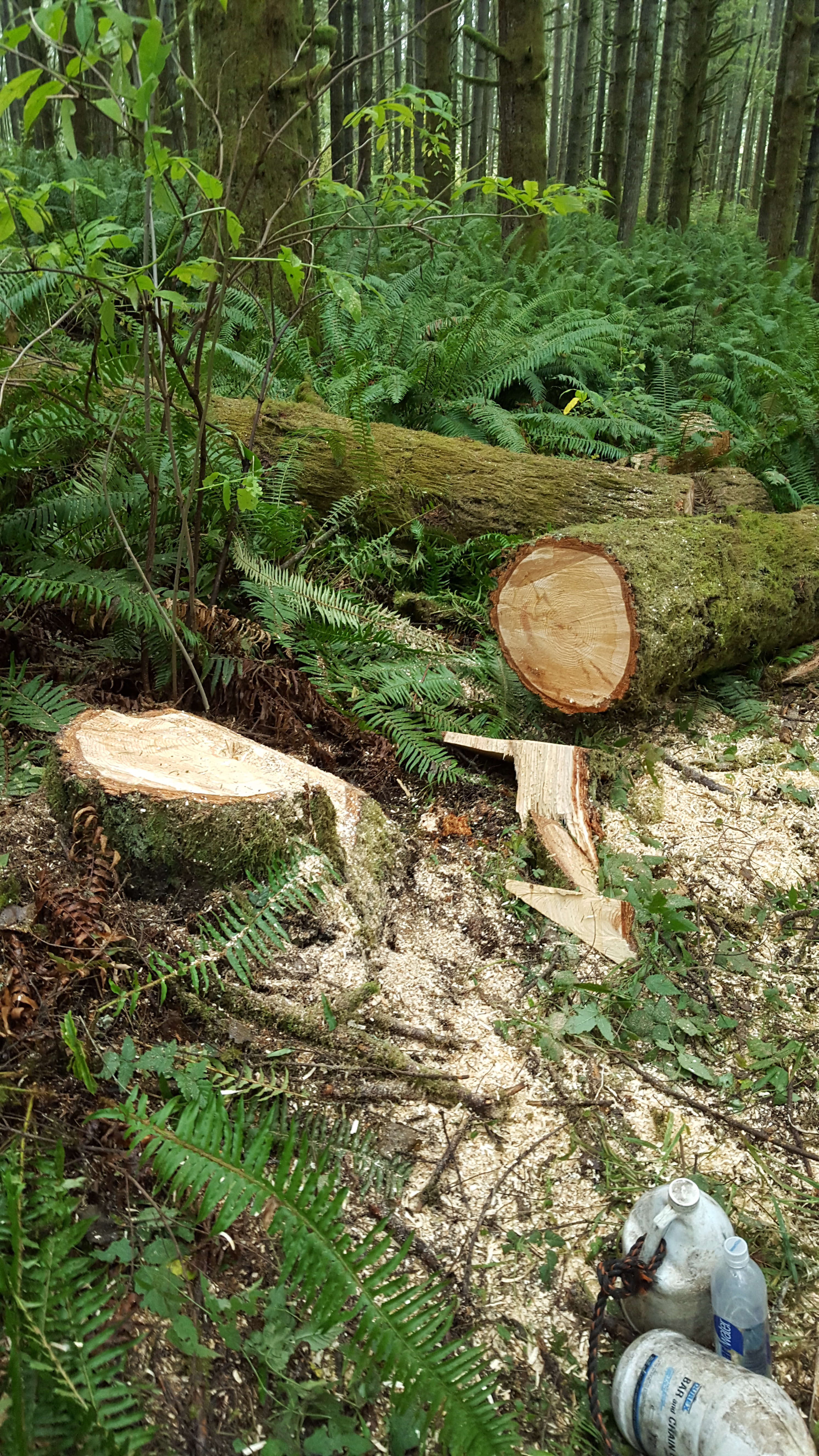

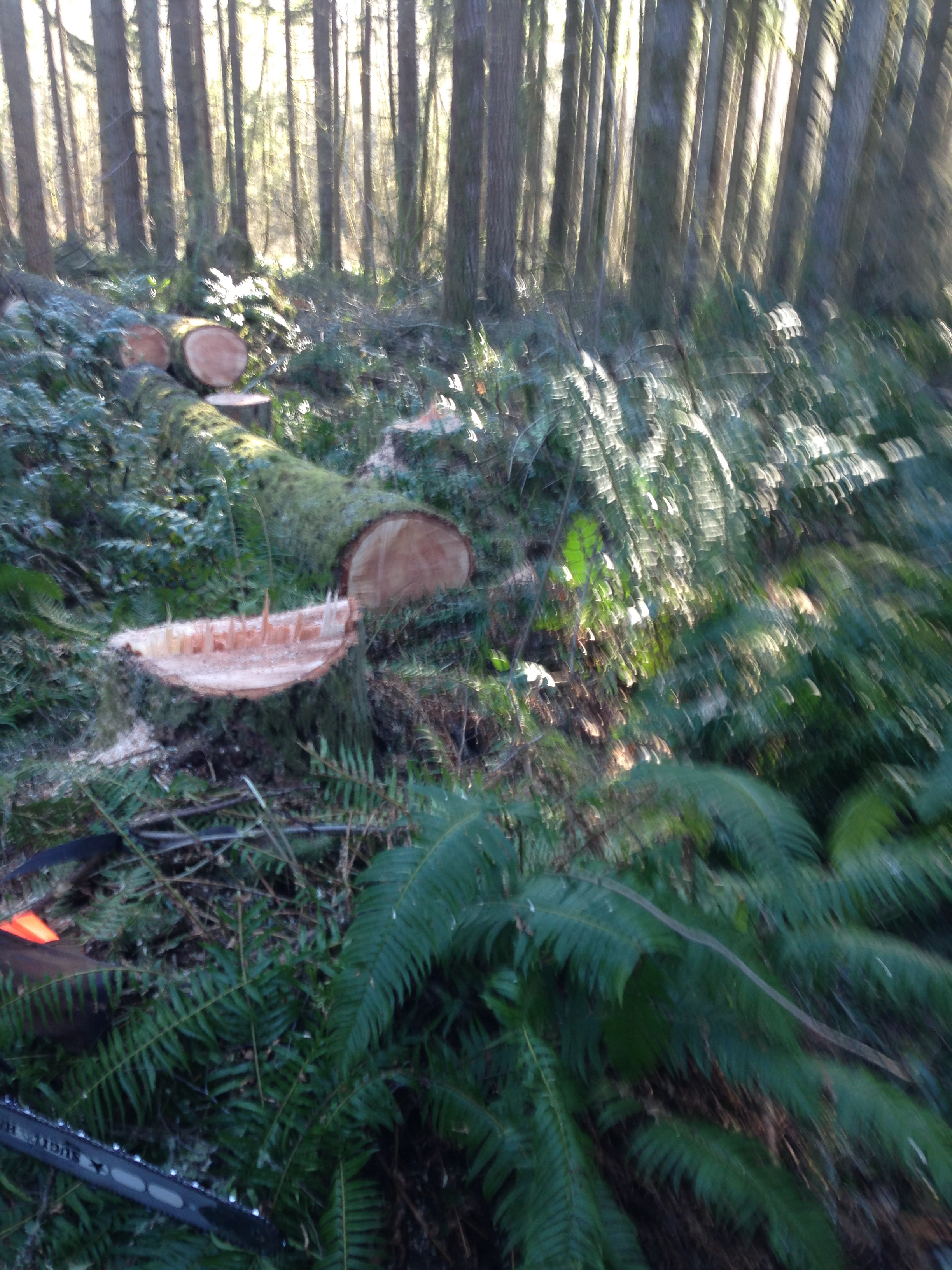

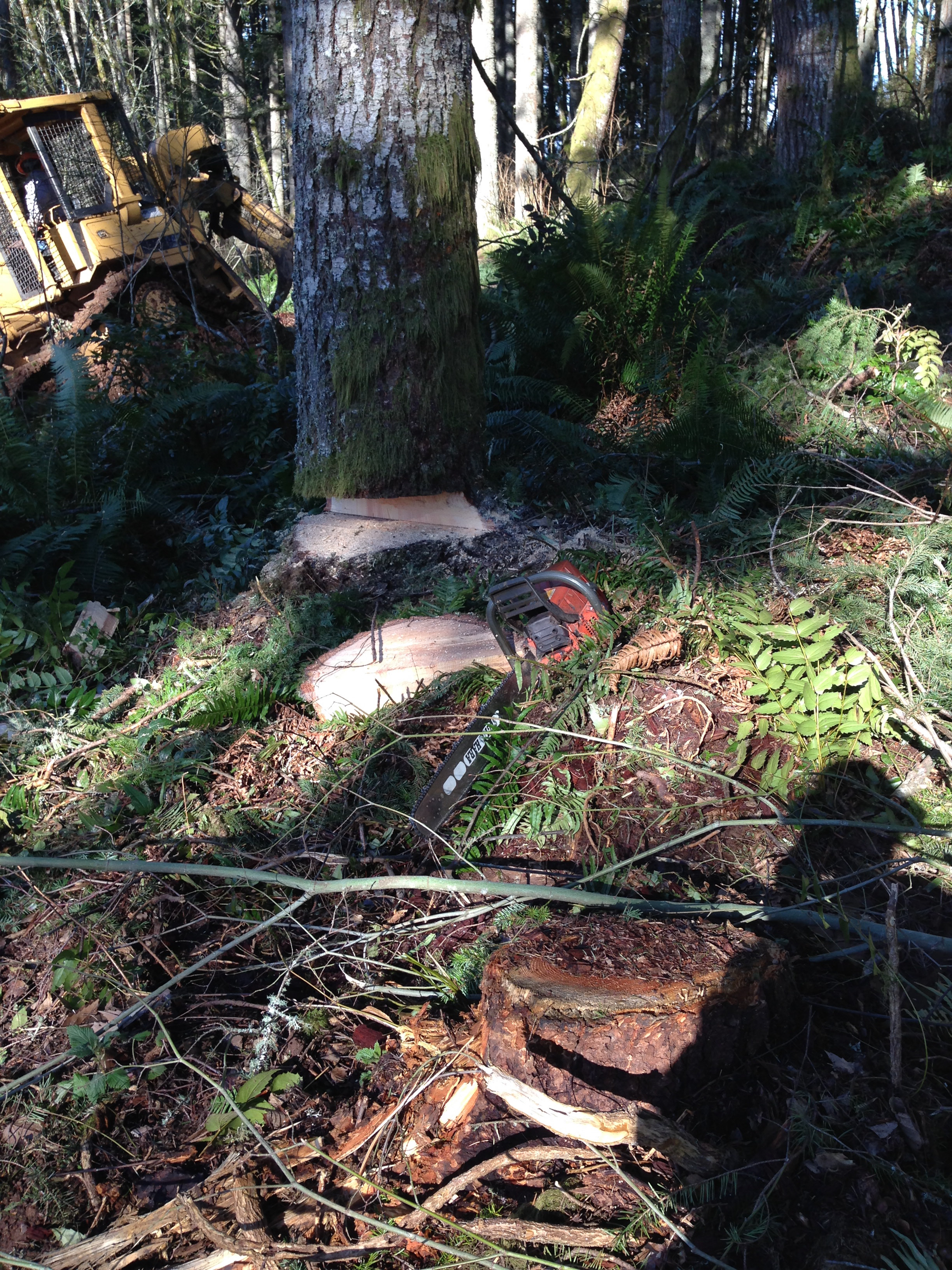

Just throw these out here have you ever seen faces like this?
