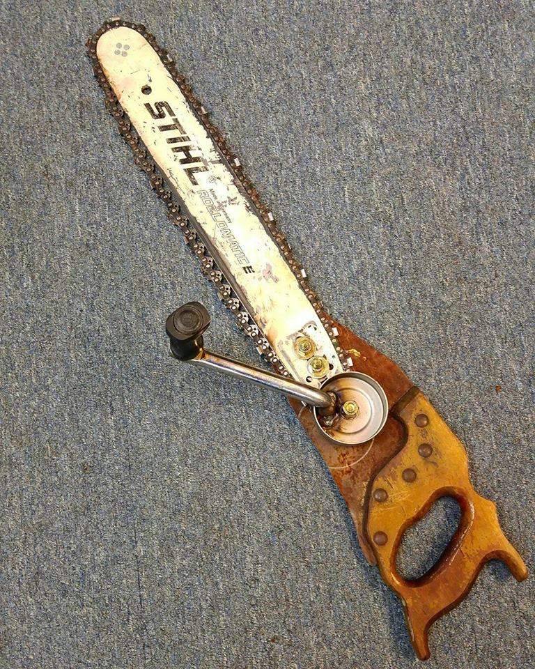

Fix it yourself, pitch it or you can go this route...47577078_2007715662647853_8121979844763320320_n.jpg
Amish chainsaw.
/ Chainsaw with scored piston. How? #38
Fix it yourself, pitch it or you can go this route...View attachment 581835
Amish chainsaw.
Oh boy a commercial break while we wait to see what saw the OP gets. Is that for $19.99 as seen on TV.............Looks like a 2 person saw, I'll hold the handle, wonder how many blonds it would take to run it.
