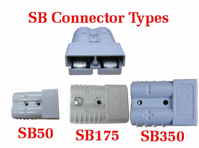

I am concerned about the extended use part because as mention by others these "cheap" winches are slow, my trailer is 30ft my new alternator is 136amp and specs say the winch will draw 340amps on a 10000# single line pull@ 3ft/min. the blue tops mca is 870 and the rc is 120 i guess that would make up the difference.
These are the connectors i want to use in a 350amp model

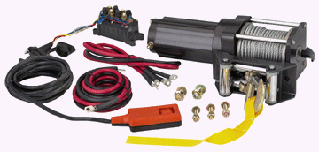

I had the same needs and I put a 3,000# winch on my trailer a few years ago. I use a snatch block and about 50' of cable but it has pulled a Suburban up. Remember that the winch rating is dead pull, not rolling pull. Also remeber that when it hits the ramps it put a strain on things but mine has pulled about 10 cars and tractors up in the last 4 years with zero issues. Most were Cavalier size and the tractors were 8N sized but did it fine for $100. It will single line pull a 8N up or a small car like a Cavalier.
Harbor Freight Tools - Quality Tools at the Lowest Prices
Chris
