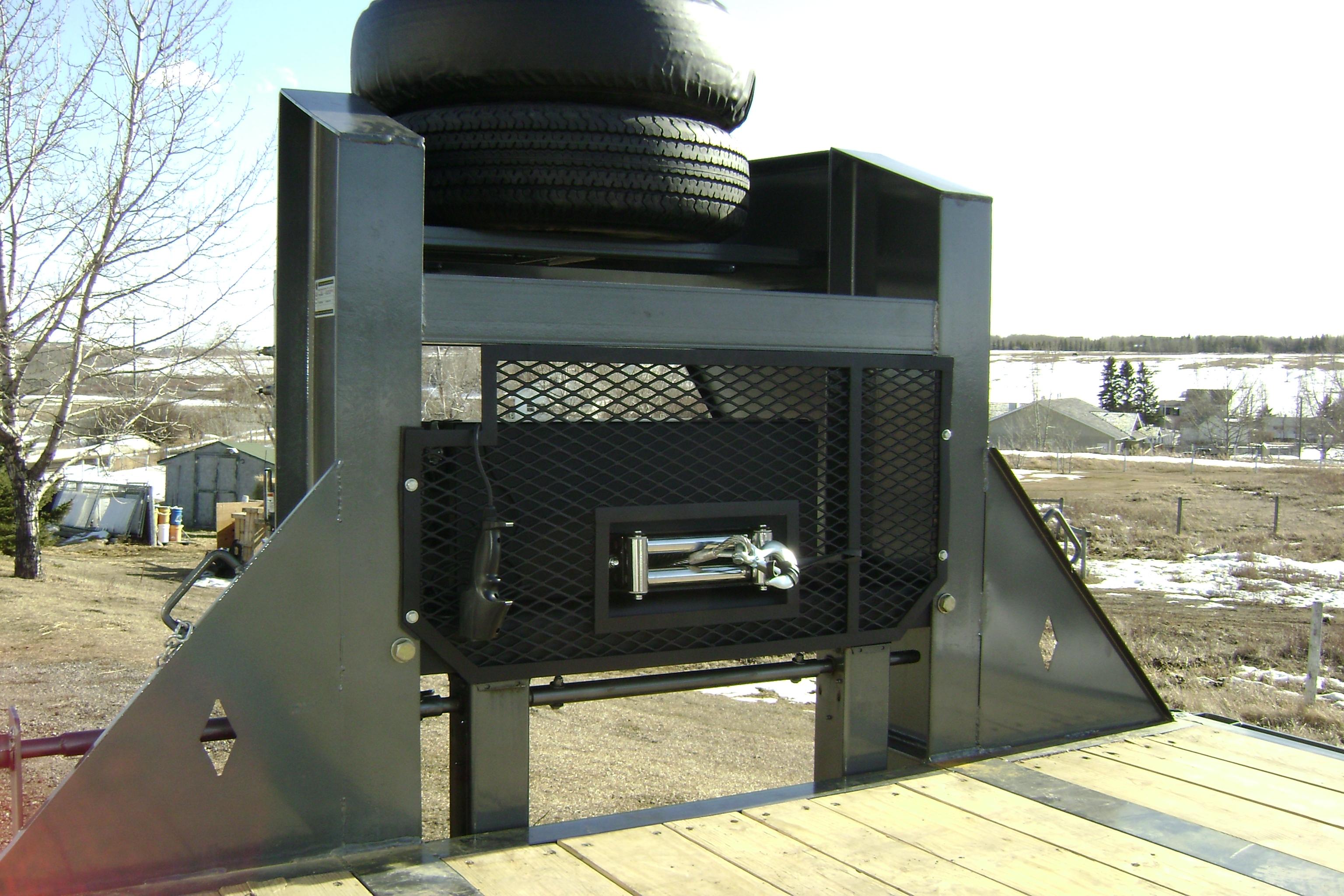

Am I glad this is over. I think I have more hours moving this project out of my way in the garage, then I spent building it.
I finally finished my winch mount and box. I didnt think things thru on my first attempt at the hinges, so thats why the steel strip is on the front ( to cover up my mess:eek:) But it should be very durable.
I used a chunk of framerail from a freightliner for the mount, and all the tin was salvaged from my old stove/oven.
I still cant bring myself to spend the $'s on wiring for this thing, I also need new welding cables so im waiting for that perfect bulk deal.

That looks real good.
I had the winch mount added when they built my trailer, but the cover & guard is a great addition. I think I'll have to copy that.;)

Thanks Firedog, Feel free to copy.
Its really snowing now so I get to test the weatherproofness of it today
I salvaged the grating from what looked to be doors from a crushed propane tank cage.
