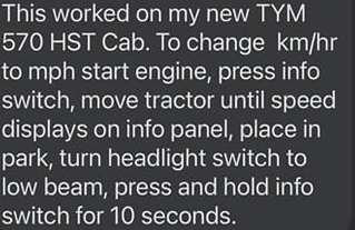

Try this.
   / Change engine temp on cluster from Celsius to Fahrenheit?
#16
Worked like a charm! TractorTYMe to the rescue again(y)
   / Change engine temp on cluster from Celsius to Fahrenheit? #17
Change temp from C to F or the opposite.
1-Turn ignition on, wait a few seconds.
2-Depress then release Info button so dash reveals voltage & temperature.
3-Turn headlights on bright.
4-Depress & continue holding Info button approximately 15 seconds or until temp changes from Celius to Farenheit or vice versa.
5-Done.
I have the same machine, mine happens to be 2020 model but this solution did not work for me. Followed instructions to the letter, dunno.
