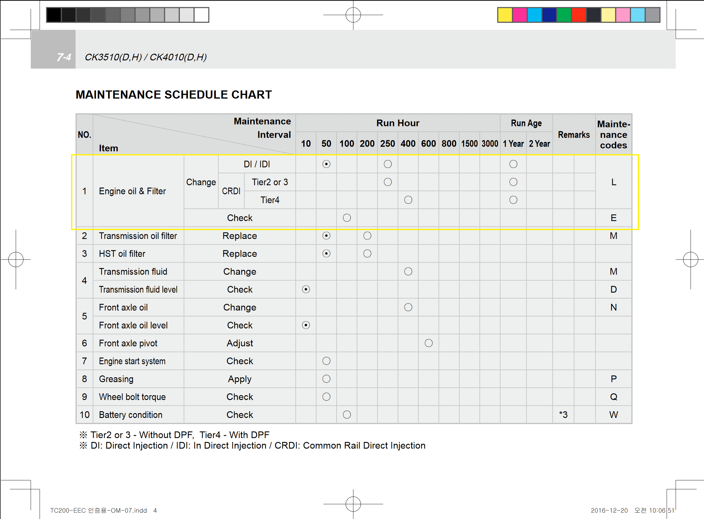

Huh? Again, who says it is not safe? These are things you "think." I am saying manufacturers "know" such things by studying and testing. If they didn't want oil to go several or many years without being changed, don't you think they would say that in the manuual?
   / Change oil every year or at the recommended 300 hours #13
But they do.. Every manual I have seen says to check daily/some hour interval and replace at some hour interval or yearly otherwise.
Current Kioti is no exception. Tier 4 is check every 100, replace at 400 or yearly.
OK, if that is true we are just talking past each other and saying the same thing. The OP did not mention any such chronlogic statement being in his manual. And that is why i brought it up. 👍
