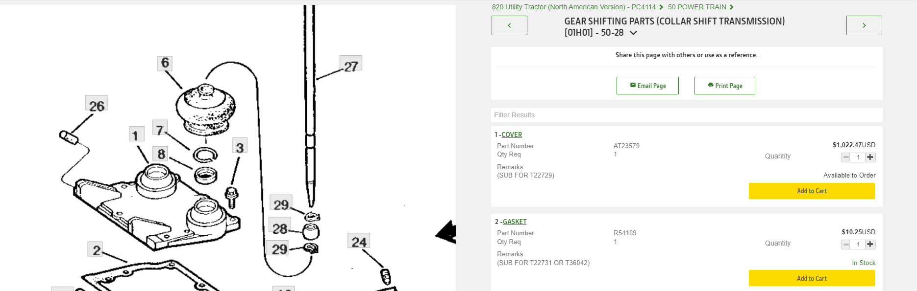

If gearshift lever knobs won't come off of lever your next option is remove retaining ring(item 7) & pull lever out of shift cover then install boot.

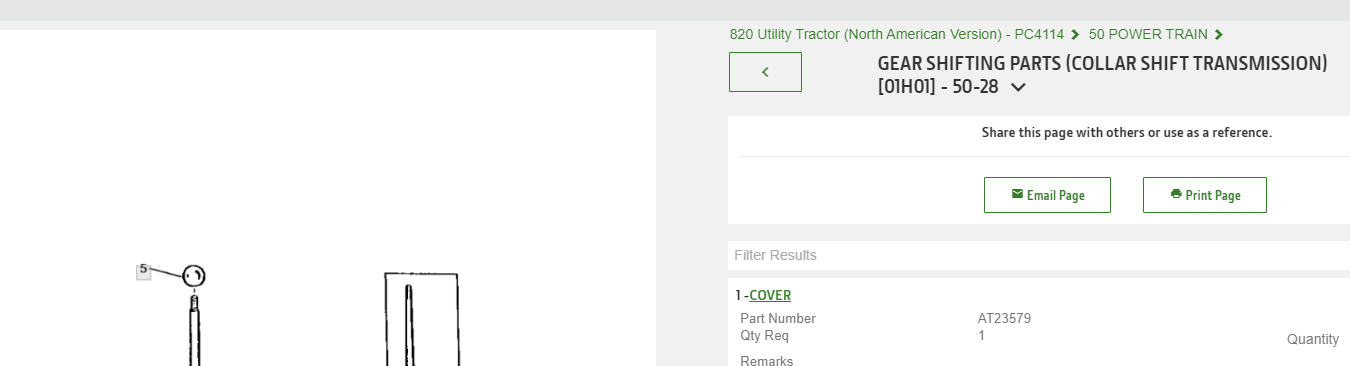

   / Change shifter boots on 1970 820 3 cyl #7
If they are, most likely there will be a jam nut under it.
No jam nut listed for shifter in JD 820 utility tractor parts catalog.

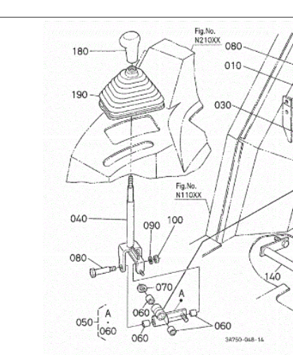

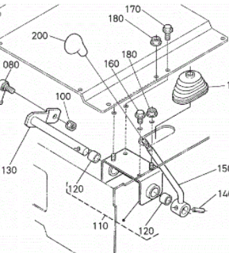

So, there is no depiction of the shift pattern like my Kubota's have on them then? Mine screw on and a thin jam nut secures them in the correct orientation.
   / Change shifter boots on 1970 820 3 cyl #9
That's odd your M9000 gearshift knob has a thin locknut under the knob as no locknut is listed in M9000 parts catalog under either gearshift knob.
   / Change shifter boots on 1970 820 3 cyl #10
Both of them came that way, if in the parts breakdown or not is irrevelant.
