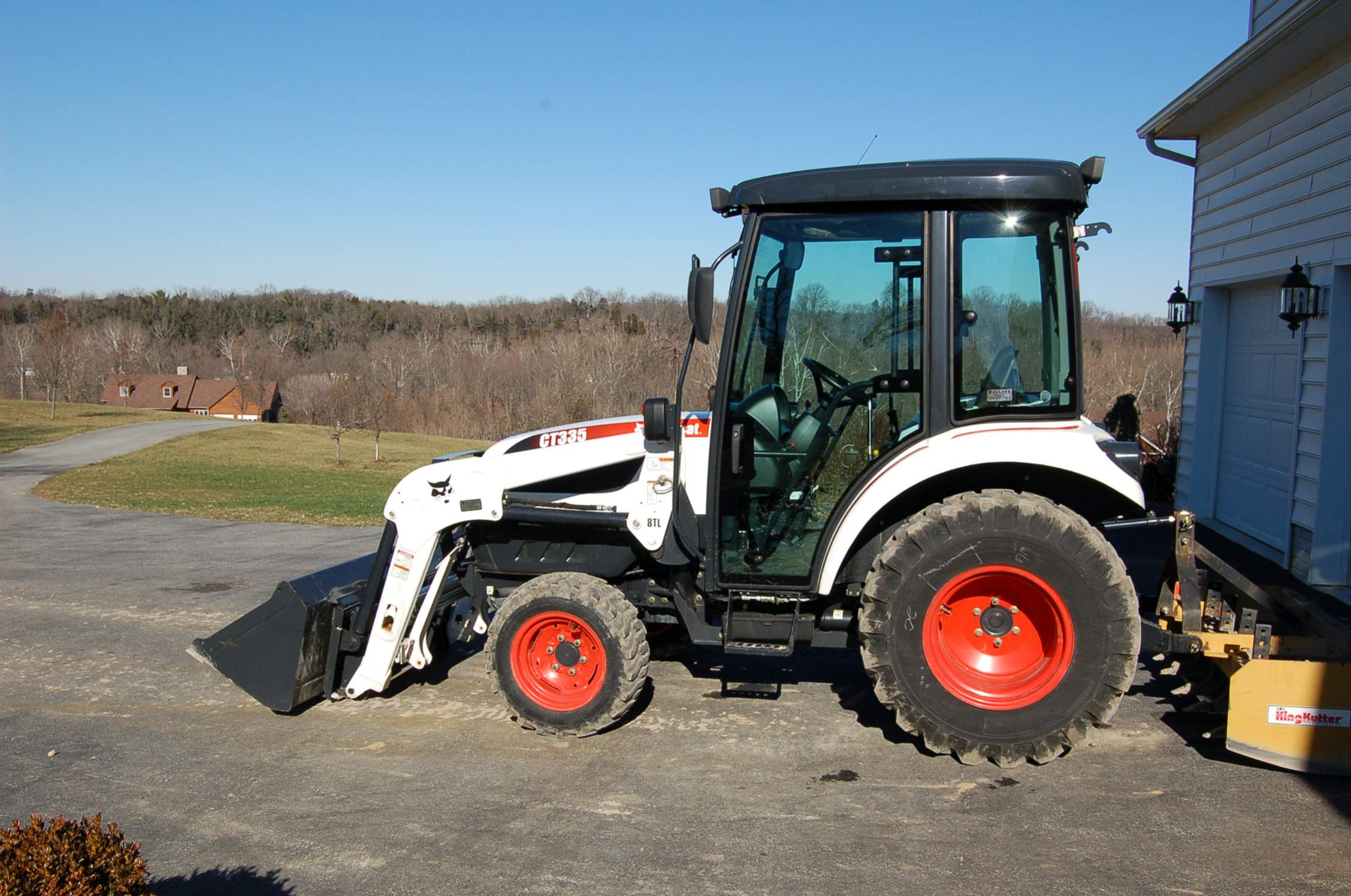

To the O/P that is a great looking tractor and I am sure you will enjoy it. Mine is a 12 and I have had it less than a year and I am over 200 hours. CJ

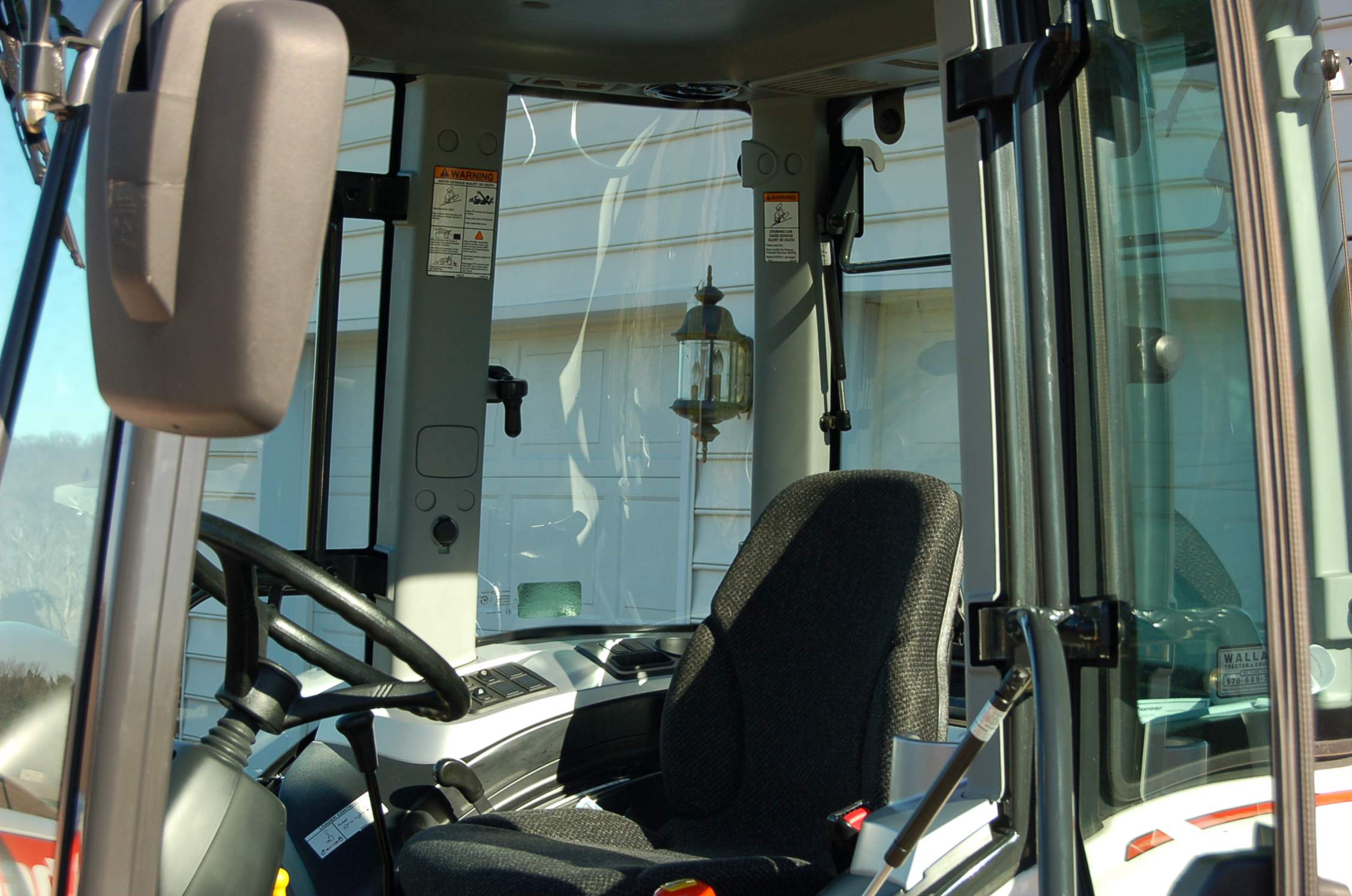

Maybe it just me being a little (well a lot ) deaf, but I dont find my machines to be noisy enough to require ear plugs or head gear even on my Kubota RTV 900 which folks complain about being noisy. I dont see it. MY B26 has a loud transmission whine but not so loud that I would need to were hearing protection. And inside the cab on my LS it is super quiet. Sure I can hear the engine noise but it isnt loud and the vertical exhaust it at the top of the cab, but who wants to be totally isolated from any sound. One needs to hear the machinery "talking " to you when in operation so you can tell when something changes for the worse.
As for additional sound proofing, maybe some deadening under the cab mounting brackets or under the floor might help if you think the noise is too loud, but that would be about it. Most of the sound is going to be transmitted thru the glass which it 66% of the cab (all except for top and floor is glass).

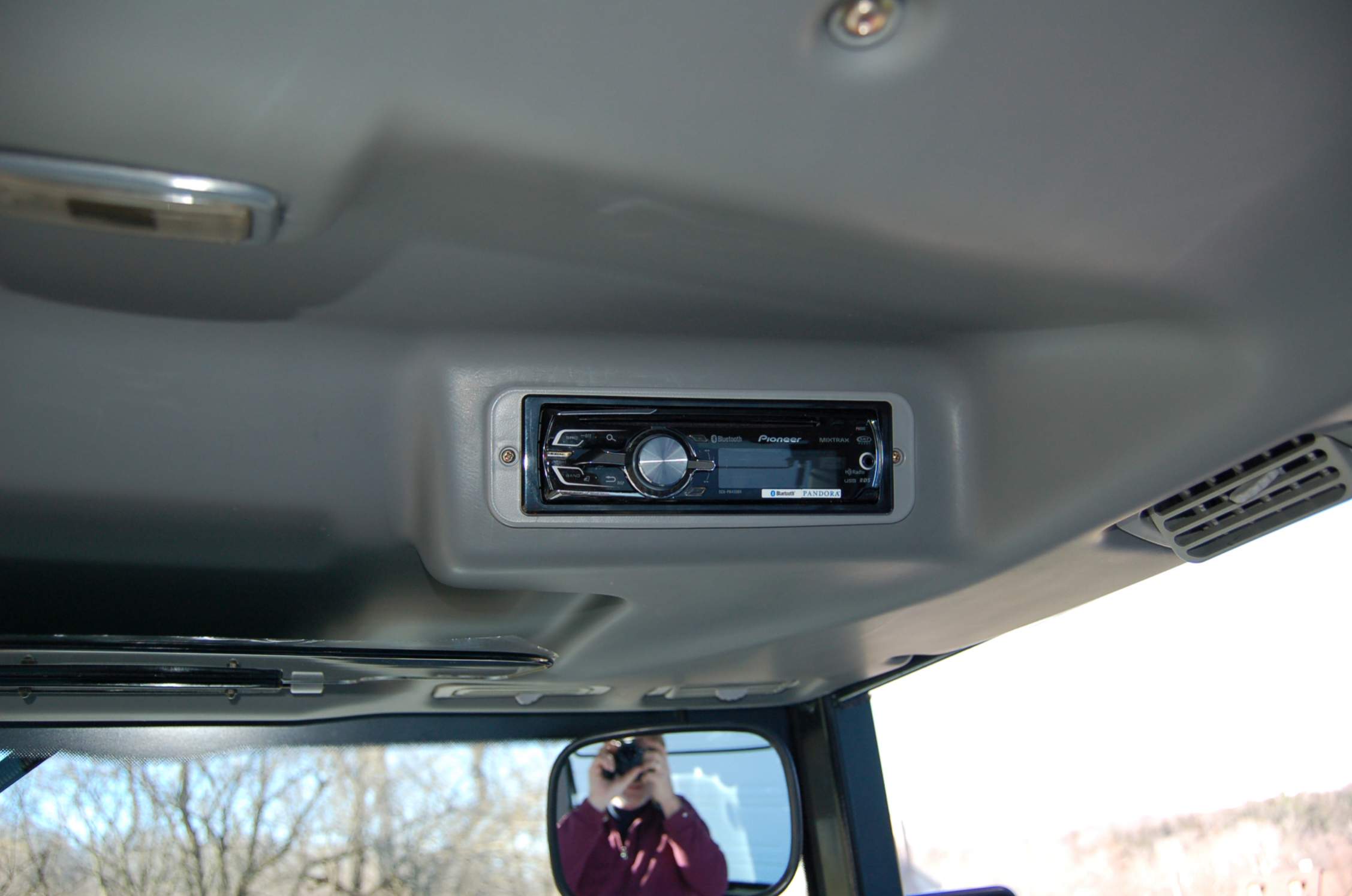

If I wanted to further reduce cab noise, I would put a thick foam rubber floor mat in like the kind you put down to stand on around a work station. It think it would help in blocking any transmitted noise from the engine and frame a bit but that is about the only place you could do anything. I dont think you could achieve much from the top as it has a bunch of control cable etc under that that you couldnt do much anyway and most sound is not going to come radiating from the top. Only sound coming from below would hit the top and echo back, eliminate the floor noise and nothing would be bouncing downward anyway. My cab has a thick foam pad over my head so not much noise coming thu that except for the stereo speakers when I happen to turn on the radio.
If I ever get industrious, I may buy some of those interlocking foam pads and take out the rubber mat, use it as a pattern and cut out a total foam insert, then put my rubber pad back on top. There is some opening around the brakes and clutch that might could be closed up a bit for dust control.
Gary I agree 100% with you, even the deaf part. Grinders,impacts and loud engines have done me in. The biggest help would be sound absorbsion in the cab but I have not figured out how to do it and look good. I am going to put dynamat in the head liner and insulate between the engine/cab. My tractor has a nice rubber pad under the floormat so I will throw some dynamat on the bottom of the floor also. Well see when summer gets here. CJ

I don't find the cab that loud, but I don't have anything to compare except OS. I think your idea regarding dynamat is a good one and would cut down on some noise. I do agree w/ Gary...the cab's mostly glass and that in itself is where the majority of noise is coming from. How about putting dynamat on top of transmission cover (on sides of seat bottom)?

The Dynamat works great for blocking the noise but I need to find something that will absorb it better. In big equipment the headliners are either felt like material or are perferated to absorb sound. If the tractor would fit in my garage I would start now but I'll wait till spring. The nice big heated cab has turned me in to a wimp. I am so used to blowing snow on a open tractor, I still put on a hat gloves and coat. And that usually is off in about 15 min. CJ

Yes, something like the egg-crate foam would work albeit it's not very appealing.
